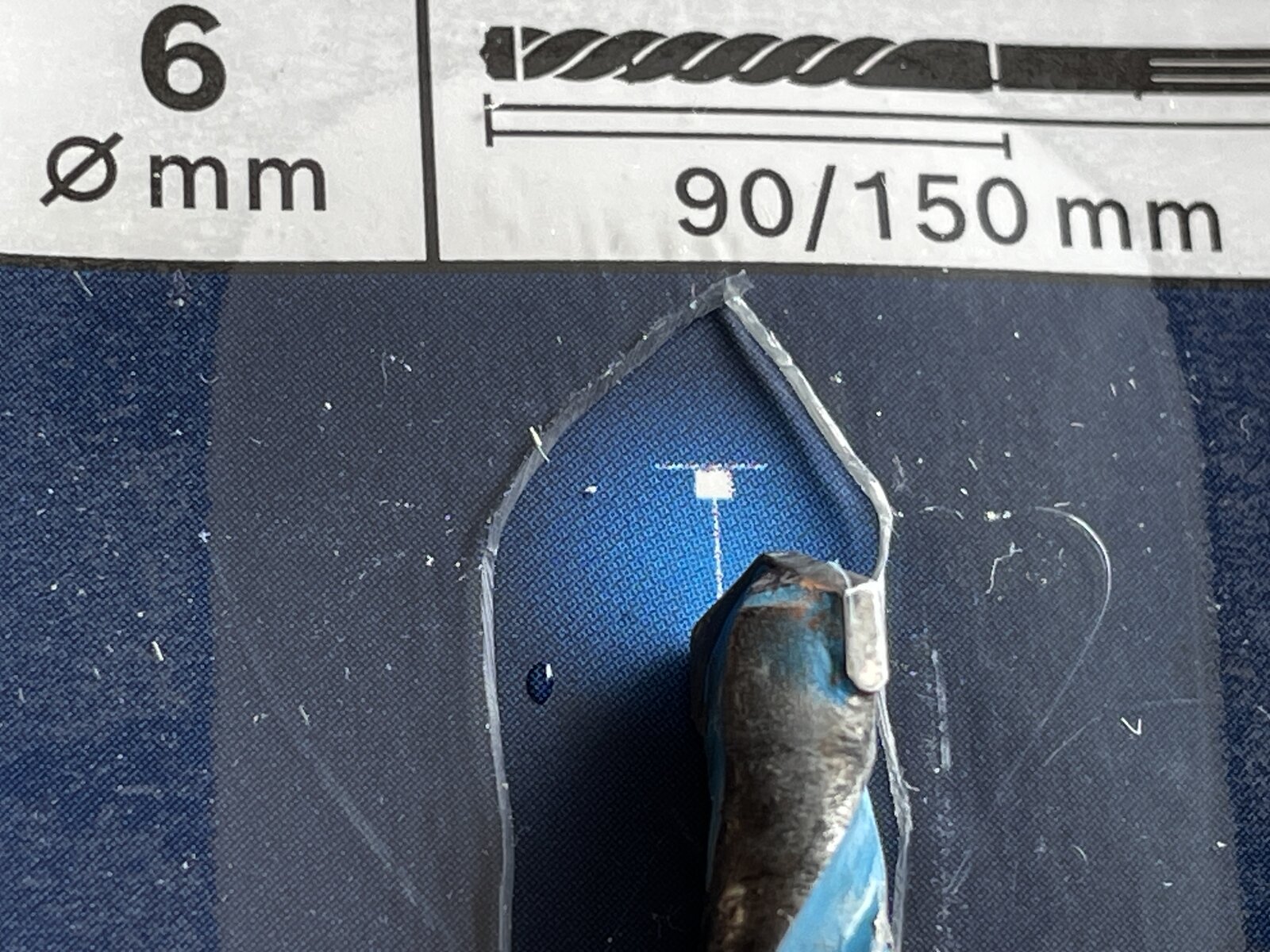

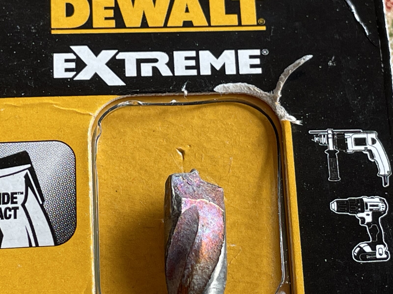

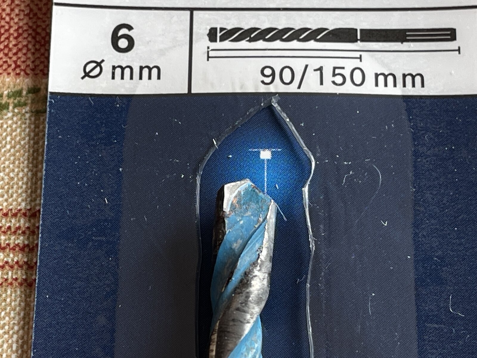

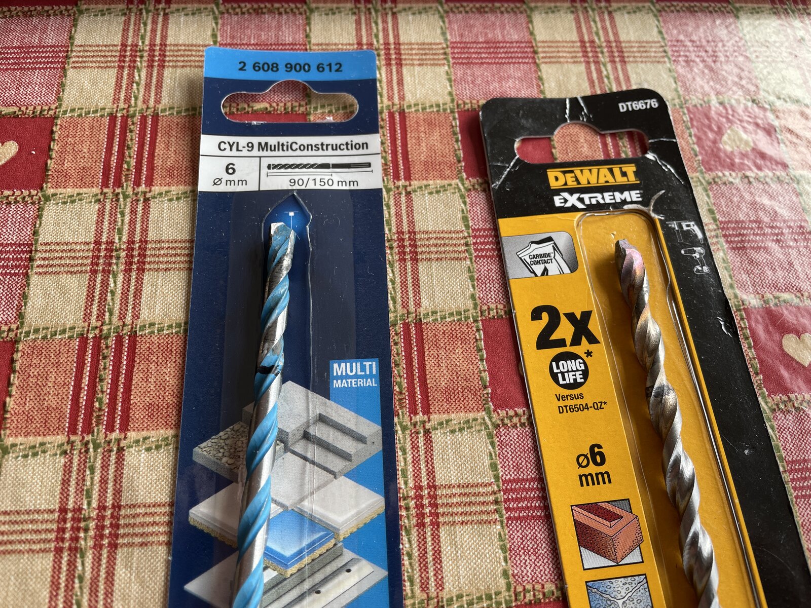

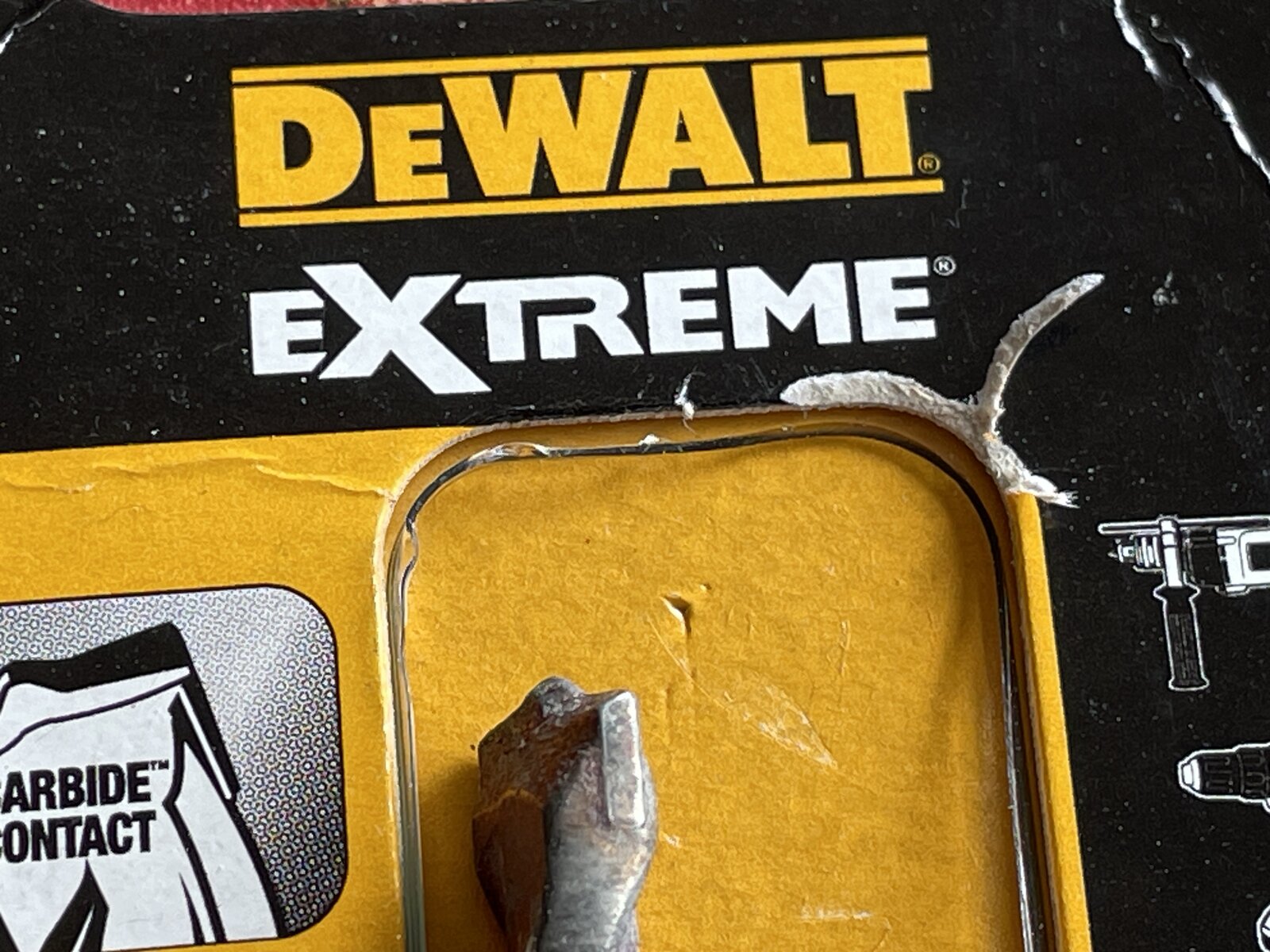

Okay so the results are in...
I had four and a half holes (6mm dia and 30mm deep) to drill.
Not impressed with either bit to be honest. If anything, the Bosch CYL-9 just edges it.
If it was a school report for the CYL-9 it would say: "After an impressive start to the term, they quickly went 'off the boil' and struggled to show their true potential."
For the DeWalt Extreme 2 it would say: "Disappointing on the whole and didn't really live up to expectations."
A brand-new CYL-9 made short work of the first hole - and I was impressed. It struggled to make an impression on the second hole. I switched to the DeWalt and started a third hole (in order to be fair). It struggled from the off - certainly not as good as the CYL-9 bit.
Swapping between these two bits (and quenching them in cold water after about 15-20 sec of hard hammer drilling), I managed to complete three holes fairly quickly in one lintel.
I went back to the half-hole in the first lintel and both bits really struggled to complete this hole.
I started drilling the last hole with the DeWalt bit and it initially seemed to make good progress, then I was swimming through treacle again - I have no idea what these concrete lintels are made out of, but boy oh boy is it REALLY HARD stuff!!
Both drill bits now look decidedly second-hand after onlt 4 and a half holes between them! The Bosch CYL-9 look somewhat better than the DeWalt which, despite only using it for 15-20 sec at a time and quenching, shows witness marks of heat stress. Surely somebody makes a drill bit that would work in this lintel?!
Both bits:

Bosch CYL-9
and
DeWalt Extreme
and
