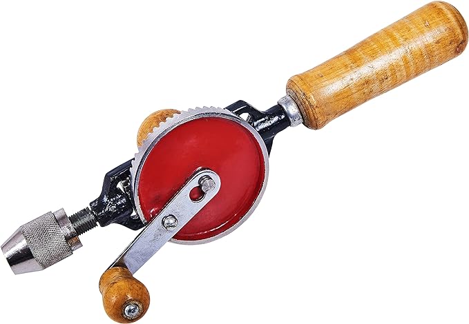

If you lived in a new build, you wouldn't need any of those fancy drill bits or drills, there's not a single drilling job you couldn't do internally or externally with just one of these:
Cheese houses. I should know, I'm unfortunate enough to live in one - hopefully moving very soon!
