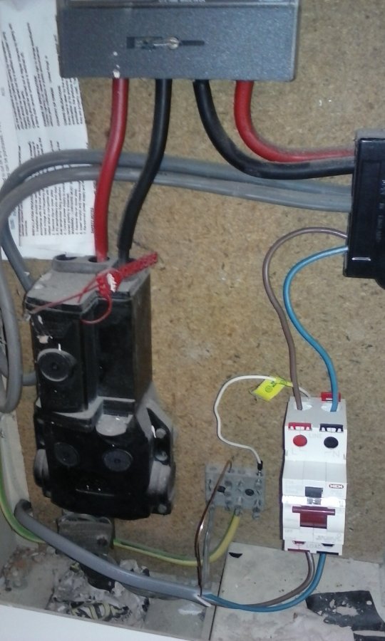

Here's one I found five years ago:
20161115_141736-jpg.108694
Sorry the RCD is glared out, it's 25A 30mA.
RCBO's invariably have the earth wire too.
Well, some RCBOs have a functional earth connection but only for ensuring they can work in certain conditions - if the supply neutral is lost I think; may be wrong.
Indeed - but am I right in my impression that this 'craze' may be on the decline? I never really understood why some manufacturers decided that a 'functional earth' was necessary (to ensure enough voltage was available to run the device's electronics in the sort of situation you mention), yet continued to manufacture and sell RCDs which were presumably just as depended on an adequate L-N PD for their electronics to function! In terms of RCBOs, I think that at least some manufacturers decided (presumably without consulting bernard :) ) that the probability of a fault requiring a 'residual current trip' arising at the very time when a TN-C-S installation had a 'lost neutral' was 'vanishingly small'!
Some (all?) RCD sockets (FCUs?) won't switch on without the earth connection connected.
Indeed, and also 'RCD adaptors' - maybe most/all active RCDs? I suppose it makes sense. If an RCD socket/adaptor is being used in a situation in which residual-current protection is considered particularly desirable, it makes sense for the device to not 'switch on' if there is not an adequate enough earth connection to enable an L-CPC fault to trip the device. We've discussed this before, and it's not at all obvious how they achieve that functionality.
Kind Regards, John
Yup, that's probably a Memera 2000 A80 or A100 with functional earth. EDIT: You already mentioned it was 25A.
MEM tech a good few years ago told me the functional earth on their RCDs also helps them detect DC fault current.
I had a raft of "faulty" RCD changes by sparks at work and sent a handful back to MEM for testing. The RCDs were testing OK on their test bench. Therefore the "faults" were put down to faulty/ leaky equipment attached to the RCD when under test.
