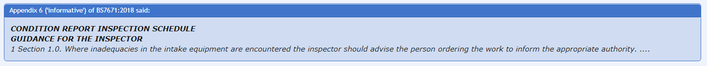

... The EICR was a "fail" with a number of C2 codes. ...
1. Missing seal on the supplier fuse.
2. Missing cover from PEN connector block.
Returning (after 6 pages of spin-off discussions!) to the original post by @DIYinBerks , at the time several of us commented that these issus related to DNO equipment should not have been mentioned, and certainly probably not 'coded' on an EICR (and, in any even, probably would not warrant C2s even if they were coded!).
I have just stumbled across this in the ('informative') guidance in Appendix 6 of BS7671 (one of the few places in BS7671 where it says anything much about EICRs, although it never calls them that {other than as titles of forms}, anyway!) ...
Appendix 6 ('informative') of BS7671:2018 said:
CONDITION REPORT INSPECTION SCHEDULE
GUIDANCE FOR THE INSPECTOR
1 Section 1.0. Where inadequacies in the intake equipment are encountered the inspector should advise the person ordering the work to inform the appropriate authority. ....
So, that seems to be agreeing that such things should not be 'coded' on an EICR but that 'the person ordering the EICR' should be 'advised to inform the appropriate authority' (i.e. the DNO).
Kind Regards, John
Kind Regards, John
