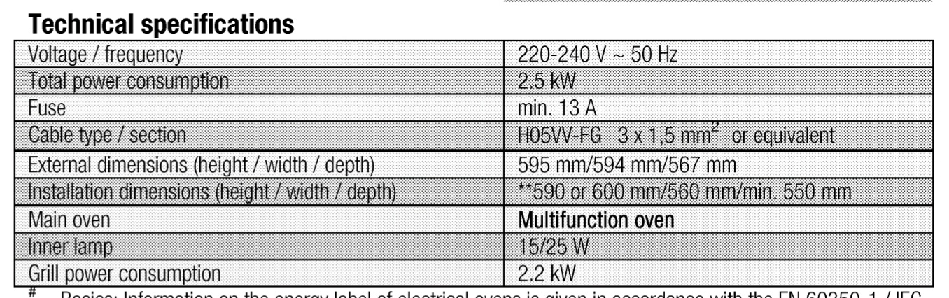

However be aware with all advice that has been given that manufacturers instructions may specify a maximum fuseor MCB rating due to the size of the appliances wiring.
Although it may not apply to you if they have been there 7 years I have known refusal to honour a warranty when overload damage has occurred.
Agreed, but interestingly in this case...
(Despite the usual contradictions throughout the MI), they mightn't be able to argue, when the fuse value is stated as "min. 13A". :)
Is that the reason?
Do cookers have larger wire sizes than ovens?
