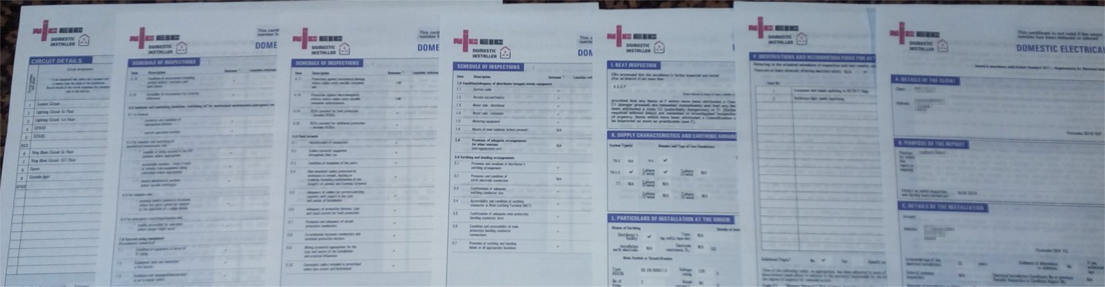

WhydidIstart: at risk of appearing to doubt you, just to be absolutely certain, can you confirm that all pages of the the EICR you have bear not only the NICEIC logo but also the adjacent "Domestic Installer" logo?
I double checked and yes they do, please see picture below. Sorry about the photo quality, but you can see the logos. I also noticed the suggested date of next inspection is "ASAP".
Thanks. I'm far from convinced that they are EICR (rather than EIC) forms - what is the title on each page (partially covered in most cases in your photo) which starts "DOMESTIC ELECTRICAL...."?

The title on each page is DOMESTIC ELECTRICAL INSTALLATION CONDITION REPORT.
Indeed, NICEIC don't seem to be very helpful but yet appear to provide the forms.
It looked like the guy had some software where he enters the values and it generates the form automatically, so maybe the vendor of this software has put that logo on the forms?

Well, your electrician clearly has found a source of these forms - but, as I've said, unless I'm missing them, they are not forms which are available for purchase on their website. Could they be 'fakes'?
I really think you should question this with NICEIC - telling them that, despite what they have said to you, you have an EICR on "NICIEC-DI-branded" EICR forms, and expressing your confusion/surprise that they should provide such forms (which are likely to mislead customers) if they do not regard their DI members as having been assessed as competent to undertake EICRs!
As far as I can make out, all the NICEIC forms seem to be 'electronic', and use NICEIC software. However, why would any software (produced by anyone) have the NICEIC DI logo on an EICR form, if NICEIC does not 'approve' DIs to undertake EICRs?
Kind Regards, John
Because people are prepated to pay for it ?
Or perhaps the vendor know nothing about the system and just does "a form" ? The latter could even be like the model forms downloadable (PDF) from the IET website - and which have been turned into forms by someone, perhaps not realising that the difference between membership type is more than just a logo change ?
Because people are prepated to pay for it ? ... Or perhaps the vendor know nothing about the system and just does "a form" ? The latter could even be like the model forms downloadable (PDF) from the IET website - and which have been turned into forms by someone, perhaps not realising that the difference between membership type is more than just a logo change ?
All possible, I suppose. I would think that's an even stronger reason for speaking to NICEIC about this, if the situation is that someone is using apparently NICEIC-branded forms which were not supplied by NICEIC and which appear to have been used for a purpose not approved/'allowed' by NICEIC.
