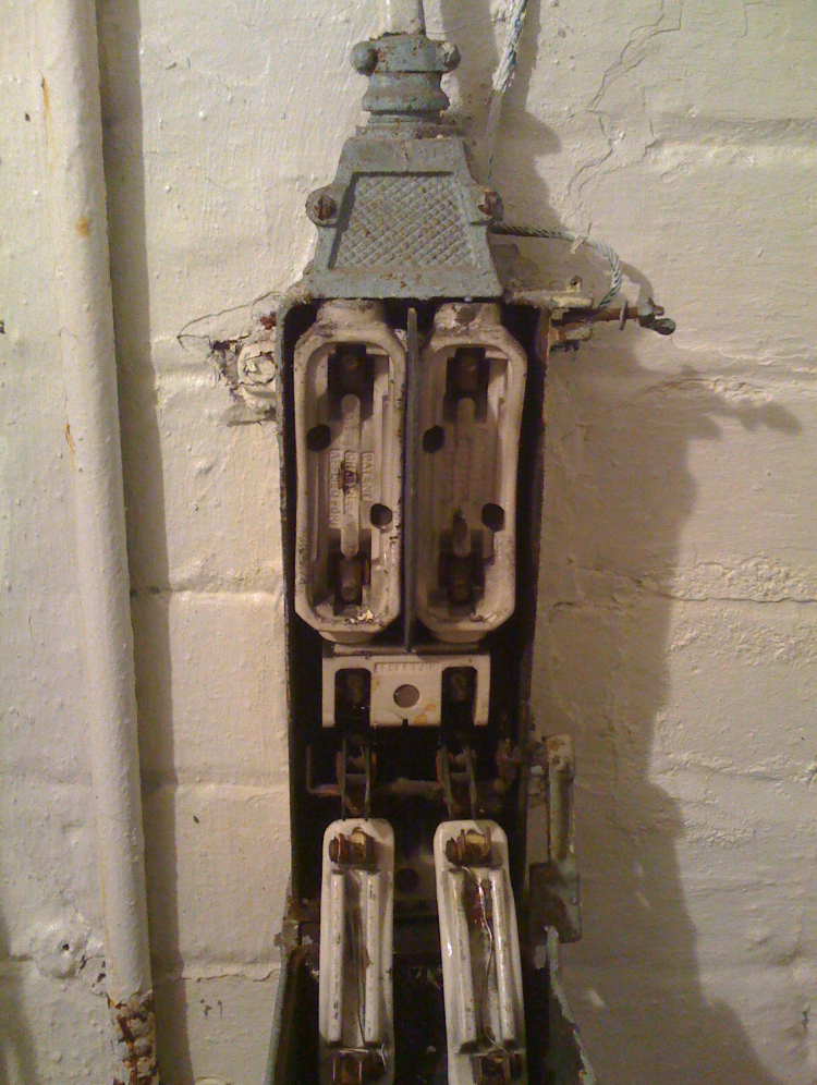

If you take in to consideration previous standards, then this which I found in a school presumably would be ok as it complied when it was installed?
Lead sheathed cable protected by single pole fuses in both the line and neutral inside an enclosure with live parts which can be accessed without the use of a tool or key.

If you take in to consideration previous standards, then this which I found in a school presumably would be ok as it complied when it was installed?....
This has never complied with BS7671 which started in 1992. I looked at BS7671:2001 and it did not actually give a start date accept June 2001 and as said there was a list of CENELEC harmonization documents and reference to Electricity at work regulations 1989 so it does seem there is a limit to how far back one can go before other regulations also take over, this will also include the latest edition where it incorporates fire regulations and how they change what is required, so in general we need to remember BS7671 has altered through the years in order to line up with other regulations and laws.
