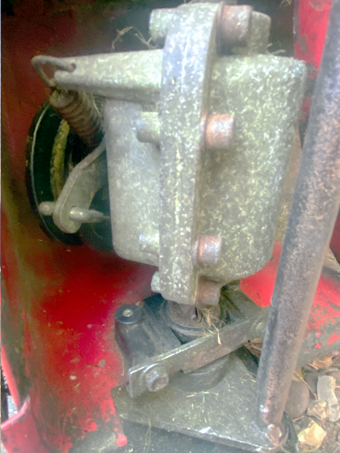

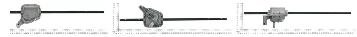

In the meantime, these poor (low res) images (of the "transmission") are from the Einhell website ...
Enlarging the middle one (showing the 'back' (upper, when standing on its wheels) side of the gearbox just about shows the spring in situ (I would add that mine looks slightly different from this pic) ...
Kind Regards, John

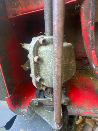

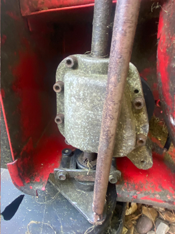

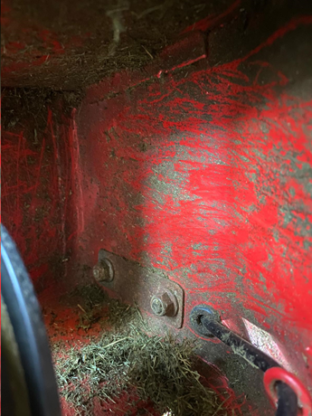

OK, my first stab at some photos. The first couple show the extent to which the gearbox will currently rotate on the axle - were it not for the clutrch cable and the bar joining the two rear wheel mounts, it would literally go 'round and round' the axle ...

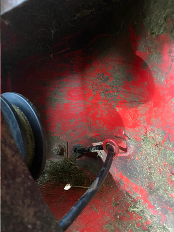

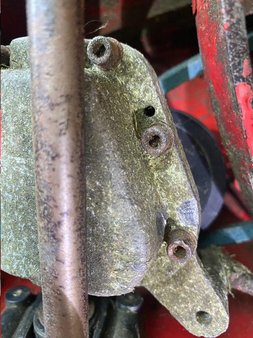

This next one is about the best I can do (without a lot of dismantling) to show the 'back' ('top') of the gearbox - with part of the 'tension spring' visible ...
Kind Regards, John
On your first photo I notice a drilled hole next to an Allen screw.....could that be where a hooked end of a spring could locate?
John

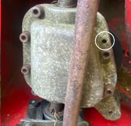

Do you mean gthe hole indicated here? .....
... if so, then, yes, I had a similar thought, since ithat is the only hole/bracket/whatever on the gearbox I can see to which a spring could have been attached. However, there are two "buts" ... firstly, a spring from there to tension the belt would have to go 'backwards' ('into the photograph') but it's route would then be perilously close to (if not blocked by) the pulley and/or belt ...
.... secondly, I can see nothing on the body of the machine behind the gearbox to which the other end of a spring could have been attached ....
I suspect that I am going to end up having to improvise some sort of 'bodge', but would have liked to do something which at least approximated to the original situation - if only I could work out what that 'original situation' was!
Given the issue of the pully and belt, I suspect that I'll probably have to somehow attach a spring to the 'other side' (left in the photos) of the gearbox and having the other end of it attached somewhere to the back of the machine's body.
Any other thoughts/suggestions?
Kind Regards, John
For sure this is an interesting one! That was the drilling I was on about but to be fair, there wasn’t any sign of a truth mark where the spring would have been.
Anyway, the axle has to be retained one way or another and naturally it would tend to be pulled towards the engine.
Most retaining springs are actually vertical from the axle up into the voids of the metal deck.....Honda technique anyway! Some designs have a rod connected to the axle which passes through the deck where the grass box is - the rod being threaded and often spring loaded.
Unless we can find an identical machine I guess it’s bodge time to somehow pull that axle towards the rear of the mower, but I can’t suggest anything else unfortunately.
I do think that tension spring that jj found has something to do with it though......it’s just too long just to be a clutch release device.
Regards
John
Indeed - quite apart from the pully/belt 'being in the way', I would have thought that there would be some tell-tale marks there had there been a spring going through that hole.
Quite so. That's obviously the problem I have, and need to rectify. The mower is relatively young and otherwise fine, so I would be very reluctant to throw it away, and to get it 'professionally repaired' (if I could) would probably not be very 'cost-effective'!
A spring going from that hole we've seen would, of course, be 'vertical'when the mower was on its wheels - but, for the reasons that have been discussed, I can't see that there could ever have been a spring there.
Indeed. I had obviously hoped that I might find someone who has got an identical machine, so they could look and tell me how it is meant to work!
As you say, I need to pull the gearbox towards the back of the machine, and that will require a 'horizontal' spring, somehow attached to the rear of the 'rear' (left in photos) of the gearbox. I may possible be able to use the same lug that the existing spring goes through or, alternatively,attach some sort of bracket using one of those allen screws. .
