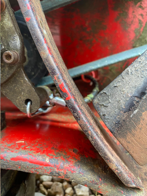

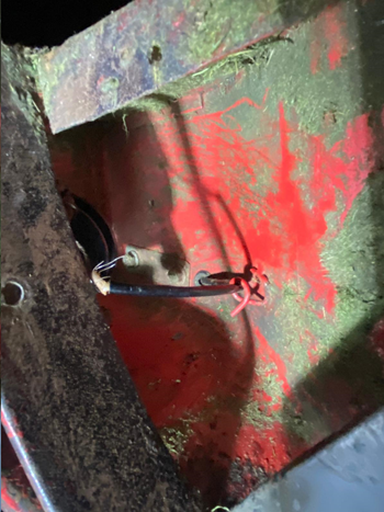

That sounds like a possible "Plan D" (or is it Plan Z ? ) ... but I hope I don't need to go that far down the alphabet :)
The adjuster only influences the actual inner cable. I'm away from the machine at the moment, so cant't look, but I have a feeling that "when properly routed", the outer of the cable is constrained by some sort of clamp (which would be very difficult to get at once the spring was installed) and that's what may restrict rotation of the gearbox. However, with a bit of luck my hazy recollection may be incorrect ;)
My recollection was, fortunately, a bit incorrect. The clutch cable is held not by a 'clamp' but merely a 'slip' made out of a bit of twisted wire. As I will be shortly reporting, that was not a problem ....

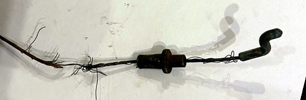

Talking of the clutch cable, I think I descriobe it as looking as if it was "on it'slast legs". Now that I've got it off (and replaced it), it's apparent that it was close to being "on it's last leg" (singular) since, at the business end, only two or three strands of the cable are still surviving ...
More very soon!
Kind Regards, John

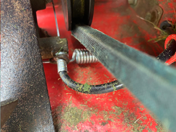

Right. I think I have, at long last, 'won'!
Whilst I'm very grateful for all the suggestions about ways to deal with strong springs, I was in luck and only needed 'Plan A' (not Plans B to Z!). Even with the (new) clutch cable 'properly routed' (and in its 'clip') I was able to rotate the axle/gearbox enough to get the spring on without having to stretch it at all. The strength of the spring was such that it then took a bit of 'wellie' (and some improvised tools) to get the belt on, but I eventually succeeded - and all now seems to work 'as the doctor ordered'. I've just 'field tested' it' by moving a small bit (about 150 m²) of my (large!) lawn, and is seems to be fine. It's hard to show the spring in place, but ....
So, I guess it's been worth it. I seem to have got the not-too-old machine back into working order at a cost not much over 10% of the cost of a replacement machine, and it has certainly been 'satisfying' to succeed. Of course, if I factored in the cost of my time 'at my usual hourly rate' the financial arithmetic would be very different, but that's not really the point!
I'm very grateful to all of you hear who have shown interest and support throughout this exercise!
