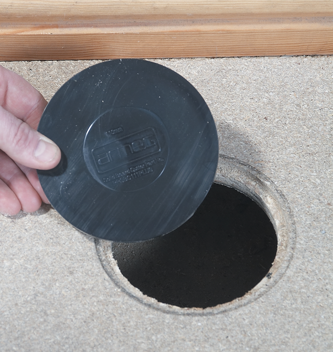

Just had the plumber in - who says they can't believe what a mess they've made - they went in through 5inch circular holes in the floorboards rather than lifting the boards themselves - is this normal practice?
It could be, if that is what you agreed to as an alternative to lifting the floor above? If there are problems like tiles, or built-in furniture which cannot be moved, there could be no other way than making hole in the ceiling below for access.
EDIT - I have just reread what you wrote. 5" holes in the floor - WHY????
I'm gutted about it - I've just had a plumber in to look at the pipe he hit with his circular saw - she was really angry i.e. wtf didn't he lift the floorboard up or saw it at the joists. It's one of those things you (or I) didn't question as that's how he says he does it - so then he braced the circular cut out and put it back, but obviously it's not flush.
I'd gone for this guy after he had lots of positive reviews on mybuilder but I'm sad at how much damage people can do to your house. Makes me worry about everything else he's done - drilling through joists etc.

5" is maybe somewhat excessive (presumably spanning more than one board) but I have to say that I have been known to do similar in the case of T&G floorboards, particularly when they have been secured by lots of 'concealed nailing' through the tongues. It's not difficult to do quite an aesthetically good job of making good a neat circular hole.

It's not difficult to set a circular saw, so it only cuts through a floorboard, but I suspect he wasn't a circular saw at all - he more likely drilled a hole and used a jigsaw to cut around the 5" diameter.

When I've done it, I've used a circular hole cutter - easier/neater than a jigsaw.

Any chance you could provide a photo?
Can you see this?
https://photos.app.goo.gl/zfTzAxAE8CFXGf6c7
This shows one that's been put back in (this split) and one that's been left off (where I was waiting for the plumber to come to check it). Sorry when I said circular saw I meant an attachment for a drill that cuts out a circle with a hole in the centre.

Maybe 5 inches is the smallest hole to get an arm in to grab a cable and pull through, or connect up?
Better to remove boards, but if that is not possible, I guess a hole it must be.
You should be able to put a big batten in and screw in place from top of floorboards, then fix round board to that?
