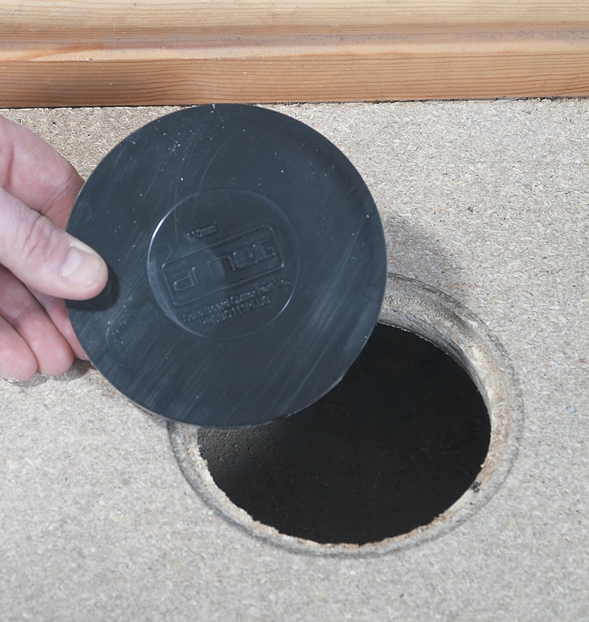

And it looks like he initially tried to drill it without a centre drill in the arbour (as seems to be evidenced by the excessive scoring).
I'm not sure that I've ever seen a hole saw with which that would usually be possible, since it's usually the 'centre drill' which connects the cutter to the drill's chuck, isn't it?
Why on earth didn't he just use an osculating saw to cut the board on the joist.
If the boards are going to be concealed by floor covering, then it doesn't make much difference how one is going to do it - so the easiest/quickest is probably the sensible way to go. However, at least in my experience, if the boards are going to remain at least partially visible, then one can usually end up with an aesthetically better result with such a hole than with cutting across boards (using a saw with a blade of finite width) over joists. Maybe you've never tried but, apart from anything else, it's difficult to chop through the tongues of tightly-butted T+G boards (using any method) without making quite a mess of them.
... and, as aptsys has said, it is quite a common method with chipboard floors.
At least on the holesaw I just looked at (think it's a wikes one but not 100% sure) the pilot drill seems to be held in the arbor with a grub screw.
Fair enough. With the ones I have (pretty ancient, and no clue as to the make or source), the 'pilot drill' goes into the drill chuck and the bit that holds the saw blade (not really an arbor as such) is held onto the shank of that drill with a grub screw.
