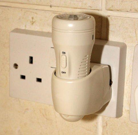

Another approach which can be useful in some situations is something like this:
The rechargeable LED torch remains charged up, switches itself on automatically if the power fails and can simply be lifted out and used for wandering around in the dark. I have a couple similar to that in my house, plugged into sockets on different RCDs, so that one will come on if either RCD operates (and both will come on if there is a total power failure).
Kind Regards, John
