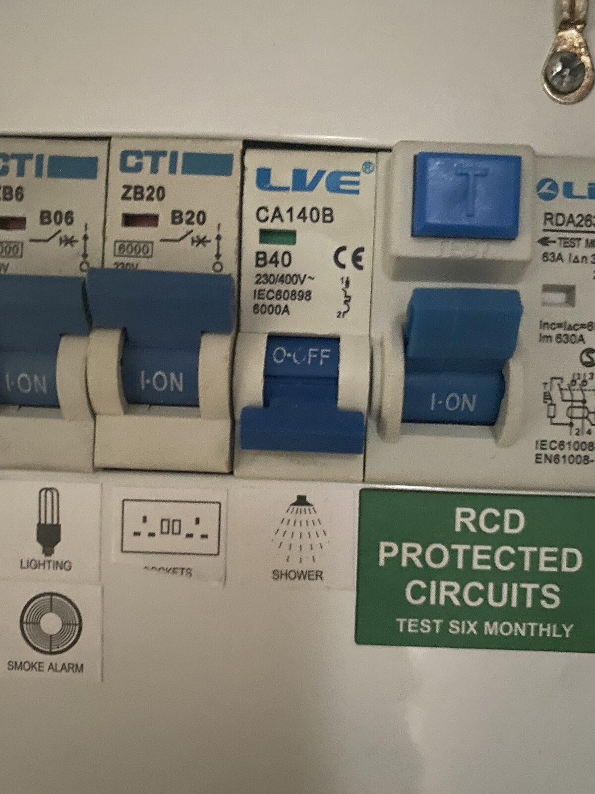

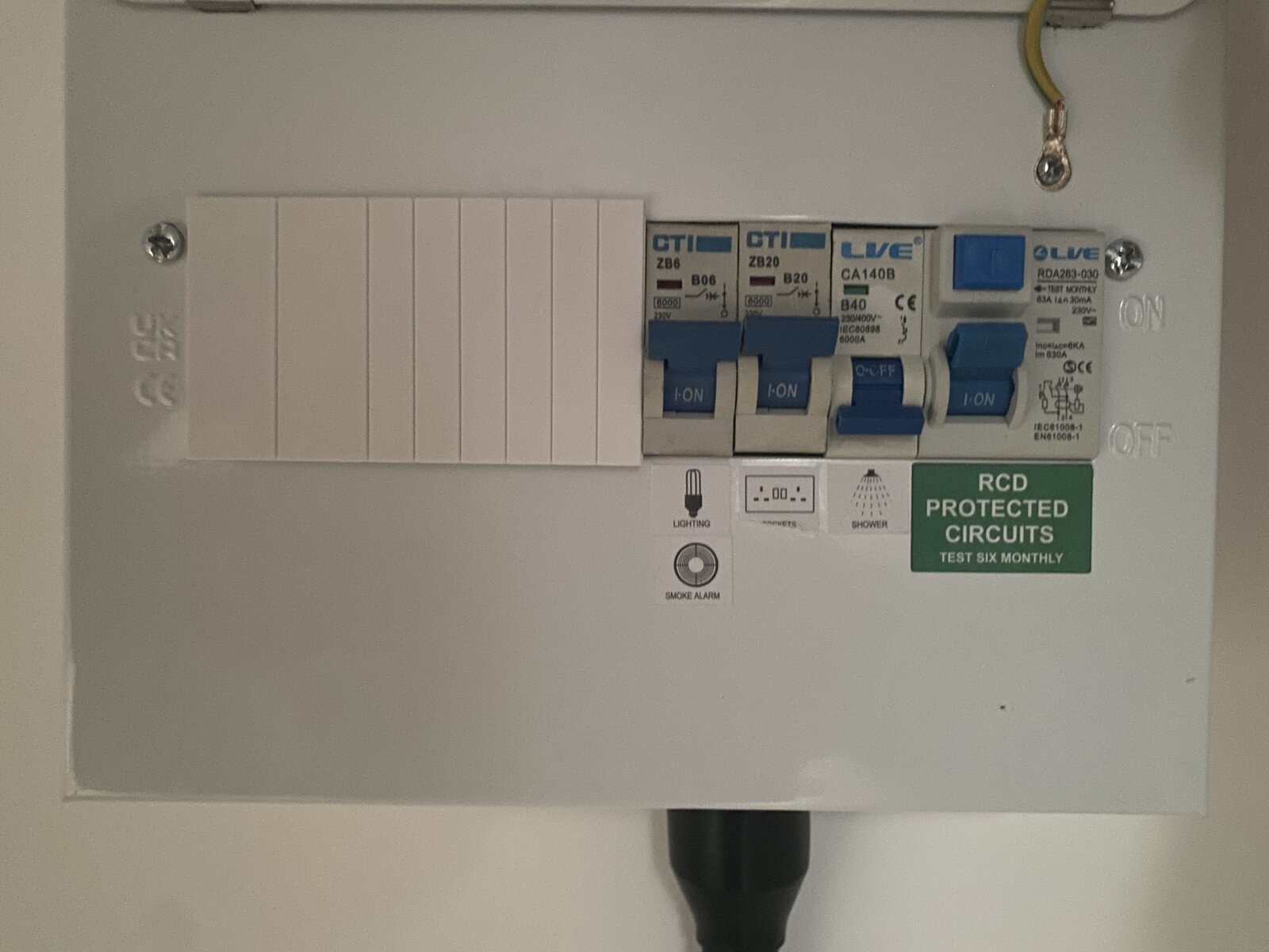

Newly installed Triton T80 8.5kW shower. The shower is tripping the MCB after about 5mins of use since it was installed. It’s on an 40A MCB which feels warm to the touch after it trips. Appears to be 6mm cable, the consumer unit is less than 18m away. No sign of water leaks, completely dry inside the case. Trying to get the guy who installed it to come back and fix, would be good to know possible causes/remedies before being fobbed off.

That device is an MCB ,not an RCD.
Are you sure the shower is 8.5kw ? The 40amp breaker isn't going to be tripped on overload by an 8.5kw shower alone ,it would trip if there is a short circuit though.
The MCB's on that board don't appear to be fitted very well ,and are askew. Why someone would fit 2 from another manufacturer is anyone's guess.

Ok thanks will try to amend my OP. With a short circuit would it be likely to run for 5 mins before tripping?
