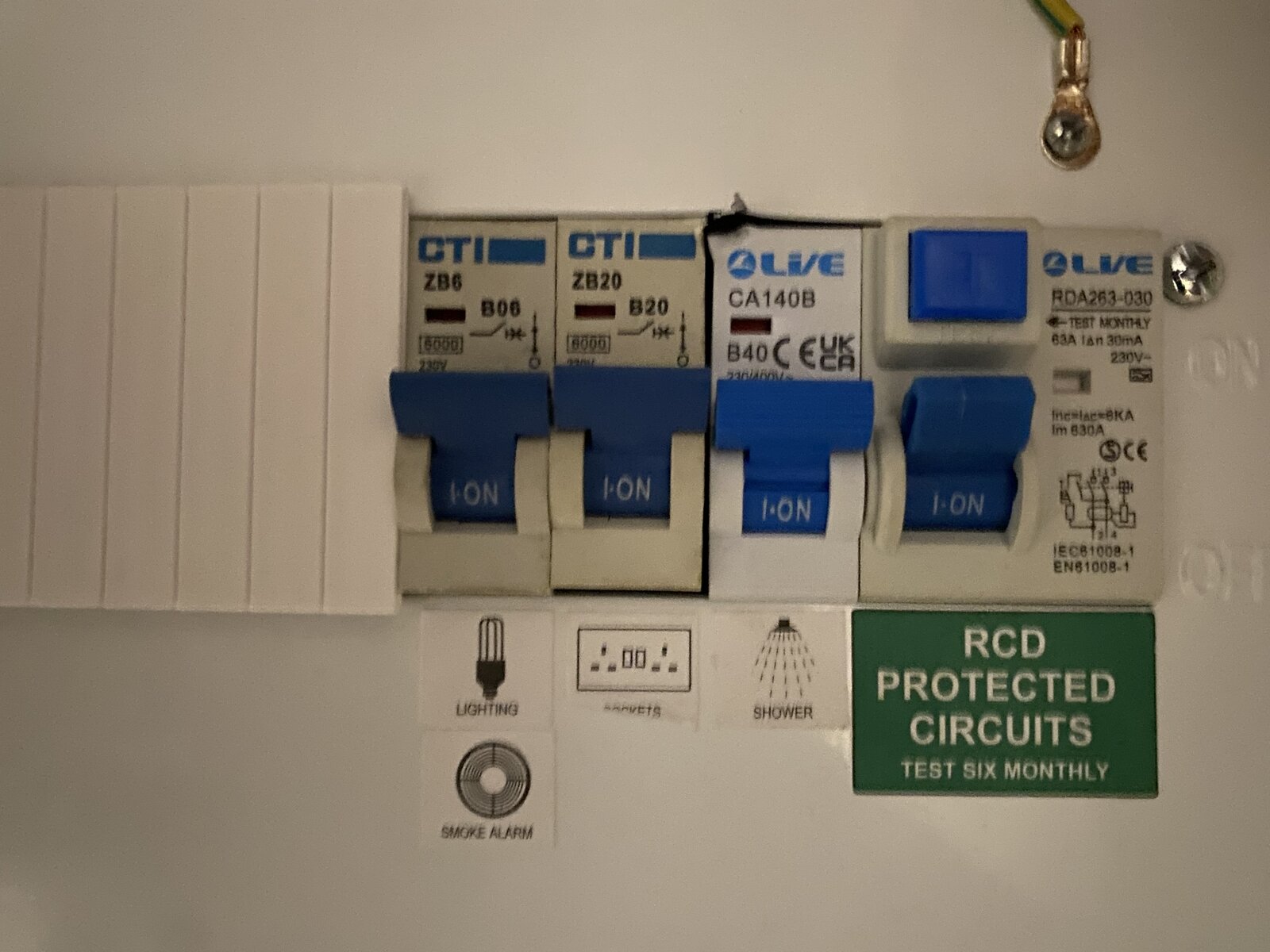

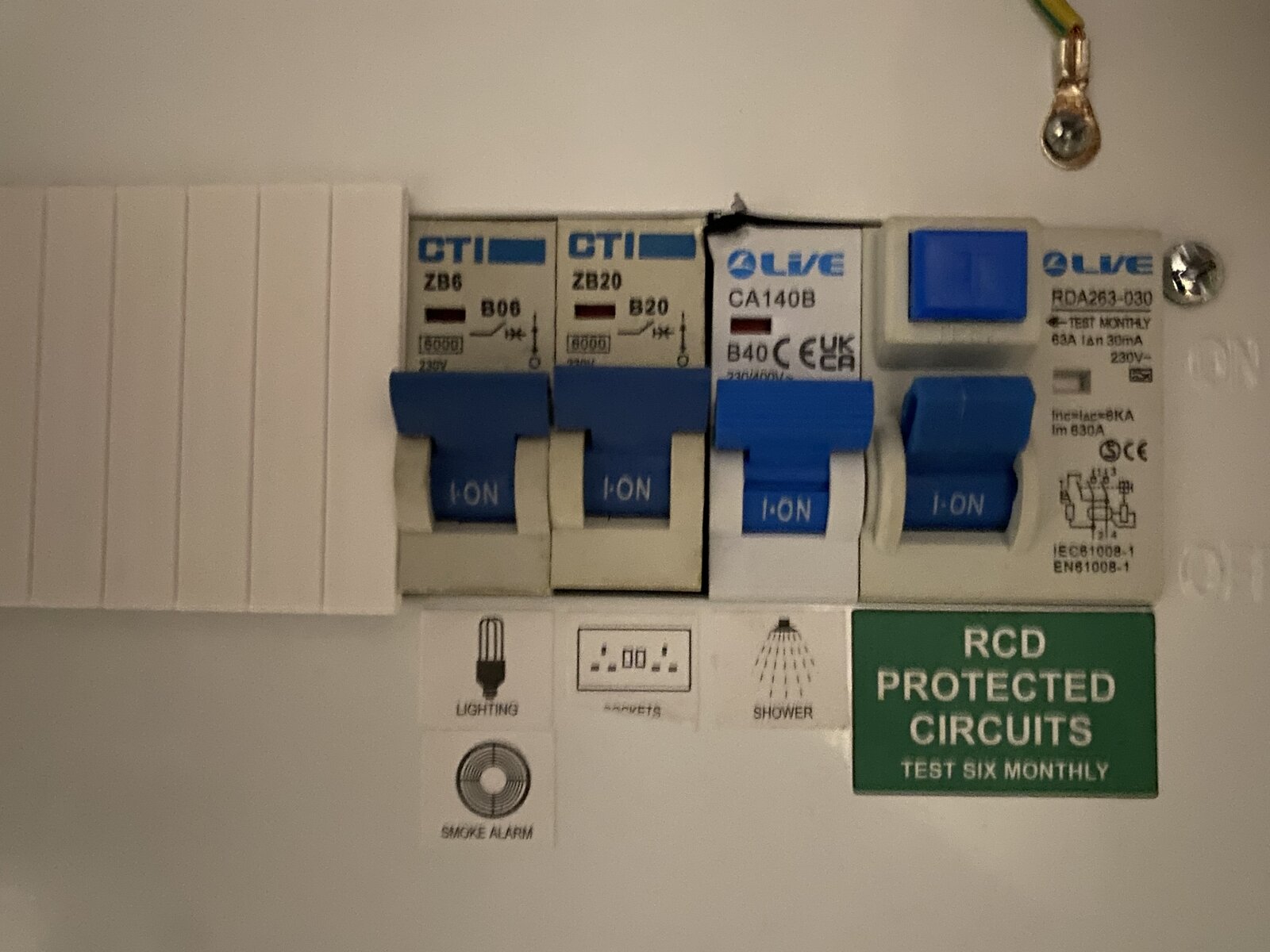

To update, installer has been out, checked for loose connections, tested the wiring and replaced the rcd. I noticed that under the original fault after tripping the MCB was warm/hot to the touch after the shower had been running. While the replacement remains cold, so seems like faulty breaker was the cause.
I didn’t get a chance to ask the reason for using swa, however judging by the consumer unit after he’d been at it he may well have an “industrial” background!
That’s the replacement breaker, damage to it and case looks like it’s been caused during installation, no idea how, it’s definitely not melted/burning. All seems to be working fine though.
That'll be where he used his screwdriver to lever the cover on around the breakers, rather than lining everything up properly first...
