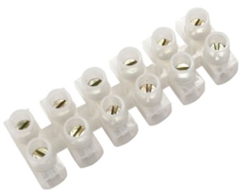

How is an electrical connection with a Block Connector (aka Connector Strip) viewed/assessed during Electrical Inspection ?
Cable from wall socket fused plug goes to corner of entrance hall.
Then connects to one of these Block Connectors covered with Insulation Tape.
Cable then goes outside side of front door to Entrance Lights.
Is this a Fail ?
