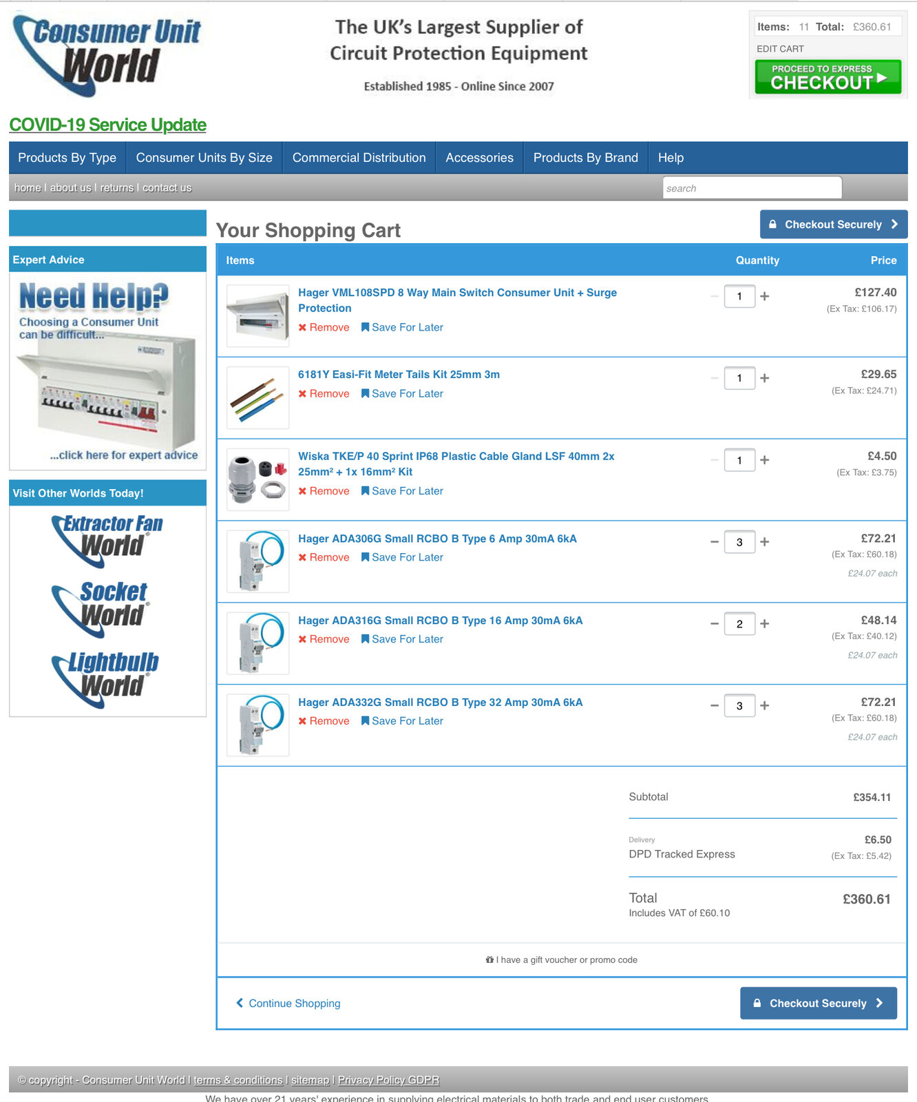

It sounds far too cheap to me. There is no way you can do anything other than throw the cheapest non compliant piece junk at the wall for that price.
I’ve just quickly priced up a decent quality compliant board for an average sized house from one of the best priced suppliers online, and the materials alone come to more than your entire price.

Lack of SPD, lack of proper circuit division, underrated and or incorrect type of RCD(s)
Lack of SPD, perhaps (albeit there may well be scope for debate about whether it is actually 'required' in a particular case) but, as for the rest - are you perhaps suggesting that anything other than an all-RCBO CU is 'non-compliant' (and, if so, with what?) - and maybe even also that Type AC RCD's are 'non-compliant'.
If, by any chance, your answers to both those questions are "Yes", then I wonder what roughly proportion of in-service CUs in the UK you think are 'compliant'?
Kind Regards, John
I seem to remember paying around £270 for the bits to do the consumer unit in this house, then found all type AC RCBO's.

Admittidly folks I thought his price to change the CU and add in the two lighting circuit rcds was pretty cheap.
Had a quick look on screwfix which I know is not the Waitrose of the electrical goods sector but a metal CU was coming out at around £67 and rcds were about £25 each.
So £275 for this including labour doesn't sound that out of line.
I'm not an electrician but if these items from screwfix are BS approved etc and meet the EICR regs, then why would I not choose them?
What extra would I get at buying the more expensive items?
If they are safe and approved and get rid of my EICR C3s, then what is the problem.?
