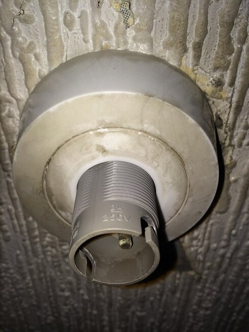

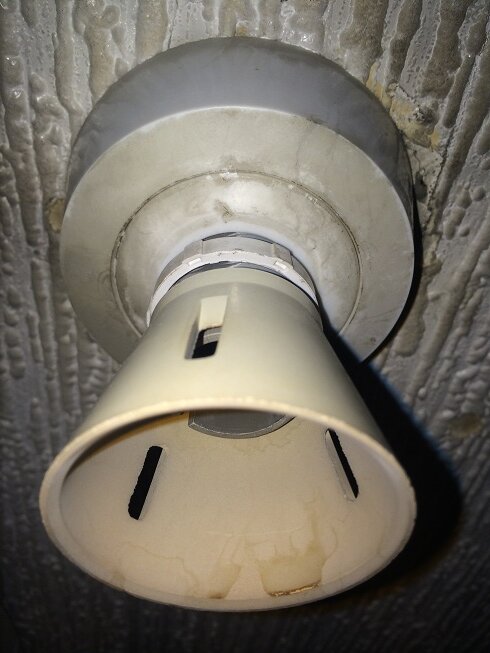

This light fitting in bathroom is going to be replaced, just checking how it is removed.
Not sure what I am missing, but cannot see how it is removed.
Removed 2 screwed on bits, the centre bulb holder is loose.
Can't see how ceiling screws are accessed.

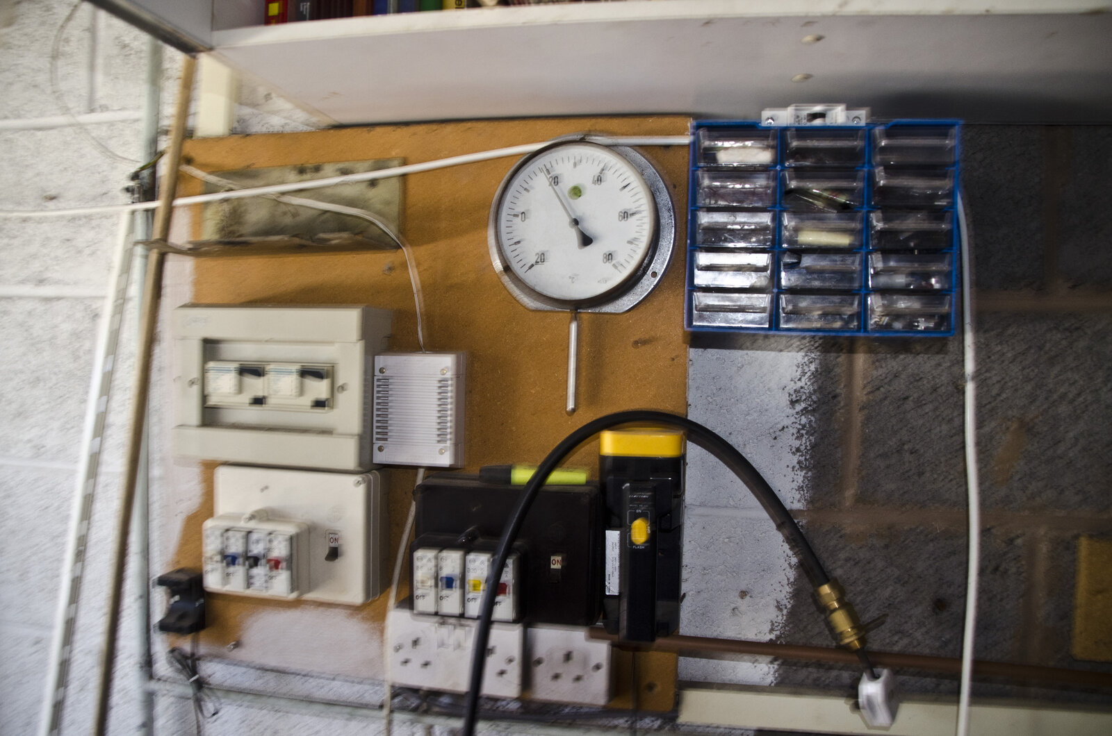

it has been a problem with the use of plastic pipes, where the earth bonding is lost due to the use of plastic fittings, so in 2008 it was allowed not to bond if there was RCD protection, and it is common to find bonding missing, so in real terms hard to use the old fuse box, clearly you could still fit RCD protection DSC_3921.jpg as was done here, but that was done before we had consumer units with RCD's built in.
-should an open bayonet fitting Bathroom Light be replaced with an enclosed light ?
In zones 1 and 2: IPX4. Electrical equipment exposed to water jets, e.g. for cleaning purposes, shall have a degree of protection of at least IPX5. But it depends if the lights are in the zones or not as to if the lamp need that IP rating. "IPX4: Is resistant to water splashes from any direction." it does not need to be marked IPX4 but has to resist water splashes. It can be debated is an open bayonet fitting can resist those splashes.
Some of the old plastic does seem to glue its self and in the past I have ended up smashing the fitting, not the intention to smash it, but since being renewed it was not a problem.
