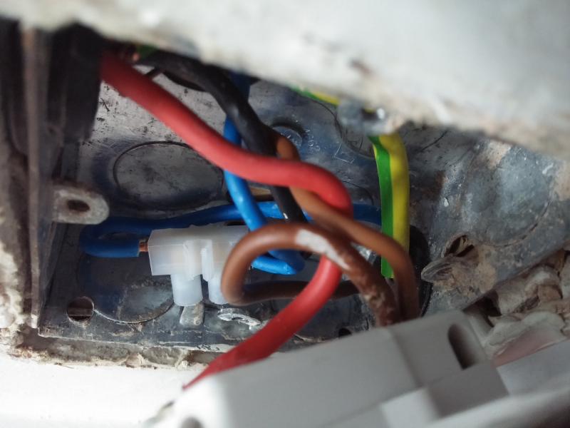

Hello,
I have recently had some electrical work done on the house and had some new switches put in. Once of which was in a cupboard where the boiler used to be. So this was a fused switch before hand and the electrician has put on a normal switch instead which is what I asked for. I did inform him that the boiler runs from this switch as the electrician used the same cable run when the boiler was moved so this switch essentially runs the boiler and switches on the light in the cupboard. He said this was fine when changing the switches from a fused switch to a 1 gang 2 way switch as the wiring was correct for the boiler and the light.
I have since found that when I switch the light off the boiler goes off and when I switch on the light the boiler comes back on again. So I spoke to him and he basically said its not his problem he has done the work required and is requesting more money to fix it! I have explained to him about the switch linking to the boiler and the light and his acknowledgement of this but still refused to budge on this.
I am wondering now if with the fused switch this was doing the same thing before and I never noticed it before (now its winter) or if it was working correctly before and regardless of the switch position the boiler would stay on?
Do I now need to change the face to a fused face or can I change the wiring as its a 2 way switch to keep the boiler on regardless of the position of the switch?

Well, the boiler must be controlled by a 3A fused switch so if he has removed this and not put one somewhere else then it is wrong.
Obviously you do not want a light and boiler on the same switch.
You said 'one-gang, two-way'.
Did you mean a 'two-gang', i.e two switches on one plate?
Can we see a picture please? A photo also showing the wiring behind the switch would be useful. here's how //www.diynot.com/forums/viewtopic.php?t=129539
Also. The boiler must have a fuse in its supply - 3amp is the normal. Without the correct fuse the boiler electronics and programmer, valves etc are at risk in the event of a fault. I have seen the results where even the wrong size fuse had been in the circuit, it cost the householder over £1000 to get his heating system up and running again!
Also - there must be an isolation switch that switches off both the live and neutral connections to the boiler. A regular light switch normally only switches the live, so is not correct.

Yes sorry in the garage when the boiler was put in it has its own fused switch with a 3A fuse in it. I know this because when the boiler stopped working I changed the fuse to see if this is what was causing the problem obviously I found it wasn't.
So yes it is on its own switch and fuse and the circuit looking at my fuse box looks like its a socket one as its with all the socket circuits. And yes I meant that it was a single switch which can go two ways.
As for the picture of it I have attached two for you at different angles to get a better look all round for you.
If I needed to change the socket would a 2 gang 2 way switch work better given the cables are different sizes? So the boiler goes into one and is switched on permanently and the other controls the light?

I see three line wires one red two brown I would expect there to be one terminal of switch with red and brown and other with a brown wire but no real way to work out which brown is which. However see no real problem with trial and error. If browns correct than switch will work light and boiler will run all the time. If wrong then boiler will work on switch and light run all the time.
I am assuming red is feed as old colour and browns are to boiler and light.
Working and being correct are not the same. If supplied from 16A MCB which is in turn supplied from RCD or supplied from RBCO then likely OK.

So basically if if I understand you correctly the wiring is correct as it is the only thing I would need to change are the browns or red around and hopefully that would work? Which would then allow the switch to switch the light and the boiler would stay on continually?
So I would need to find out which is the boiler wire and the live from the RCD and put them in the common and then the brown or red going to the light goes into L1 which would then have the boiler having a constant live feed and the switch only operating when switched?
I hope I understand that correctly? If that's correct would this then still be correct? Or would I be best changing the switch for a 2 gang 2 way and having the boiler and light separate anyway?

Yeh looks like he's mis-wired the boiler supply, one of the browns needs to be connected to the same terminal as the red. Out of curiosity what rating is the MCB that isolates the supply to the light/boiler?
