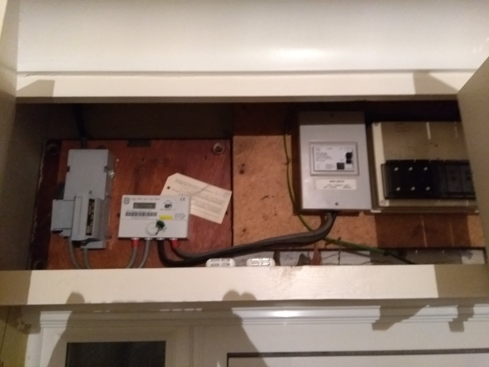

I have an old fuse box that has a working RCD switch attached. It has tripped a few times already, so I know it is working. Once with a faulty socket, and once when I touched the toaster with a knife ....
But, I want a new consumer unit so I can more easily manage the electrics myself. I don't, and won't, do anything major, just changing light switches, fittings etc, myself, without having to turn off all the electric.
So I had an electrician come round, and he said, no, won't just change the box as this might result in it tripping all the time and cause more problems. Recommended we had a £200 survey to determine the state of the electrics and possibly rewire.
It looks like the electrics have been rewired, I saw good cables below floor, and the loft has neet good cables running along joists etc. Not old knackered ancient cables. There are a couple of light switches that need updating as they have no metal backplates or earth, but most of the house (which is small) looks good.
So, was this electrician just hoping to get a load of cash (he mentioned £4000 re-wire, then £1500 if not as bad as it might be) and this in addition to the £200 test, and I quickly lost interest and sent him on his way.
I have a bungalow, some electrics under the floor, some cables running through the loft. Will be decorating it all over the next year, so don't mind if I need some parts rewired - that is, happy to have cables chased into the sold walls and filled over etc.
So, should I just get somebody to install a new consumer unit and hope for the best? I don't think I have many circuits at the moment. Probably just lights, sockets, oven, boiler, and maybe outside lights. I don't like touching these old fuse boxes though, as I have no idea how they work!

It's worth getting an EICR done prior to the consumer unit change. This will outline the condition of the installation and highlight any areas of improvement.
Given it's a bungalow, you're unlikely to have any problems with shared neutrals so I cannot see why the electrician would think the installation could trip all of the time.
Try someone else.
Well, he did say “might” result in tripping. And yes it might.
I always do an installation test before carrying out a fuseboard change. It is a wise precaution as a serious fault could mean no electricity until it is fixed!
It’s up to you. I would have him or someone else do an EICR as detailed above. Then you will know the health of your installation.

Not sure how replacing a single RCD set-up with either a twin RCD, twin RCD with some RCBO's or all RCBO set-up "might result in it tripping all the time and cause more problems."

Isn't the RCD in question a 300mA?
If it is, then not really relevant to replacing the fuse box or to personal safety.
What does that mean? 300mA, TT?
TT is where the earth is an electrode in the ground, but not necessarily the case.
Those RCDs were fitted in relatively modern houses with normal supplies and are not the equivalent of modern 30mA (thirty) RCDs installed for the protection of persons.
300mA is a tripping current for an RCD. The switch box to the left of the fuseboard is an RCD. What is written on it, your photo is out of focus!
TT is a type of supply. Is your electricity supply overhead? do you have an earth rod stuck in the ground, somewhere.

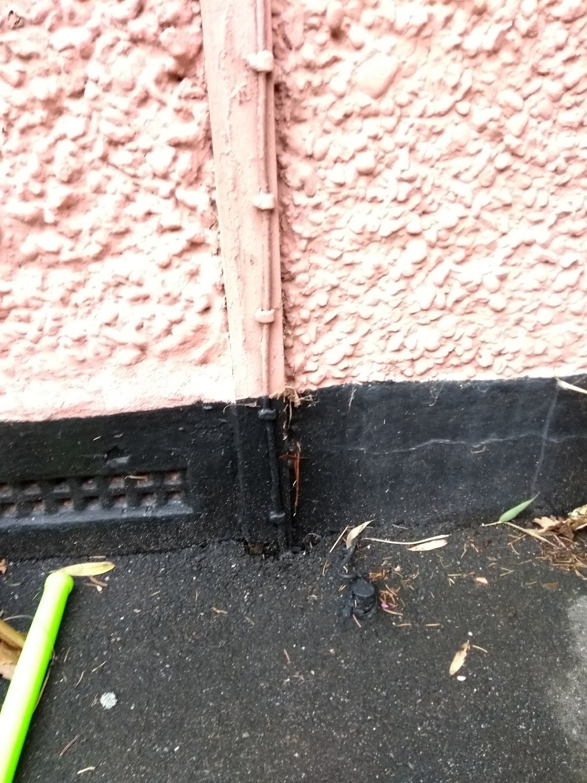

yes, supply from above, and there is a thing going into the ground outside, could that be the earth?
Yes, you have a TT supply that requires particular safety measures. This may be one of the reasons why your electrician is using a degree of caution.
