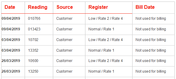

I have today provided both ESB and my old supplier (E.ON) with meter readings (and I also gave E.ON one yesterday, 'just to be sure'!). In the case of E.ON, in contrast to what has always happened in the past, the readings I provided today did not immediately appear in the list of my 'meter reading history', the most recent entries in which are ...

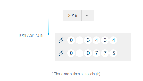

With ESB, the reading I gave them today did immediately appear on the 'All MY Meter Readings' page of their website, but all I currently see there is ...
Unless those squiggles to the left of the numbers have some meaning, there is no indication of the 'type' of reading ('customer', 'industry', 'meter reader' or whatever). This obviously might change, particularly once I have submitted more readings - but if it doesn't change (and assuming I don't discover some meaning of the squiggles!), I may not know that the verification process has been completed until I get a final bill from E.ON.
