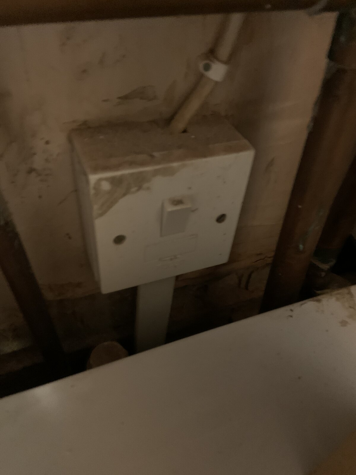

UPDATE
Thank you for everyone’s input.
You are all amazing. My partner has just changed the fuse in the boiler switch and it’s all working now. Thank you so much. We have heating, Wi-Fi and hot water now. YEAH!
UPDATE

Sorry, realised I put ‘no switch’ for boiler in an earlier post but it does have a switch.
Hopefully a 3A fuse was used.
I guess we are all surprised. And wonder how long this will last, as it doesn’t explain the original fault. Or is the conservatory switched off now / fuse removed ?

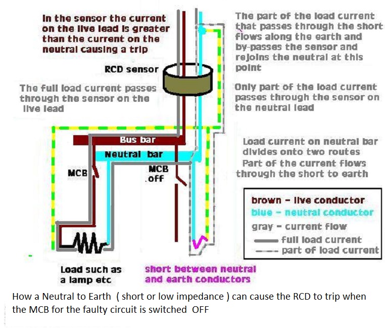

A earth to neutral fault on circuit "A" can cause an RCB to trip when the MCB on circuit "A" is switched OFF.
The RCD is tripped by a partial current through the RCD from a load on a circuit that is NOT faulty.
The good circuit appears to be the faulty circuit as the RCD trips when a load on that cicuit is switched on.
