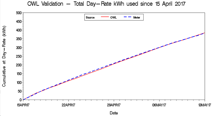

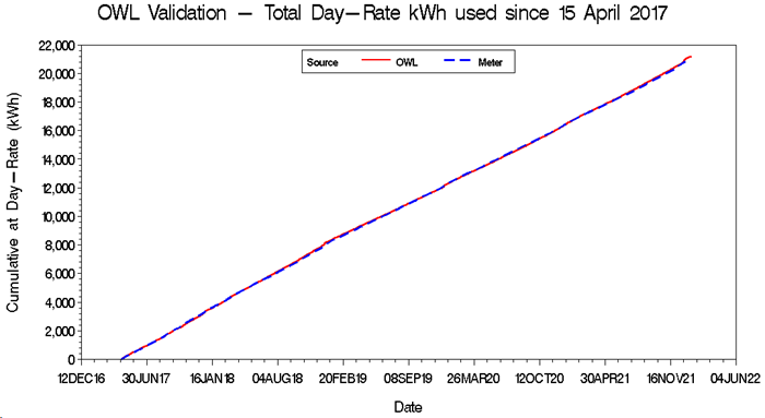

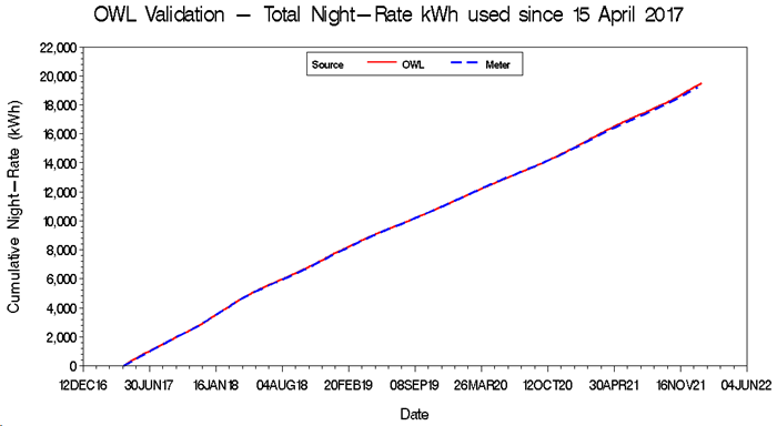

Time for me to wheel out the graphs below again! Once they are properly configured, the "Owl things" are surprisingly accurate for the monitoring of whole-installation usage over appreciable periods of time (anything from a day or two up to 'years').
The below graphs show (separately for 'day' and 'night' usage) the comparison between my Owl and the supplier's meter over the pst 5+ years. As you can see, over those 5+ years there has only been a handful of kWh difference, out of a total (day + night) usage of around 40,000 kWh. That's plenty good enough for me!

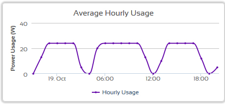

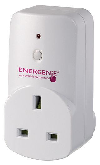

However to measure less than 10 watt it was useless, it did have a log display so could see some thing switched on if general use was low, but the simple plug in energy monitor upload_2022-2-7_17-35-25.png worked far better. Borrowed my daughters, liked it so bought my own. I then bought the Energenie one upload_2022-2-7_17-37-56.png which actually tells one less, but since computer linked you can see when the power was used, I have used it for all sorts including checking if the heater on my home brew was keeping up beer.jpg if it switches off then keeping the temperature high enough. Also used it to see when battery has fully recharged.
However I regard it as a toy, it saves me walking into the flat under the house to check on things, but it does not save electric, as said the non computer one did show when freezer was faulty, but most things have the power used written on the outside.
I would have liked to compare the halogen hob to induction hob, but since they don't plug in, not really possible, the computer does show average use better than stand alone, it rounds off the corners, this beer.jpg should have been a square wave really, but with electric heating as you say you have, if curtains are closed so inferred can not leave the house, does not really matter if heat coming from TV or heating system you can't destroy energy.
The below graphs show (separately for 'day' and 'night' usage) the comparison between my Owl and the supplier's meter over the pst 5+ years. As you can see, over those 5+ years there has only been a handful of kWh difference, out of a total (day + night) usage of around 40,000 kWh. That's plenty good enough for me! ...
It occurs to be that some people may think that very-long-term performance may not fairly represent the accuracy of the Owl on a day-to-day basis. The below is therefore just the first four weeks of the 5-year period I illustrated in the previous ~5-year graph ..
