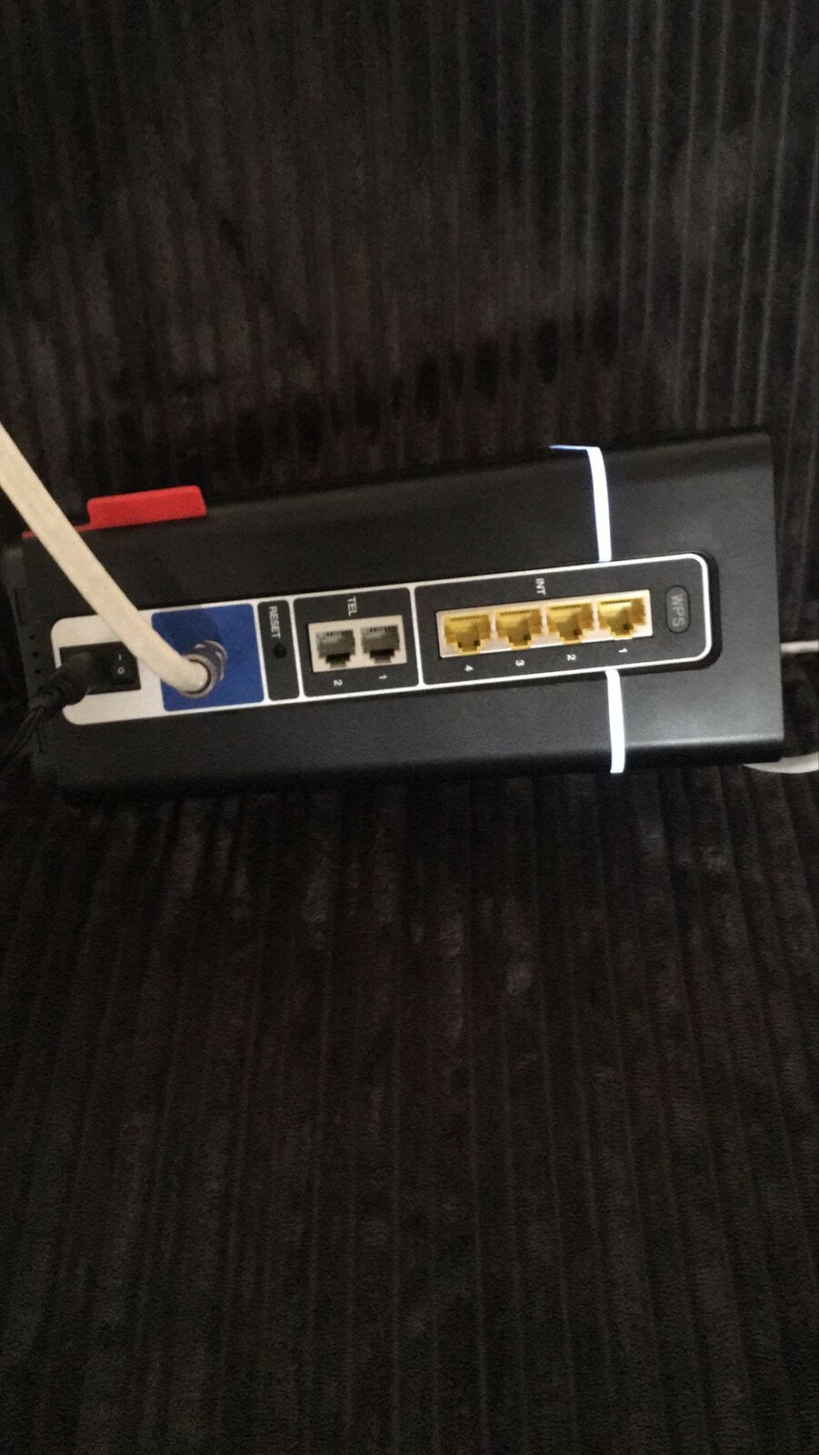

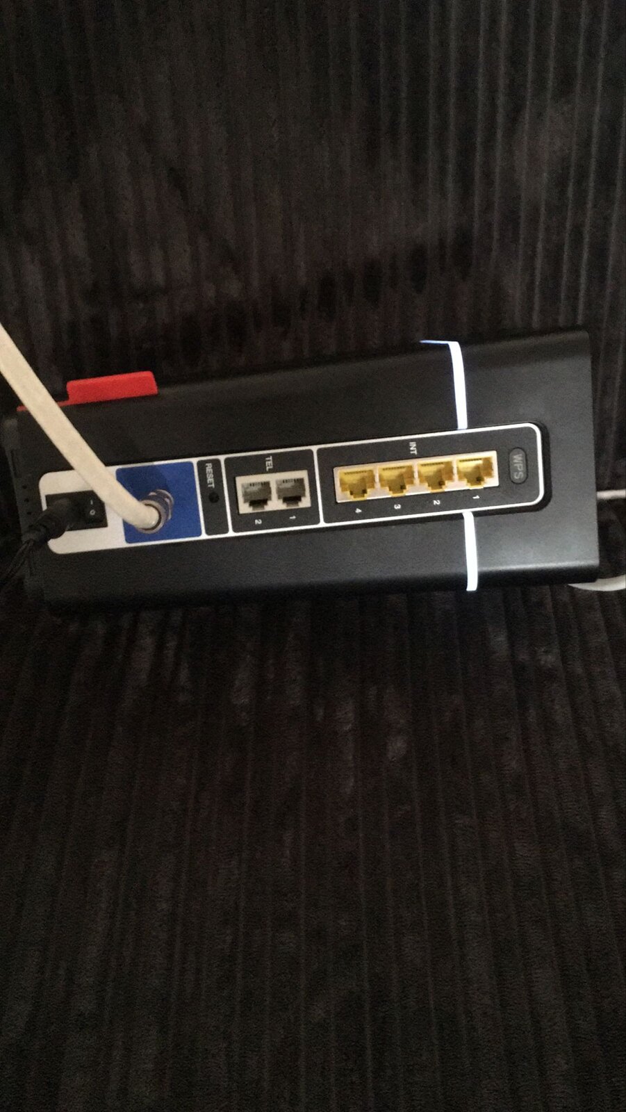

Post pictures of what you have in the rooms and what you have near the router

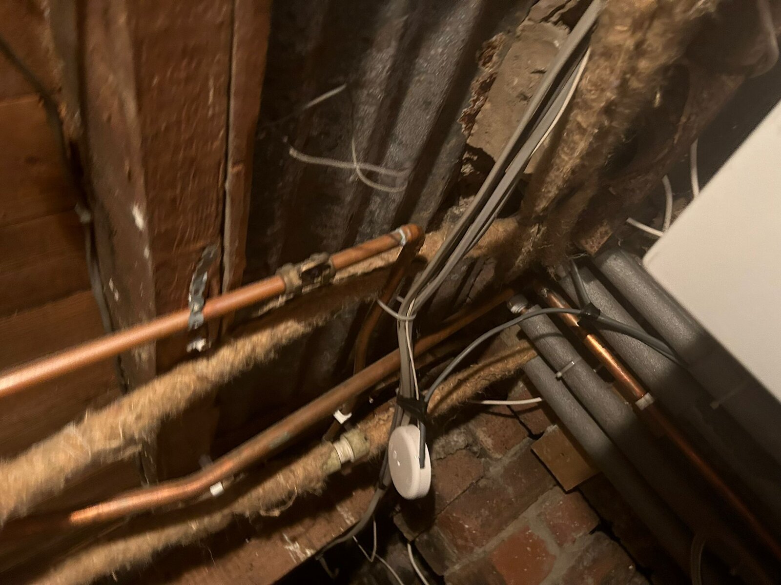

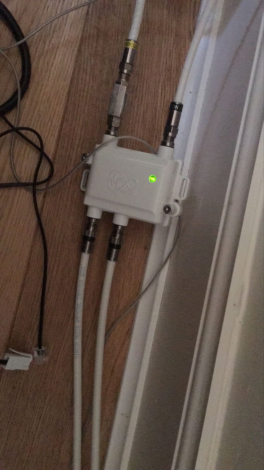

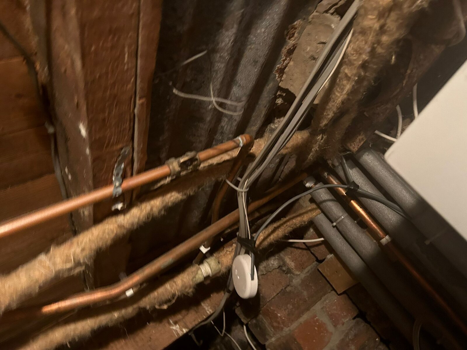

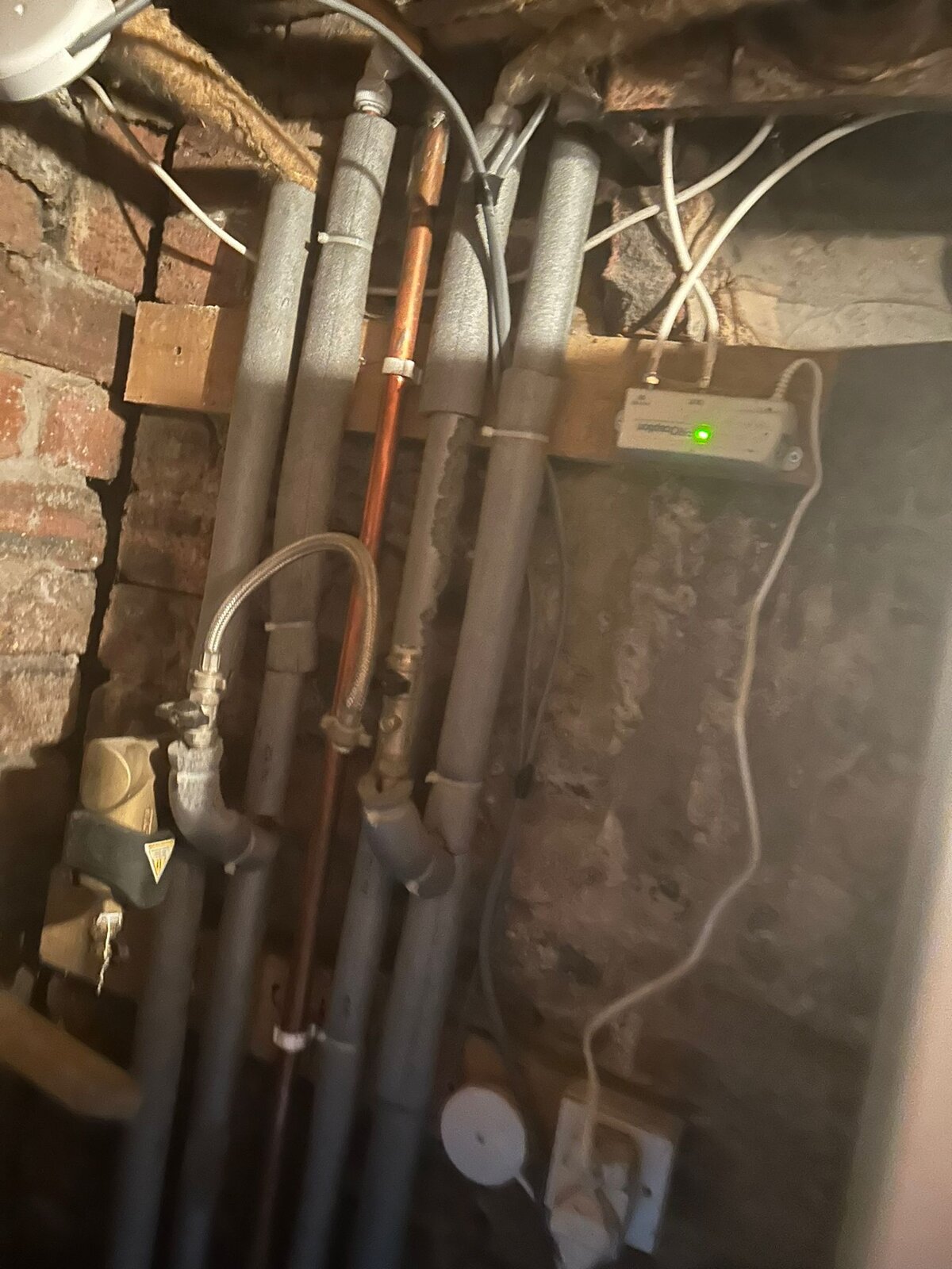

I'll post pics of rooms and near the router but here are some cables that I found in the cellar. any use?
You first photo, appears to be a TV antenna amp, so TV cables. Your second photo show mains cables and a joint box. Nothing to do with Internet or LAN cables.

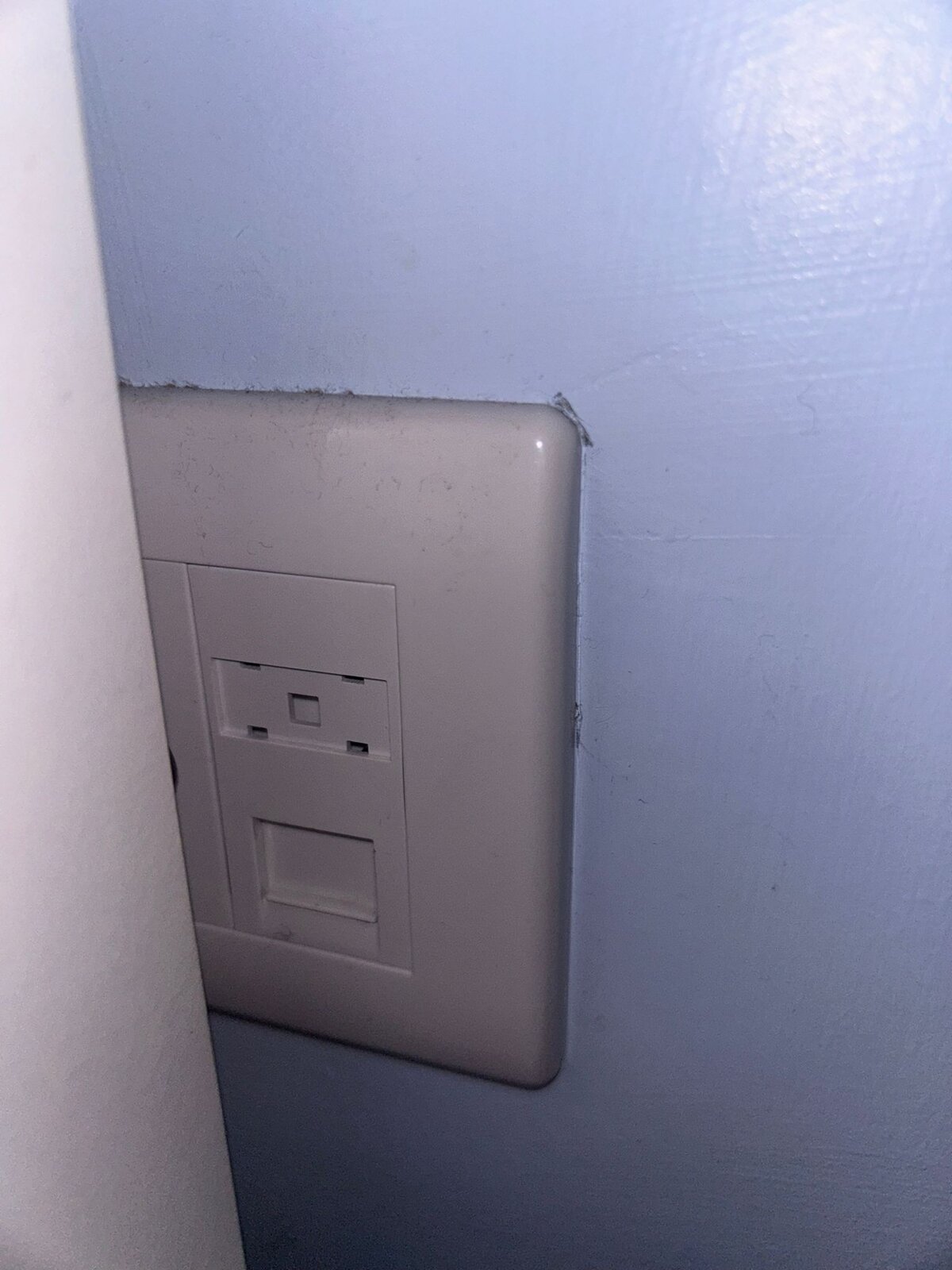

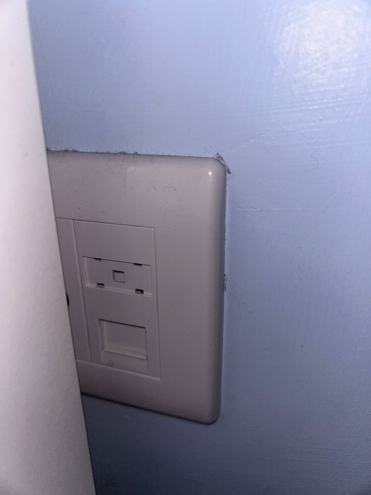

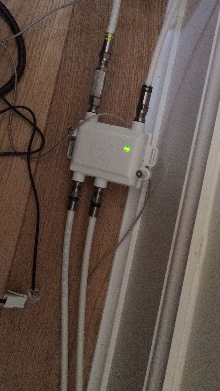

socket in room & wires near router.
