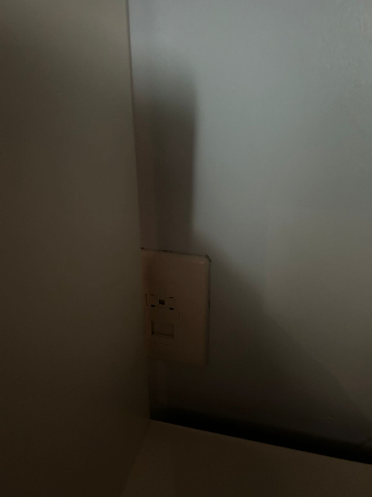

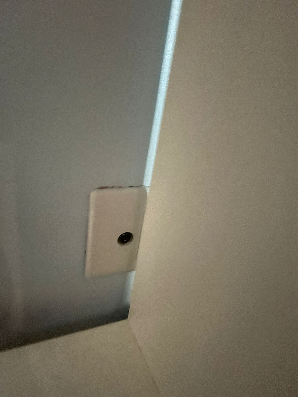

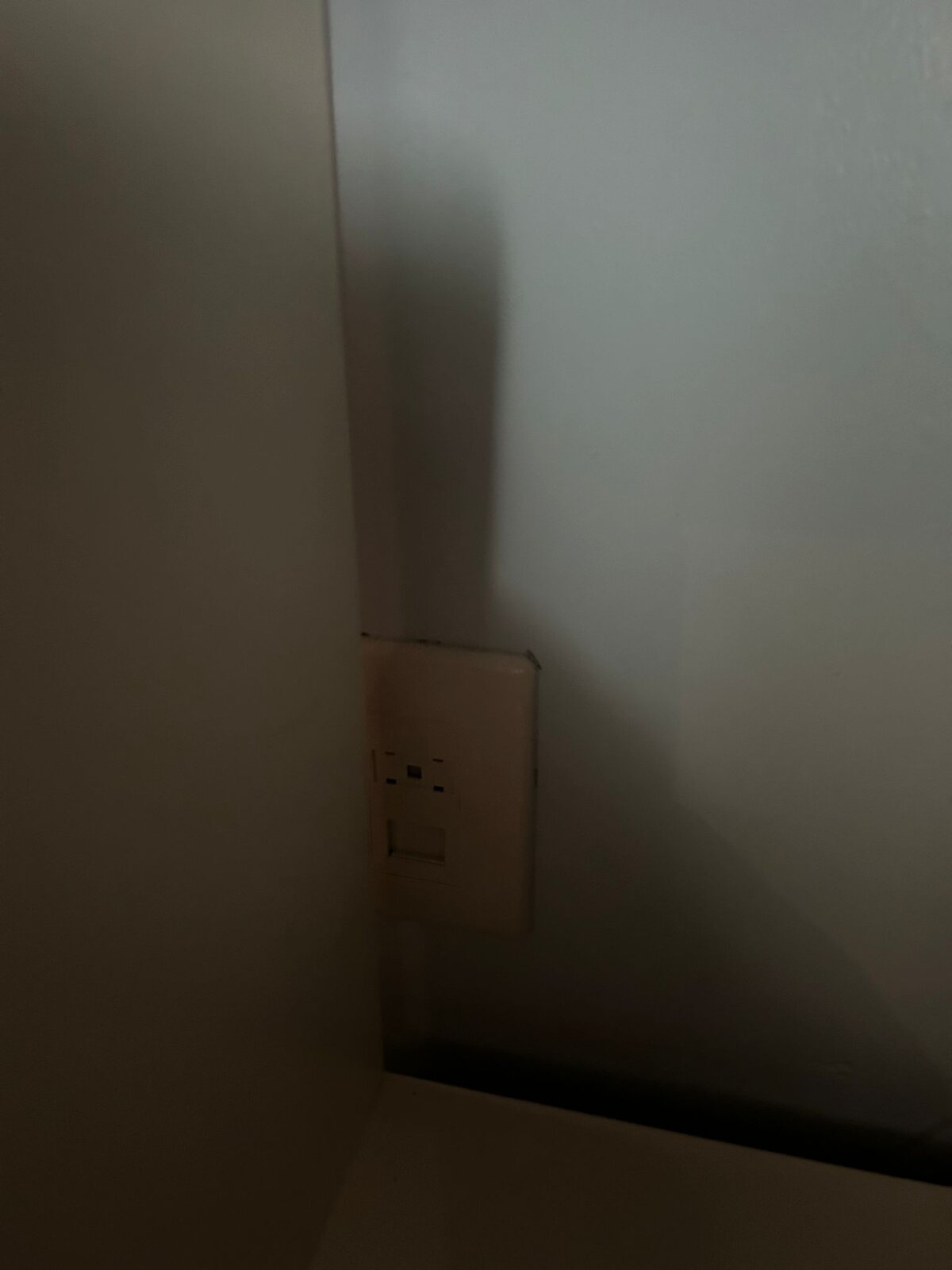

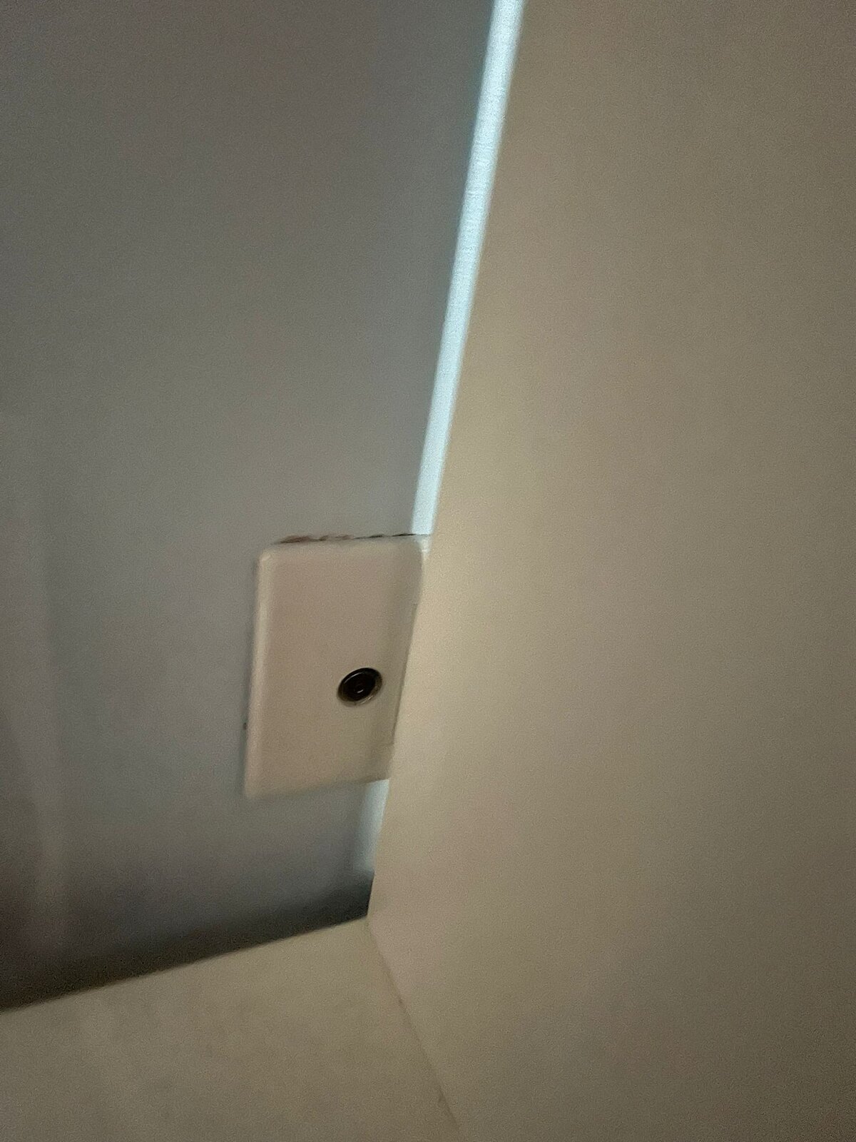

we've used wi-fi internet in our house for many years. When the house was rewired we had ethernet sockets installed in some of the rooms. How do I find out where these sockets are connected to? should the connection be before or after the router?

Open up one of the ethernet sockets, and look at the type/colour of its cable, hopefully you now know what type of cable to look for. Have you checked the loft? PS, there will be a cable from each socket to connect to the router/switch, they can not be daisy-chained.

do you know how to open this socket? is it an interference fit?
