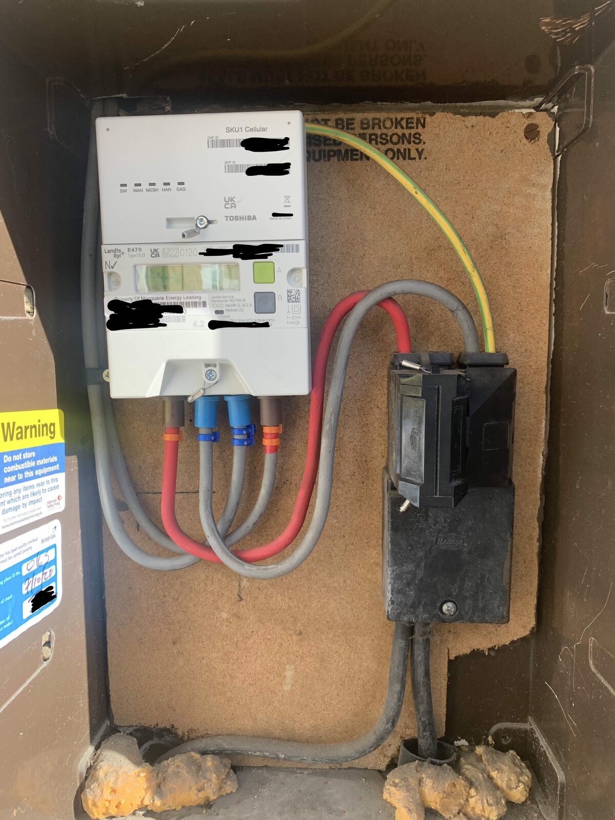

Hi all,
I am thinking of getting an EV Charger installed at home. My very limited understanding is that I have a looped power supply and some sort of remedial work needs to be done first before Octopus energy (or any other installer) can install the charger. Attached is a pic of my meter box
Please who I need to call first to sort things out and any idea what I should be telling them to put in or they just know?

I would start with approaching an EVSE installer. They will have come across this before and will know what to do [basically - because you need to use the services of an EVSE installer anyway, you won't be doing it yourself].
Not necessarily.
May be possible to install and operate at a reduced power until the supply is remediated.
Depends on what other loads are connected, what rating the supply really is.
Thanks guys, Can I contact the DNO first to do the required changes first before contacting octopus or EVSE installer.
Reasons for wanting the changes 1st is because :
1) Still trying to find 'the' decent bmw i3 with the right price and extra features but at the same time looking at ICE market
2) I only manage about 20 miles weekly so would rather start off using a granny charger with intention of committing to an install once I feel EV is not a fad for me
I just called up UKPN.
They told me that I might not need any changes, and that the installer will be the one to decide. is this true
Yes - as they are the one who will assess the existing installation and electrical loads.
