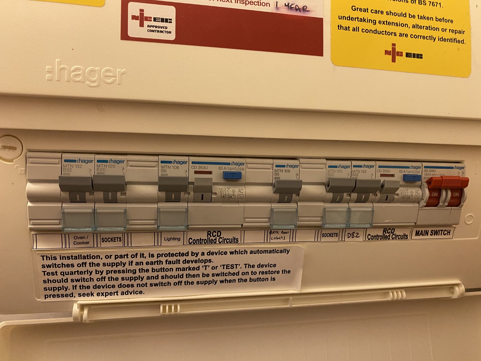

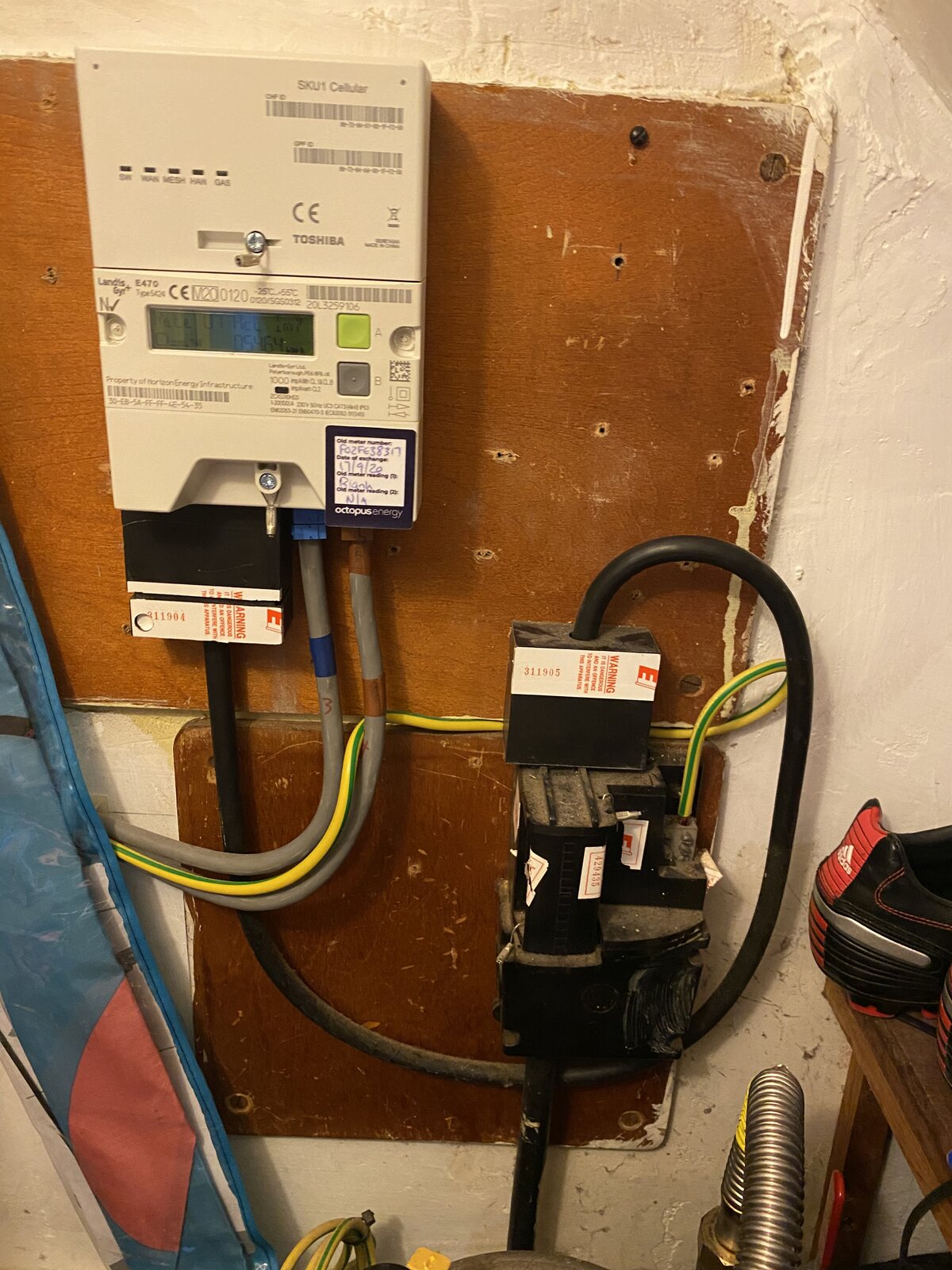

I’ve attached a picture of the consumer unit and where the main cable comes into the house (on wall adjacent to consumer unit). Assume that I’ll need an rcbo?
I’m aware I’ll need a qualified electrician to connect to consumer unit and fill in the forms. I’ve only got a 60A fuse so need that upgrading.
What rcbo would you recommend?
How much time do you think it would take an electrician to do all the testing, forms and certification? What’s a reasonable going rate for that work in Warwickshire?

The RCD you have is a type AC
but not sure if that consumer unit is the high integrity type with a third neutral rail, so not sure if a RCBO can be fitted, but that RCD is not suitable. Also only rated 63 amp. Plus it is plastic, so clearly old, so up to the person signing all the paperwork to if he feels that it OK for the extra load.

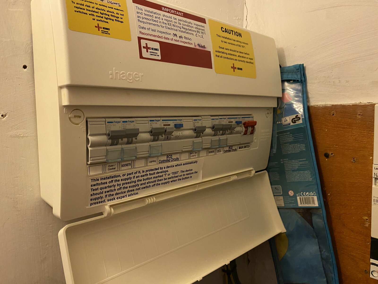

Thank you. Appreciate the detailed response. I’ve added what’s hopefully a better photo. Depends if the forum reduces the quality though.
How would I figure out if it’s the high integrity type? Can’t seem to find a model number on it anywhere. Must be on the side next to the wall.
Can you not just change the breakers rather than the whole consumer unit? Or would you then need to uprate the main breaker as well?

I am an industrial/commercial electrician, so have not really worked with the type tested distribution units called consumer units, as mainly work with three phase.
In the top of this CU
there are three neutral bars and an earth bar, so you can have two RCD's and some RCBO's, but without that extra neutral bar you would need to remove on RCD and replace it with all RCBO's this can be done but the cost goes up.
At some point one has to consider if better to swap the whole consumer unit, and add SPD etc. You are in the design stage, which is likely the hardest bit, I opted with my own house for all RCBO's, mainly as just before moving last house the RCD tripped and I lost 2 freezers full of food, which cost a lot more than going for an all RCBO CU.

You might not need to upgrade your fuse. My electrician says he does lots of EVs with 60A fuses. He fits load monitoring where necessary.

Yeah isn’t that the main breaker fuse rather than the breaker on the consumer unit. I’ll be getting the main breaker upgraded anyway as I hear it’s the responsibility of the power company (western power) so not expecting to have to pay for it.
