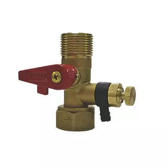

Probably a 10L then but look up your boiler spec and see what size EV is installed, if your boiler final pressure wasn't, exceeding 2.5bar then the same sized external one.
Would recommend one of these as well as you will never have drain down the system for EV servicing/renewal.
