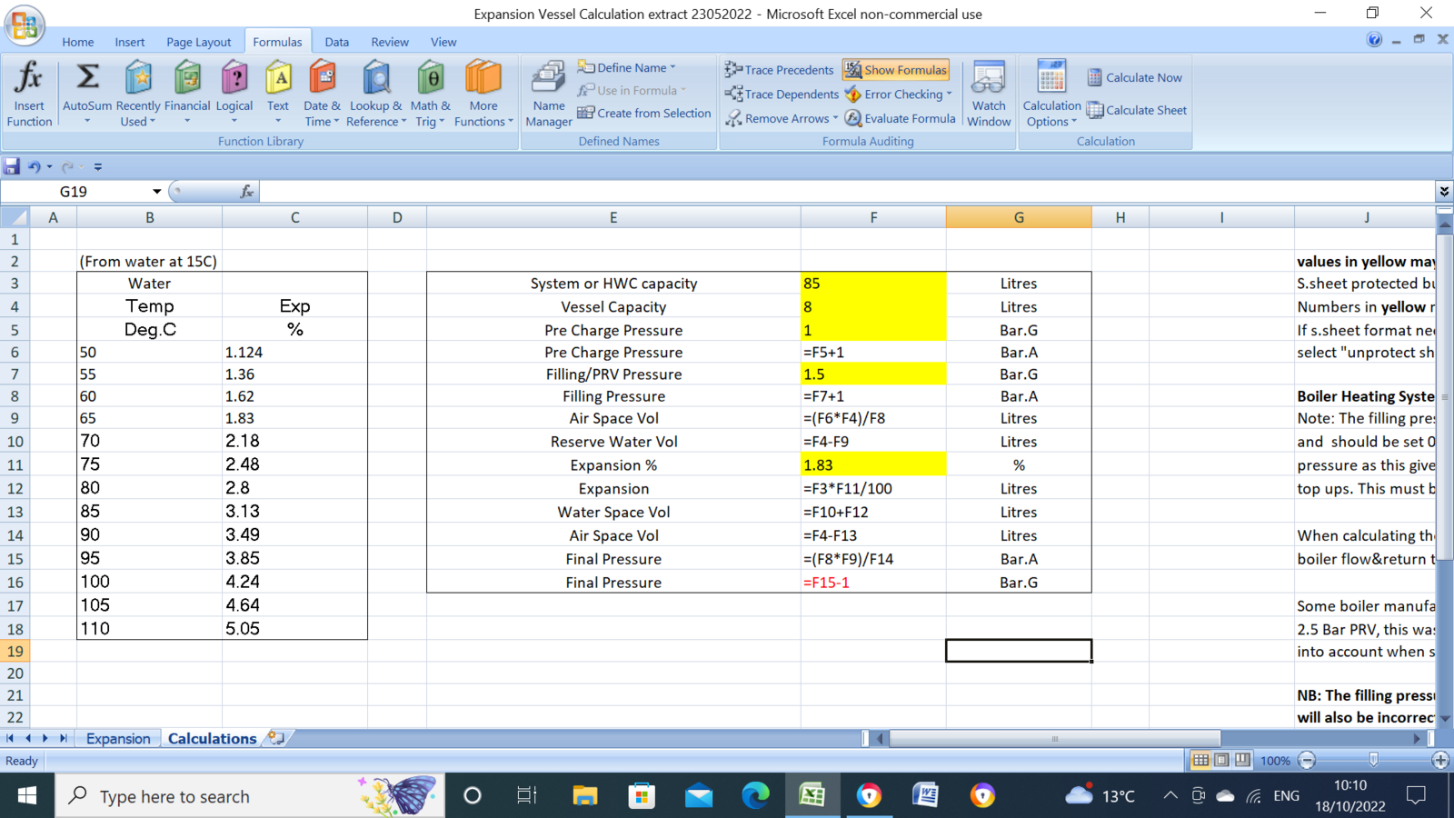

Here are a few calcs that I've used for years, and my metod of calculation.might find interesting.

Pre charge of 0.75bar but do they give a filling pressure?, some but not all boiler manufacturers do give this but others are more coy, reason being that if the filling pressure is the same as the pre charge pressure then the EV can satisfy a much greater system volume, big downside of this is that there is no water reserve to make up for microscopic air bubbles collapsing etc leading to frequent top ups.....people get fed up with this so install a auto fill system which is just a drop tight PRV, if even a very small leak develops then no clue as the pressure remains spot on but it wlll very rapidly lead to corrosion/sludge and pin holed rads etc.
A 6L EV with pre&fill pressures of 0.75/0.75bar will rise to 2.3bar (hot) with a system volume of 154L.
A 6L EV with pre&fill pressures of 0.75/1.25bar will rise to 2.3bar (hot) with a system volume of 81L but with a 1.33L water reserve.
A 6L EV with pre&fill pressures of 0.75/1.0bar will rise to 2.3bar (hot) with a system volume of 113L but with a 0.75L water reserve.
A 8L EV with pre&fill pressures of 0.75/0.75bar will rise to 2.3bar (hot) with a system volume of 205L.
A 8L EV with pre&fill pressures of 0.75/1.25bar will rise to 2.3bar (hot) with a system volume of 108L but with a 1.78L water reserve.
A 8L EV with pre&fill pressures of 0.75/1.0bar will rise to 2.3bar (hot) with a system volume of 151L but with a 1.0L water reserve.
