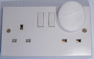

I’ve not come across these type of sockets. Can you provide a link please. Thanks
MK part numbers:
K5830 - 13A BS1363
K5831 - 16A Schuko
K5832 - 15A american style (made to a Saudia Arabian standard, so presumablly intended for markets in the middle east)
K5833 - 5A BS546
K5834 - 16A French.
Scholmore part numbers (replace xx with BK or WH for black or white).
MM010xx - 13A BS1363
MM020xx - 16A Schuko
MM030xx - American style, Unlike MK scholmore list a US standards body, but strangely they list the current rating as 16A.
MM033xx - 5A BS546
MM038xx - 15A BS546
