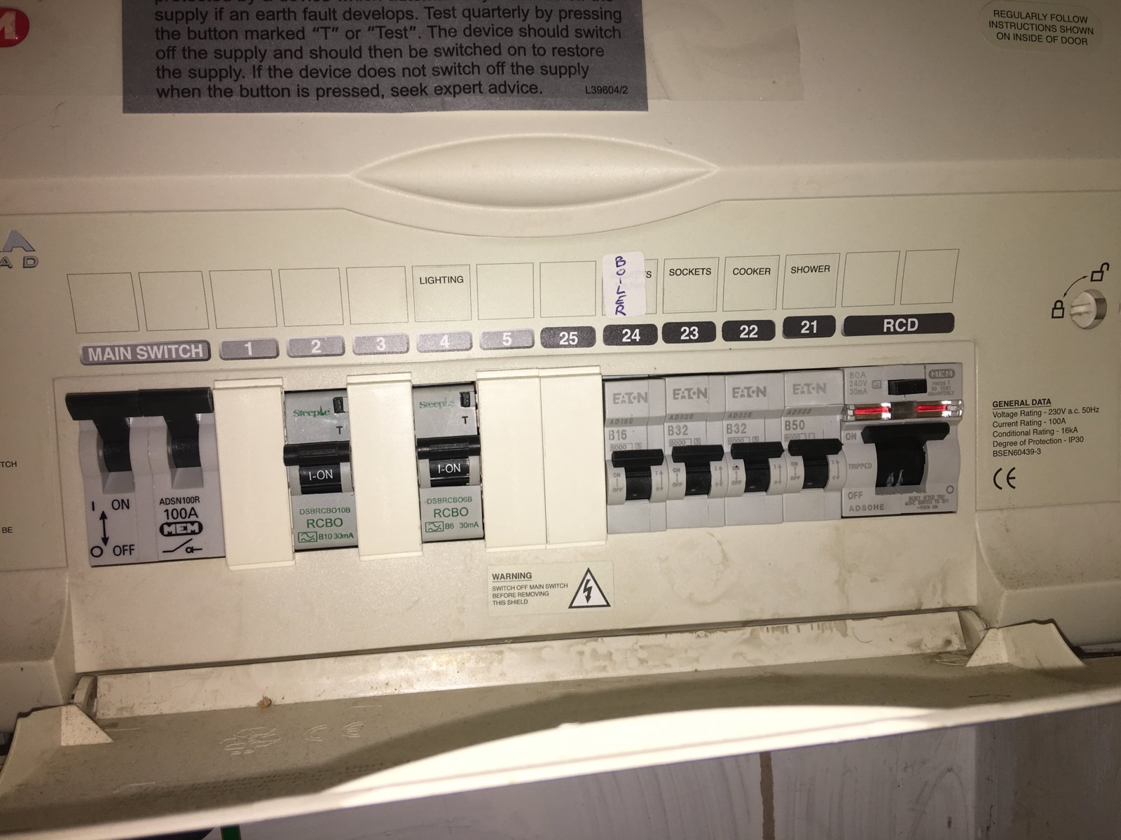

  1. Does one cover a bank of circuits? Have a Test button? Photo would be useful.
  2. That would give useful info, along with the rating of the MCB, and knowing how many conductors are connected to it inside the CU.
  3. See #2 - how many cables connected to it would be useful to know.
  4. Park this until more is known about the socket.
Yes, 1 bank of circuits.
The item is marked B32

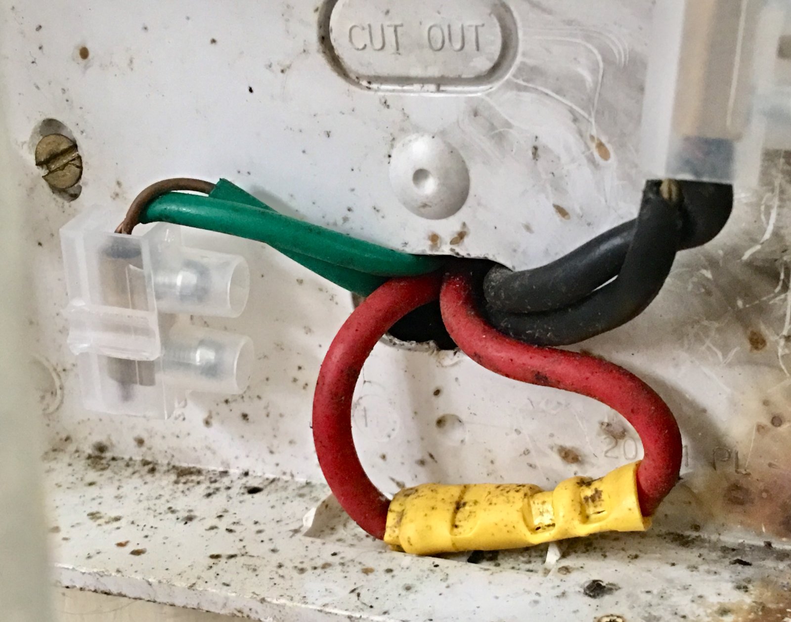

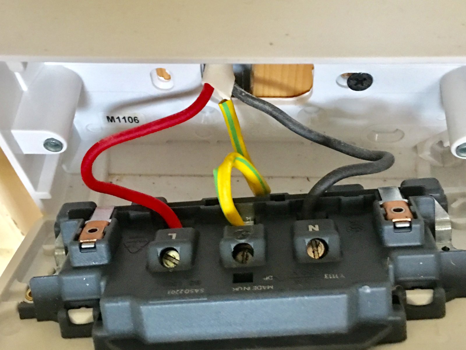

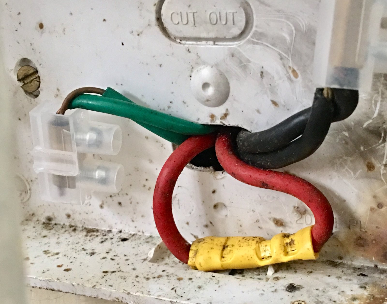

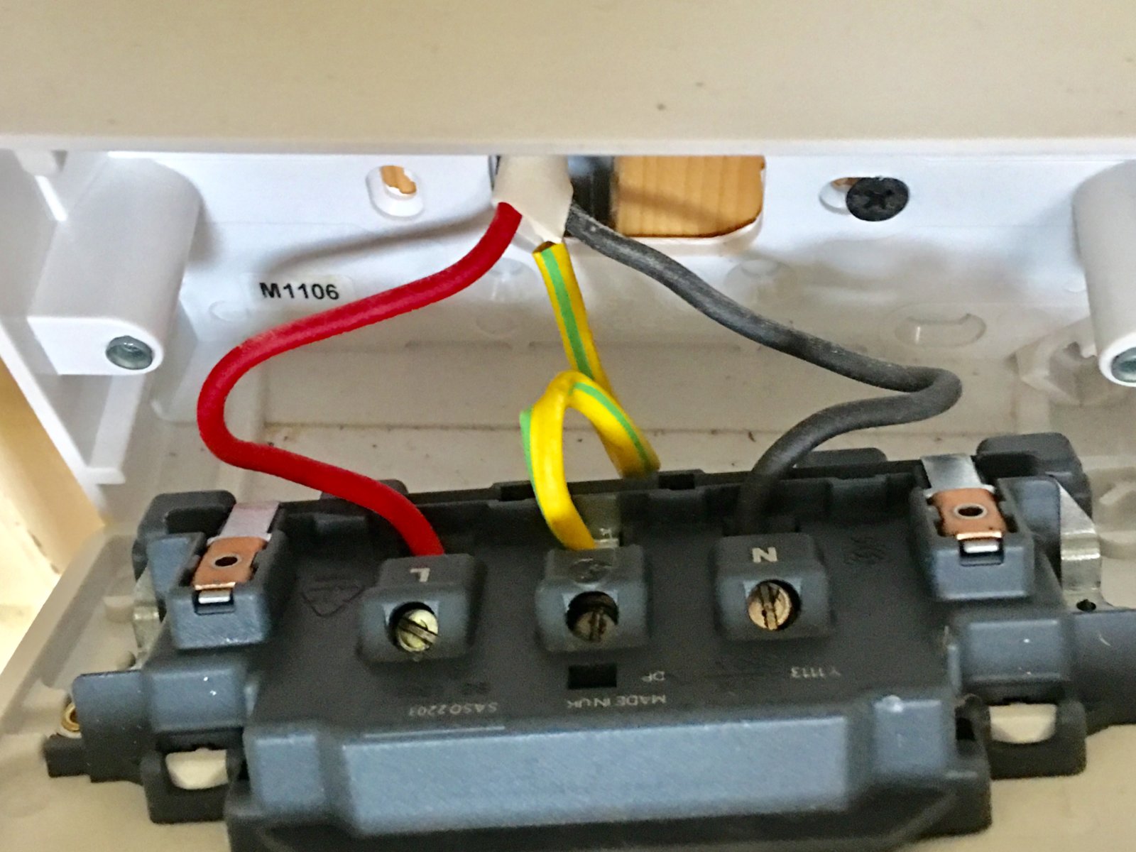

These are the 2 sockets in the room.
As you can see that one of them is joined together with block connectors & has 2 wires of each colour. This socket has a blank cover over it.
The other socket is in use and has 1 wire of each colour.
The item with a blank over it why would that be I wonder ?

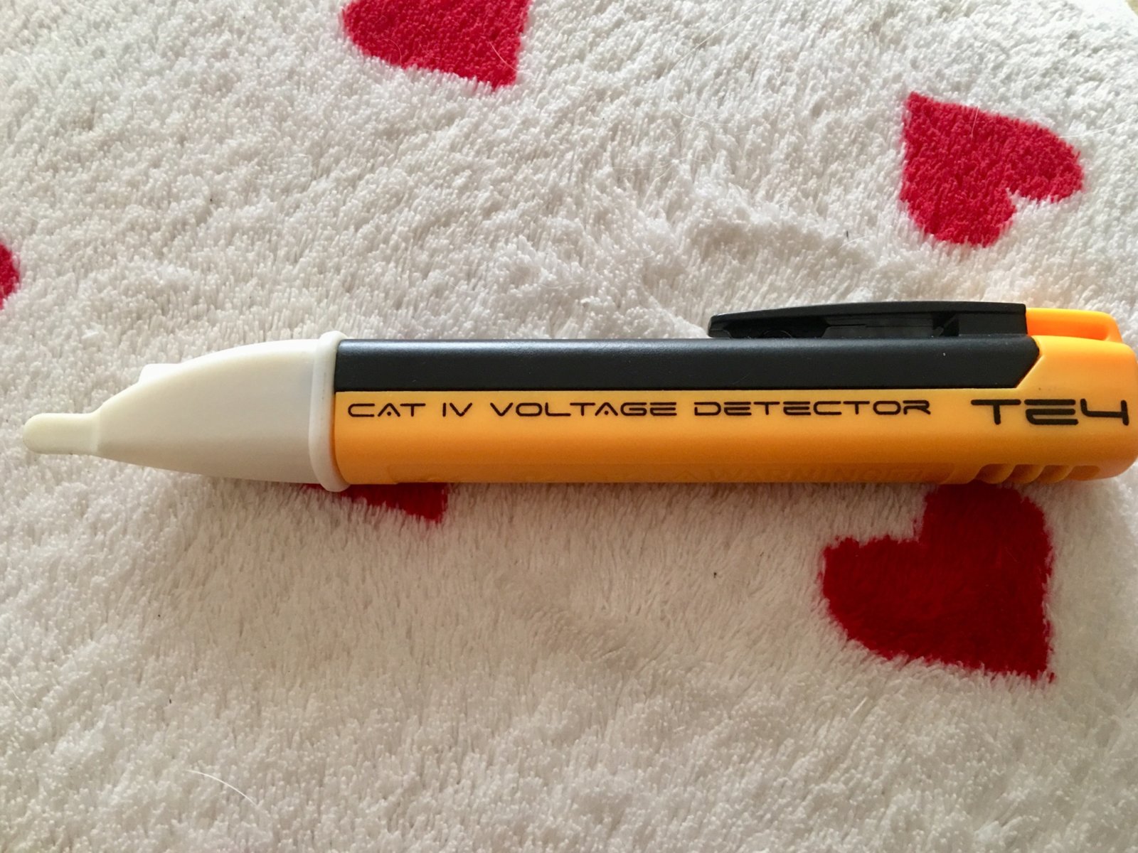

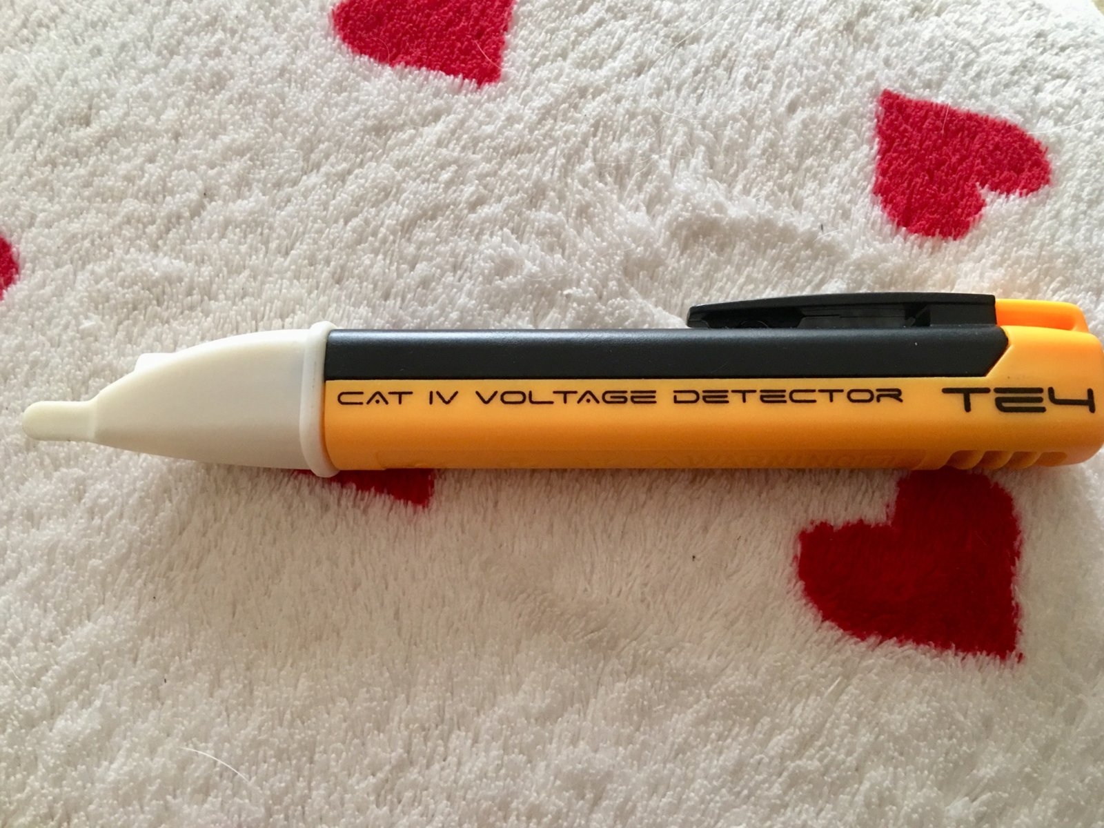

I have one of those electrical tools which beep when you touch the wire.
I will try that in ten minutes etc and let you know the outcome.

Ok
So using the tool in the attached photo & touching the joined red wires in the back box which has the blanking cover on the buzzer sounds.
So if I can just now use a double socket in place of the blanking plate then all will be ok and my original plan would not be necessary.
Question is, why is there a blanking cove on it ?
It could be because only one socket is allowed on a spur and the previous owner wanted it extended to elsewhere.
Are you certain that the socket wire comes from the connectors?
I obviously cannot tell from here but the cables in the two pictures appear to be unrelated and separate.

This cable:
Where's the other end?
Hmm I dont know.
How can i check ?
What if i disconnect the wires in the box with the blanking plate and then see if these wires become dead ?
Please advise

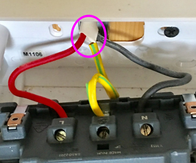

When you say "Are you certain that the socket wire comes from the connectors" are you talking about the wires in the box with the blanking plate ?
Not exactly.
I don't think the other end of the cable connected to the socket is at the blank plate.
The socket cable looks a lot newer than the cables at the blank plate.
If it had been extended then I would think that one of the earth wires would have green and yellow sleeving like the socket one.
Yes, just disconnect the black wires - terminate both safely - and see if the socket still works.
In the box with the blanking plate i have separated the 2 black wires.
This was done when i plugged a lamp into the double socket.
The lamp still works.
So with these 2 black wires separated & the lamp still working tells us that these 2 sockets are not connected to each other.
I assume that is correct ?
So now to put a new double socket in this room can i join my new length of wire "5 meters" into the same double socket connections.
This then means leaving the item with the blanking plate untouched.
