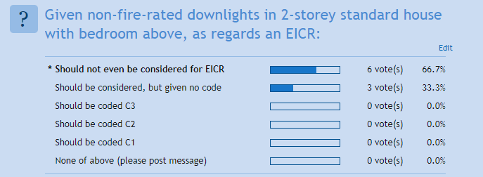

As a matter of interest, I've just created a poll about this issue. Please vote!
Kind Regards, John

... and I presume you've seen the present state of my 'poll'. Even though there are few votes yet, no-one has yet even suggested a C3, let alone a C2 ...
Kind Regards, John
