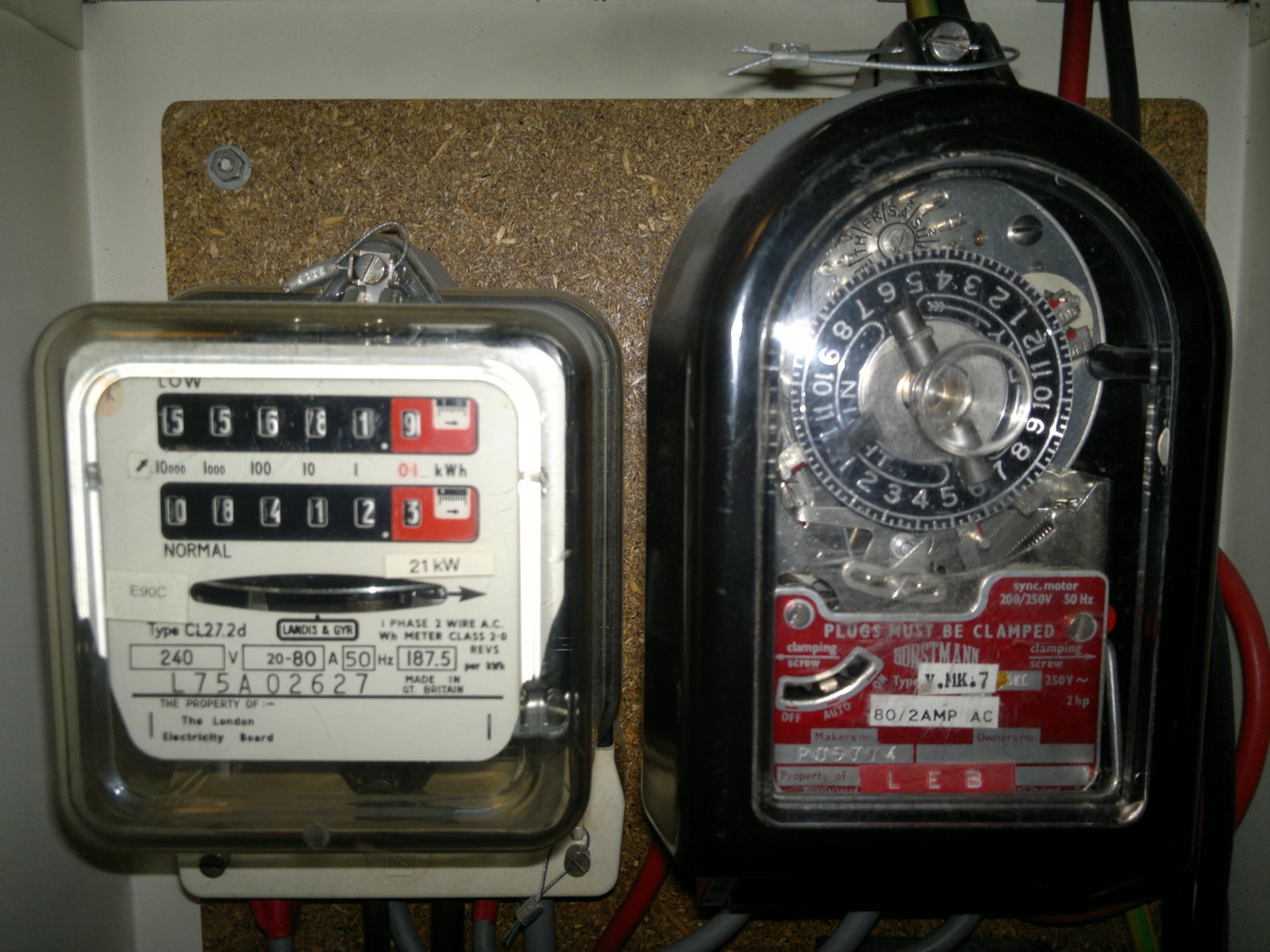

I have an Economy 7 system, the clock and meter are approximately 30 years old. Recently the clock has been gaining approximately 2.5 hours a day – so effectively you never know when the Economy 7 mode is going to be on or off.

If it were the middle of Summer I probably wouldn't care less, but it's this time of year that we've got the E7 heating on. The meter seems to be ok, but the timer (which is a separate device) is faulty.

Sent them this photo, pointing out the seal on the timer and the fact that it has "LEB" sticker on it. Also pointed out to them that if it were my device I could just set the E7 timings to whatever I want, which would defeat the purpose of the tariff.

It sounds as if your problem is not so much with the metering but with the fact that this faulty timeswitch is (directly or indirectly) switching your storage heaters on and off - is that the case?
As far as I can tell the timer switches the meter from the high rate to the low rate. Although it is obviously a separate device, it is intrinsic to the E7 system - ie how does the meter know when to switch over if there is no timer?
When it switches all the electricity in the flat goes through either (one of) the high or low rate, there aren't separate timers/switches for the storage heaters or immersion heater - there's just a separate circuit that gets switched in.
Quite so.
Also pointed out to them that if it were my device I could just set the E7 timings to whatever I want, which would defeat the purpose of the teriff.
Of course, if it were even a half-modern (i.e. electronic) meter, it would not have an external timeswitch, so that issue wouldn't arise. I last had a meter and timeswitch like yours about 25 years ago.
I've just come to realise that this is probably fairly inefficient, as the water and storage heaters could probably be fully charged in two hours, rather than repeated heating/cooling cycles over seven hours.
Yes it does, using neutral switching I recall, low rate comes on as do the heaters at the set time on the timeswitch, that meter looks very old, when was it last swapped?

As I've just written, electronic meters have their own built-in timer.
That's the usual situation with E7 these days - i.e. everything in the building gets cheap electricity during the off-peak period. However, what is switching your storage heaters on/off at the appropriate times 0 that is presumably being controlled, directly or indirectly, by that timeswitch (unless you have a separate one)?
Both water heating and the storage heaters have thermostats to deal with that - they will only use as much electricity as is needed to achieve the required temperature (of water or 'bricks').
