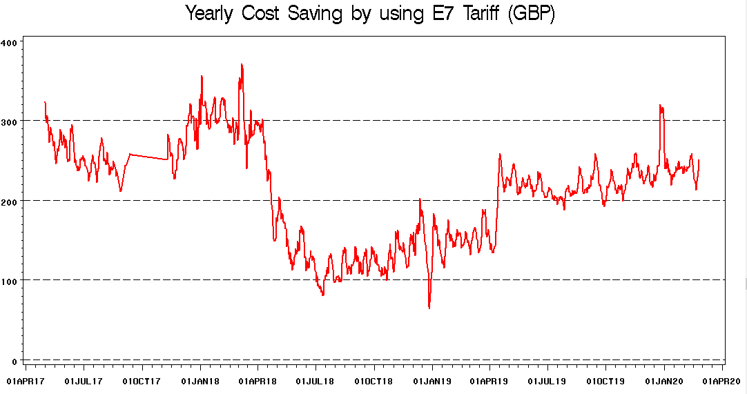

The days of tariffs such as E7 are presumably numbered, and the attractiveness of them has already diminished. Following a period of many years in which the financial advantage of E7 (for some) had remained essentially unchanged, a couple of years ago most suppliers moved their 'night' rate to much closer to the 'day rate', presumably as a consequence of changing patterns of demand during the day/night. As the below illustrates, in my case, that resulted in the saving resulting from E7 (without storage heaters - but I'm unusual in my pattern of electricity usage!) reduced from £250-£350 per year to only about £100-£150 per year. Last April, I partially reversed that by finding one of the few suppliers that was still offering reasonably attractive E7 rates, but my saving is still less than it was a couple of years ago ....

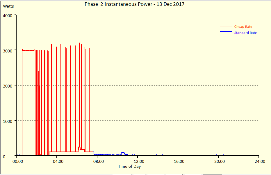

I've just come to realise that this is probably fairly inefficient, as the water and storage heaters could probably be fully charged in two hours, rather than repeated heating/cooling cycles over seven hours.
Both water heating and the storage heaters have thermostats to deal with that - they will only use as much electricity as is needed to achieve the required temperature (of water or 'bricks').
This is the point I made previously, but which you indicated was irrelevant, because the heaters had thermostats. See post #15.
You're right. I didn't read, or taken in, what you had written well enough - my apologies. So, yes, although I'd forgotten/hadn't realised exactly what you wrote, my friend's experience I've just described confirms that what you said was dead right. ... For what it's worth, I currently do exactly that with my immersion heater. Depending on how much hot water has been used, it takes between 30 mins and 2.5 hours to heat up at night. I used to naively have it coming on just after the start of the cheap electricity period, thereby giving it anything up to 6 hours to lose/waste heat (and hence need to be topped up). I now have it coming on about 4 hours after the start of the cheap period, thereby avoiding a few hours of unnecessary 'cycling on and off'.
Apologies again for having mis-read what you initially thought. I read it too quickly and thought that your concerns (which people often voice) were that the storage heaters would be using electricity continuously for the 7 hours of off-peak E7 electricity!
Anyway, now that we are on the same page (i.e. I'm on the same page as you!), the following illustrates what used to happen with my immersion heater before I delayed its 'switch-on' until a few hours after the start of 'cheap electricity' - the timeswitch then 'switching on' the immersion for the full 7 hours of cheap E7 (i.e. the same as would happen using a '5-terminal meter' which did the switching) ...

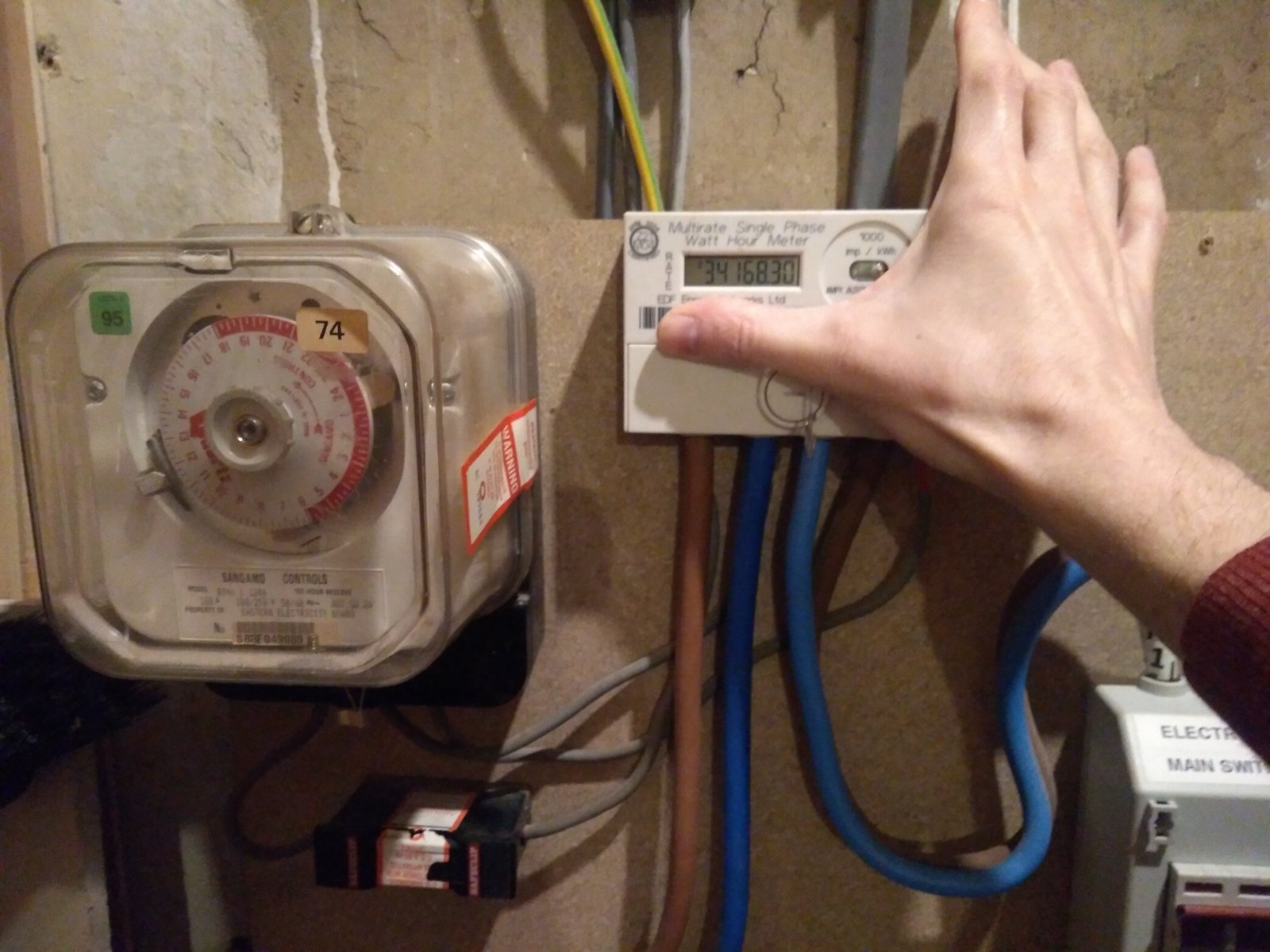

Of course, if it were even a half-modern (i.e. electronic) meter, it would not have an external timeswitch, so that issue wouldn't arise. I last had a meter and timeswitch like yours about 25 years ago.
Not quite correct, Interestingly we have a modern style small white plastic meter with the flashing red led and lcd display, and it's switched by a much older looking time switch which loses time every so often.
I doubt this house was ever on storage heaters, it's had coal fireplaces and gas heating as far as i can tell.
Fair enough - I stand corrected - but I've certainly not personally seen or heard of an electronic dual-rate meter that requires an external time switch. In my case, when we got our first electronic meter, which was 20-25 years ago, the first thing they did was to rip out the electro-mechanical timeclock/switch.
Maybe it doesn't require it, I'm not sure. I did spend a while trying to tell the energy supplier the times were wrong but they hadn't got a clue what i was on about, so i focused on getting them to install an isolator, which was also extremely difficult.
This is the setup, I've blocked the bar code just in case

Indeed so - and manually as well as programatically. As I illustrated in post #51 above, by shopping around suppliers I am even today still managing to achieve an annual saving of £200-£250 by having E7 without storage heaters. However, I'm achieving that by having a very atypical lifestyle and I very much doubt that such a tariff would now be financially advantageous for the great majority of people who do not have storage heaters (or EV charging, as below).

Yes, it was me that 'stated' that. With the vast majority of suppliers, I would now be saving only £100 or so per year (if anything), as compared with the £250-£350 a couple of years ago - I was just lucky to eventually find a supplier last year who still offered something closer to the traditional E7 rates.
For many years, one only had to use 30-35% of one's electricity at cheap rate for E7 to be financially advantages. With most suppliers, that is now well over 40%.
