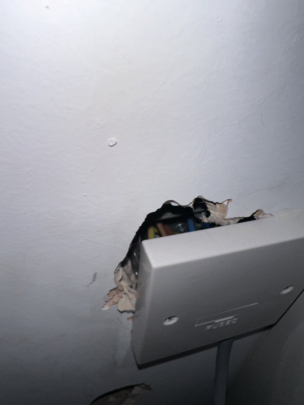

My washing machine has broken… had it over 6 years so not bad.
Pulled it out tonight and unsurprisingly it’s hardwired into an FCU. The washer/dishwasher/fridge freezer all go back to a switch plate.
My new washer is coming with a plug and I’m trying to weigh up cutting off the plug and wiring it in or replacing the FCU with a socket.
Have to say, the initial installation looks shoddy.
I have 2 young children so I am eager to get it fixed but don’t want to go down the wrong route.
I’ll have to disconnect it tonight anyway but the new one will be here tomorrow.

What ever the OP decides to do, it would be worth the OP buying a small bag of plaster, and patching some of those holes.
Thanks guys. There are about 8 holes where it looks like someone has gone hunting for the back box with an hammer after it has been boarded over.
I might be able to tidy up around the socket but I was a bit nervous because the face plate doesn’t sit against the back box. Is this a big problem?
Regarding the space.. good point. I’ll probably have to wait to see the back of the new one to see if it will be a problem.
Think my preference will be to swap to a socket, but if that fails I’ll swap back to the FCU.
Looks like it’s a 25mm back box but the gap between brick is ~40mm so shall i just swap to a 35mm?
That whole thing is such a mess, best rout would be to take the existing box out, fit a 35mm (good idea) and make the gaping hole good with filler. Then the socket faceplate will be properly flush with the wall.
Yeah I will get the space for the plug once the new unit arrives today. If it doesn’t fit I’m still inclined to swap the back box and make it neater.
Yes, good idea, it might also be your chance to move it and swap to socket, into an adjacent cupboard,
