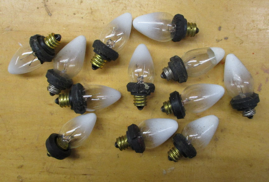

The fuse bulb is relatively recent. They certainly didn't have them when I were a lad. They didn't have bulbs that went short circuit on failure either. It was my job to sit under the tree with a battery testing each lamp in turn.
I don't know when you were a lad, but many of those bulbs I just illustrated are at least 30 years old. I know that since most of them originated from sets I bought a fair while before I moved into my current house, a bit over 30 years ago.
There were, as you say, some sets of lights in the past whose bulbs did not go short-circuit on failure, but they obviously did not have (or need) a fuse bulb, since each bulb acted as a fuse.
I too was under the impression that they are a relatively new "invention". Though I suppose there's a bit of "cheap lamps didn't need a fuse bulb, so they weren't used" - and it's only relatively recently that consumer pressure forced manufacturers down the short-circuiting bulbs and fuse bulb route.
