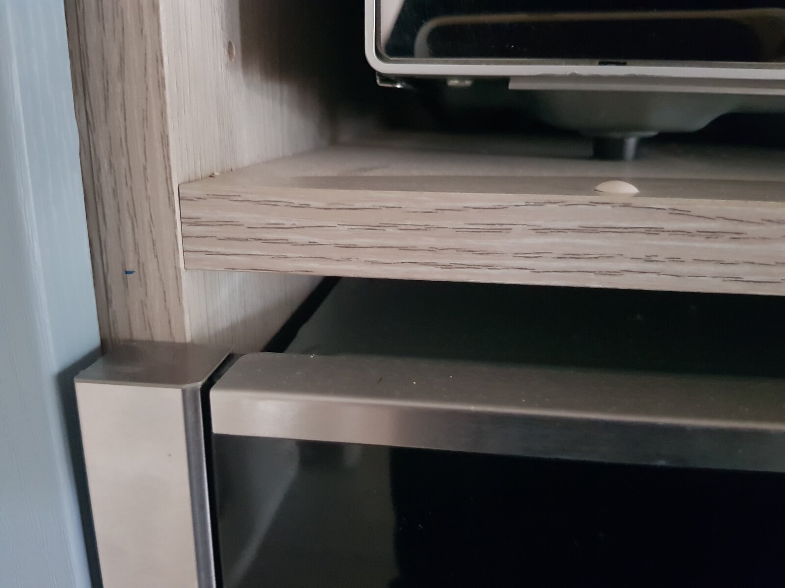

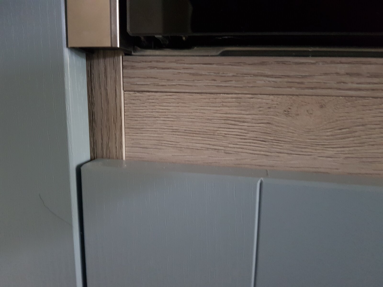

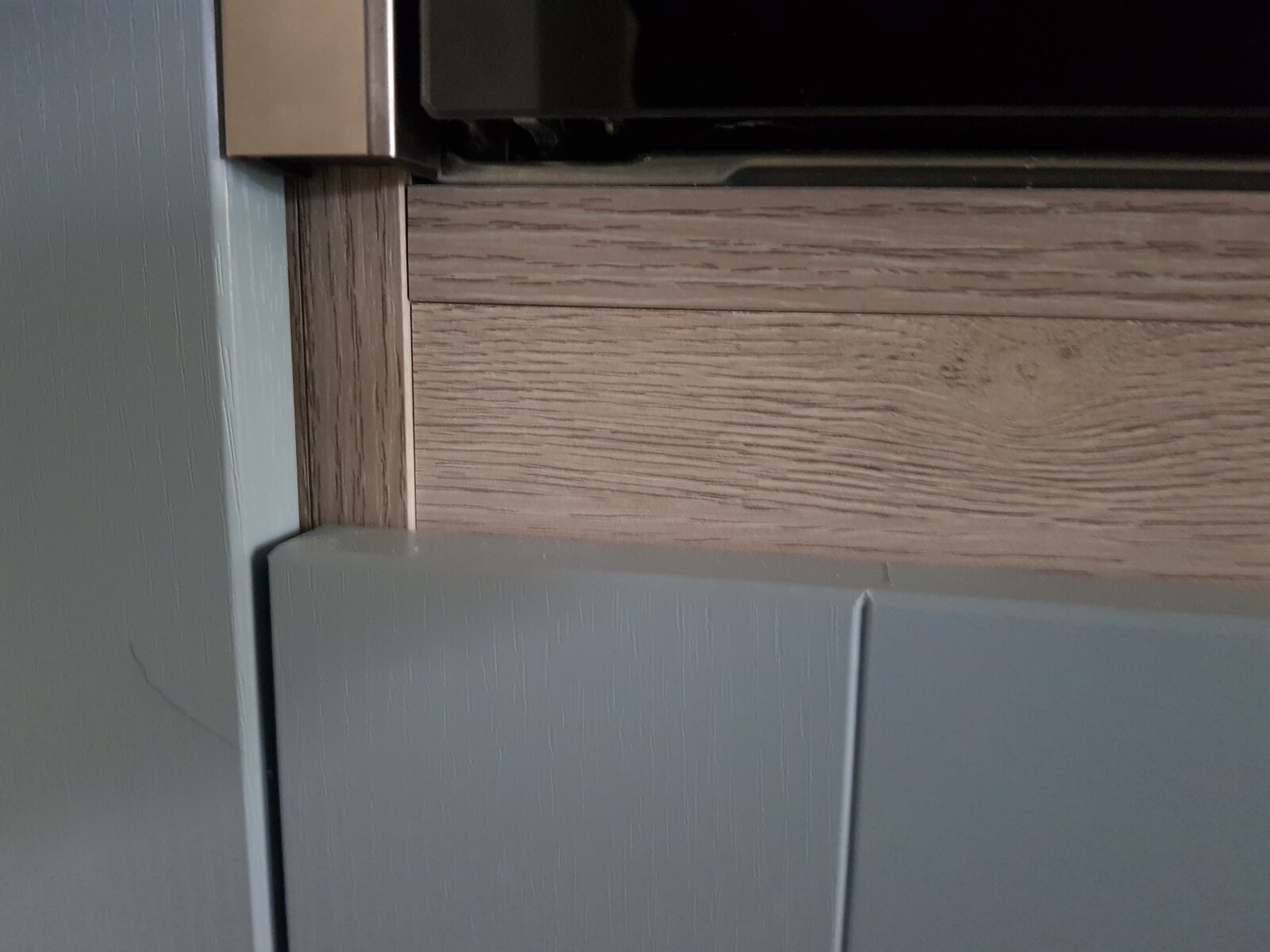

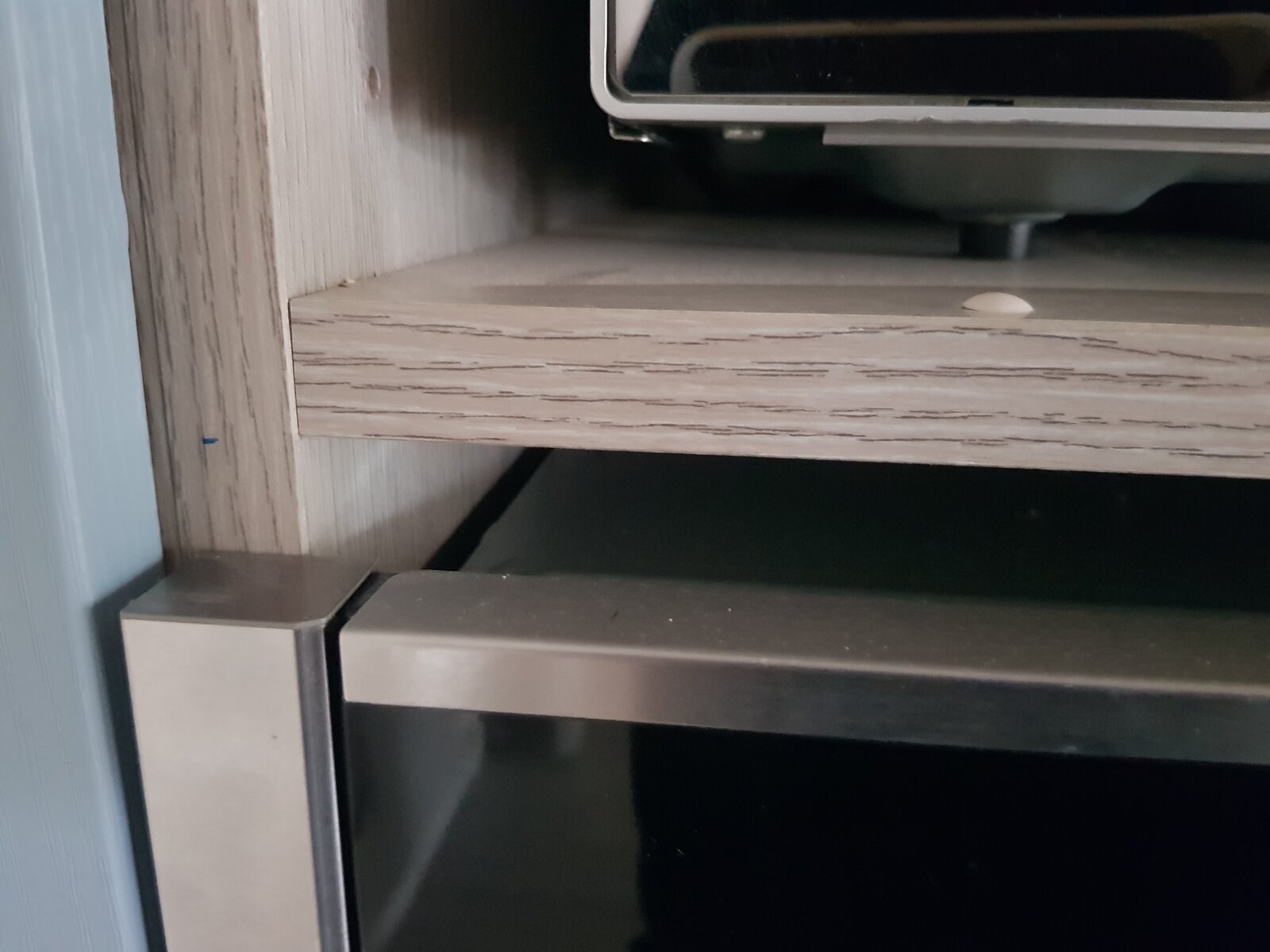

Tower fascia infill panel on top and bottom of front oven. How to fix and support these 2 small fascia decoration front panels?
I'm in a situation where can't use clips. See photos
Beginning to think the only appoach is to use a hot melt glue gun, or possibly double-sided carpet tape
