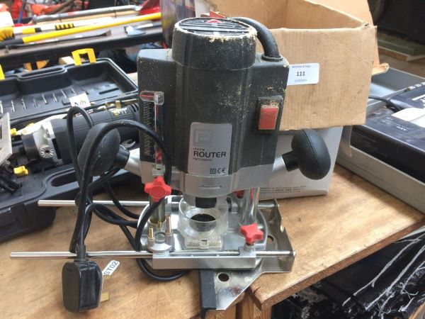

Cheapest I could find on eBay - a "Performance Power 1020R".
Probably totally crap, but it only cost me £23 (£13 of which was delivery to NI), and it should at least teach me something... even if it's just "Get a better router" :LOL:
1000w is just a very heavy 1/4 inch router that will do very very light 1/2" work

It might well do - 1020 watts isn't anywhere near enough, and in any case it's a 1/4in router:
Although it seems to have a 60mm depth of cut (although I am dubious about that, too)
TBH it's a bit undersize and I think I'd be reluctant to put anything bigger than about a 12 or 13mm diameter cutter on that. This cut is going to take some time to do.

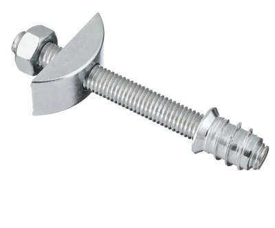

@Roger465 why don't you use bed bolts? That way you won't have bolt heads or dowels visible from the outside of the bed.
I would use two bed bolts and two 10mm dowels per joint.
The other common option if you want easy disassembly is to use bed connectors:
https://smile.amazon.co.uk/dp/B007A...n_i_3H2RR690RXC8MBZ88E18?_encoding=UTF8&psc=1
@Roger465The other common option if you want easy disassembly is to use bed connectors:
Oh that looks like an idea... didn't know those existed :unsure:
Hhmmm... will give that some thought... I'd still have to build the two ends of the bed though, wouldn't I? Maybe I'm wrong, but it just doesn't feel like a good idea to have those holding the ends together, as well as locating the sides... what do you think?
I've made-up and assembled massive shop displays and pub bars which were held together dry with only dowels and kitchen worktop bolts, which are quite similar and work in the same way. You've never lived until you assemble a 7 metre long, 4-piece bar top on the floor that way then lifted it into position (gingerly, I have to admit) without it coming to pieces. I have to say that were I making a new bed for myself I'd probably assemble the end panels with Dominos, dowels or biscuits but bolt to the rails. It's how our current bed is made
