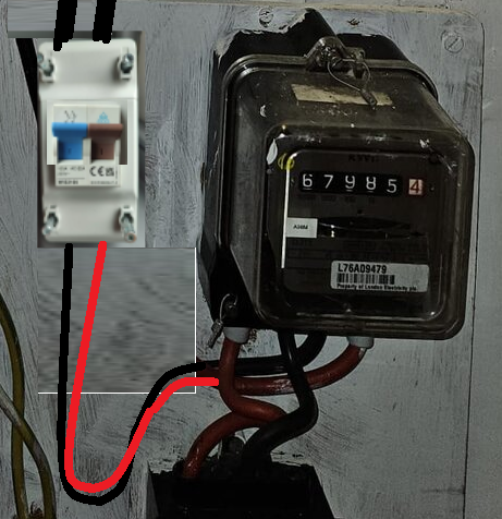

I guess (hope) that your electric meter etc are not in an area where water can be expected! No need to do thios. Straight cables are fine, as is entry from top or bottom. However, all cables need to be supported (eg cleated, etc) to the wall. Not left waving in the breeze, like yours are!
Very old house and unforetunately the main waterpipe from street comes up from the bottom left. The pipe is about 15cm away from the wall so not directly about the Henley block. Have noticed in the winter there is condensation on the pipe and it drips to the floor.
Agree the cables could do with a few clips screwed to the wall...I will add some clips once the meter has been installed.
In reality the switch will be mounted and the existing tails will likely be terminated without shortening so could be more like thisView attachment 347881
The red and black cables are smaller 16mm unlike my 25mm. I could be wrong but the installer will need to upgrade his wires.
Or not.
The suppliers and DNO have different rules and their cables can magically carry more current than yours (are allowed to).
