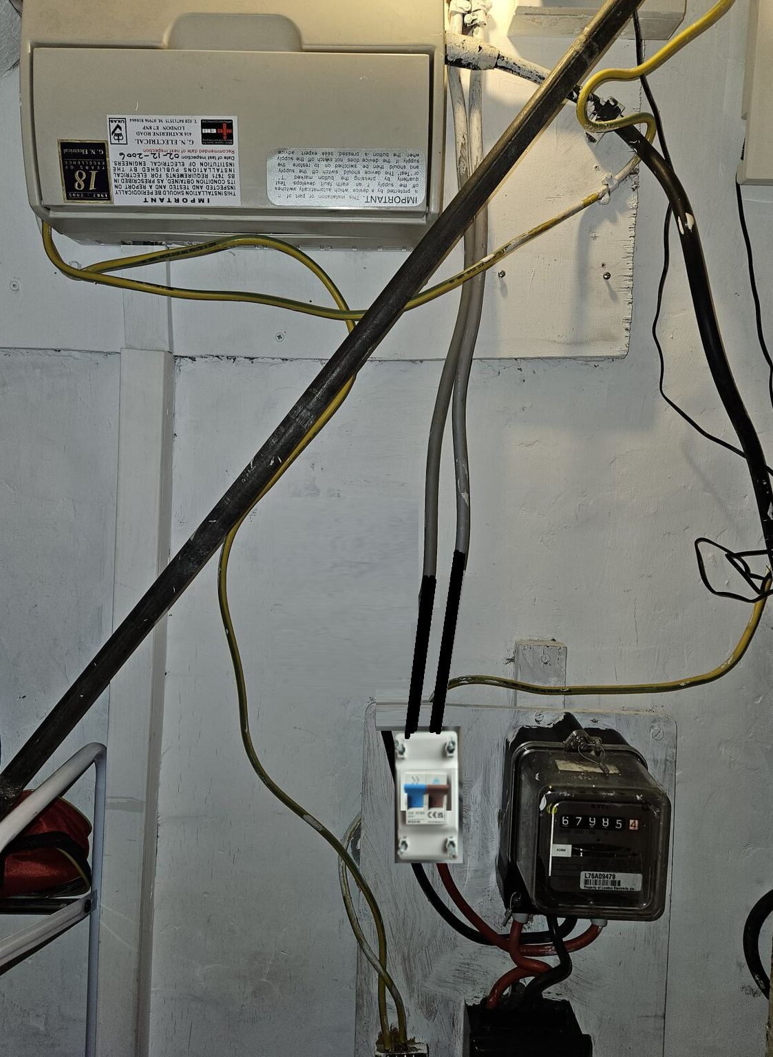

Fitting 100A isolation switch between meter and consumer unit

The switch has never really crossed my mind. But with EV chargers I hear electricians won't pull the fuse once smart meter is fitted because smart meters can detect this and swift knock on the door by a mystery guest.
My CU was fitted 18 years ago when the house was fully rewired. I suppose that will be fine for another 10+ years.
Just an update guys. I got a reply back from the enery supplier. They will include a isolation switch free of charge with the smart meter install.
The meter company is SMS so now to make a appointment

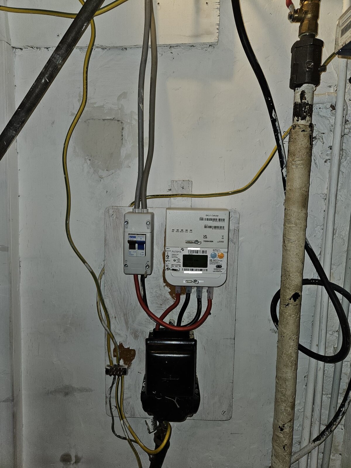

Just an update. SMS metering turned up.
Initially they said the switch is a seperate job and will need to booked by the supplier.
After a quick call to SMS office the switch was installed.
SMS do fit the switch free of charge :giggle:
it looks like your switch enclosure has an access panel over the outgoing terminals, which is a good point.
the supply tails from the meter look poor, as does the main bonding and supply earth connection.
Which is the correct device forthe job and completely normal.
the supply tails from the meter look poor, as does the ... supply earth connection.
It must be fine as the qualified meter fitter did it and signed it off.
