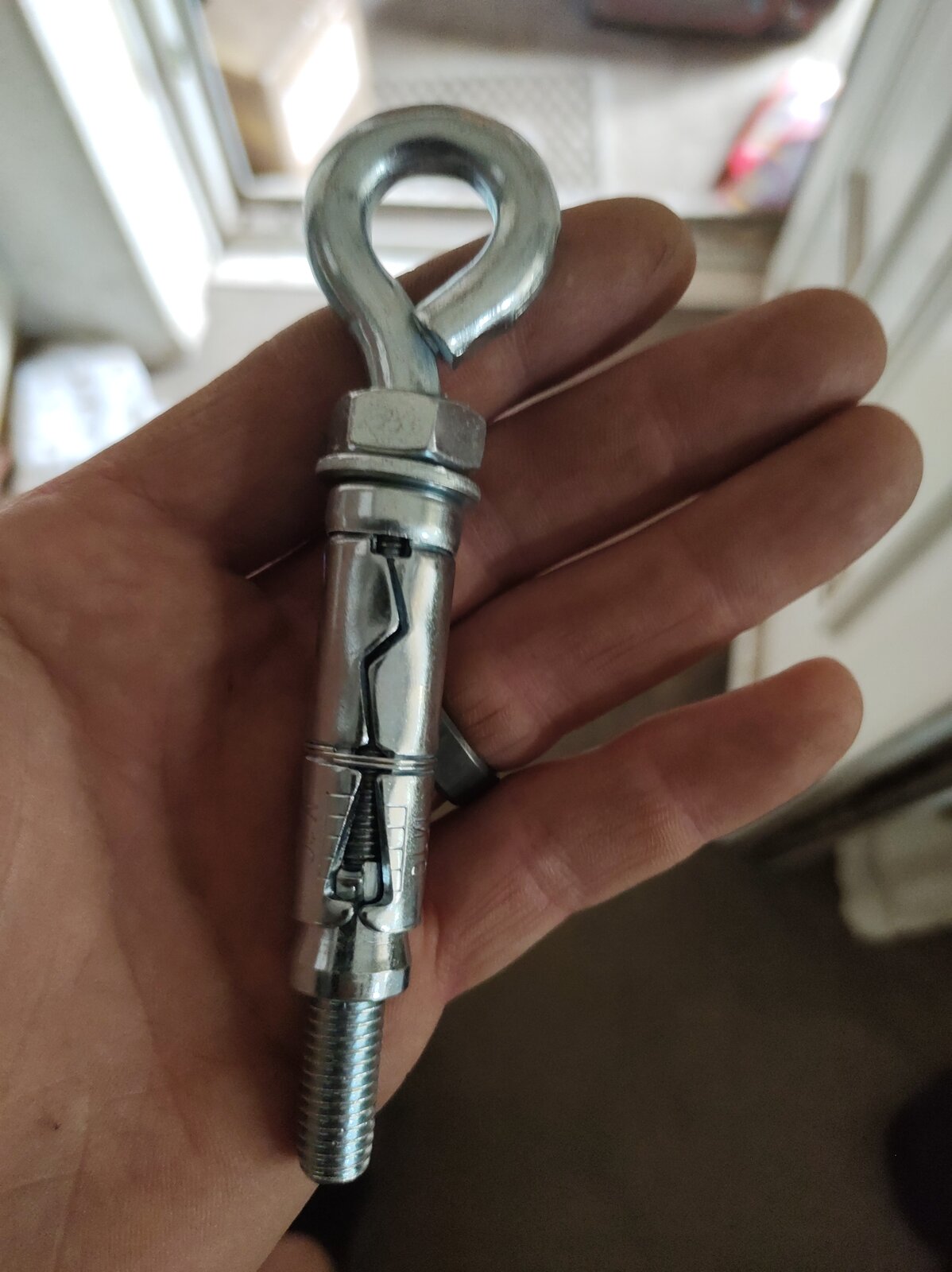

Fixing bolt to wall

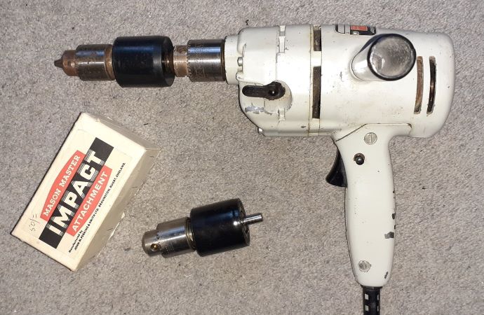

By the early 1960s both Mason Master and Rawl (in the UK) were selling speed reducers with percussive hammer action to work on DIY power drills to DIYers. So whilst I started work in the 1970s using "hand powered" rawl drills which had to be sharpened, I only used them for a year or two (maybe an apprentice punishment - the world was full of that sort of thing back then), I can also remember my old man having a Mason Master attachment for his trusty B&D drill well before that. I have a couple of those early adaptors at home - by today's standards they are awful, but by the standards of the day they were a huge improvement over what had previously been available. The time consuming nature of drilling masonry is why we used to carry a plugging chisel, a club hammer and a hatchet - to chisel-out mortar from joints, chop timber wedges and knock them into the recess in the mortar (they were then sawn off flush with a hand saw)
By the late 1960s some Black & Decker DIY drills began to be available with percussive hammer action, and they were sold alongside "blunt" (actually 5 to 10°) carbide tipped masonry drills which I recall had to be sent away for sharpening - because the green grit abrasives required for sharpening them were still relatively uncommon (and required an expensive bench grinder). Bosch and Hilti changed the game completely by introducing the SDS drill in 1975, and by 1985 it was in use by many tradesmen, but the carbide drill tips in use on that are fundamentally the same as the early post-war carbide masonry drill bits.
So for anyone to have used sharp (i.e. non-TCT) masonry bits, they are probably going to be very old...
Edit: This is for @Harry Bloomfield :
Two Mason Master impact attachments, one brand new with the pre-decimalisation price of "50/=" on the box (so £2/10/-, or about £2.50 in today's money - we went decimal on 15 Feb 1971). These were quite expensive when you consider that the Black & Decker D.520 2-speed drill with them in the photo was listed at about £10/15/- (£10.75) at the time, and in early 1972 I was earning something like £12 a week, pre-tax, pension and NI

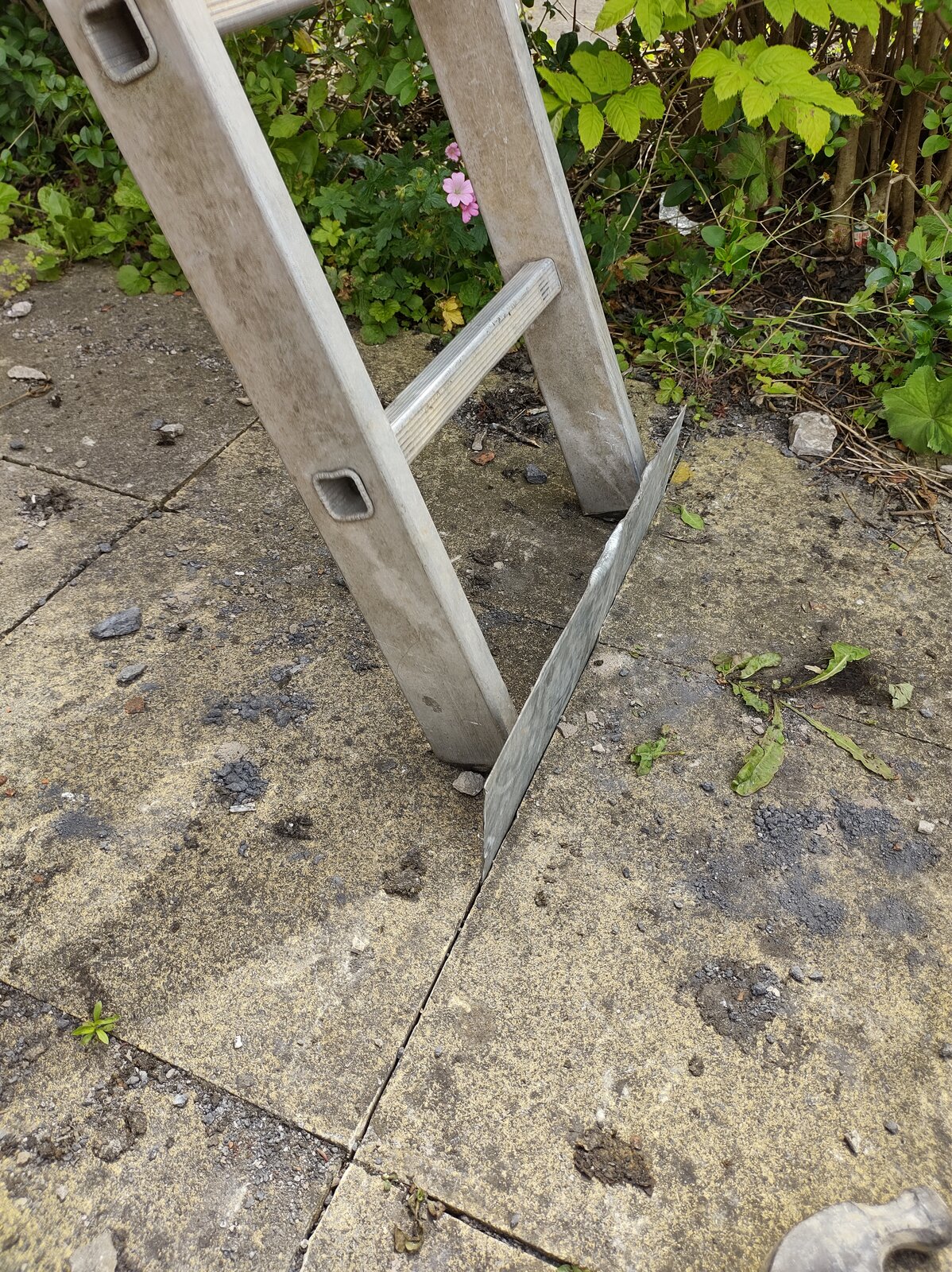

Ladder far more secure now but I think I'll Invest in some ratchet straps as well for convenience:
The now redundant "base stop"

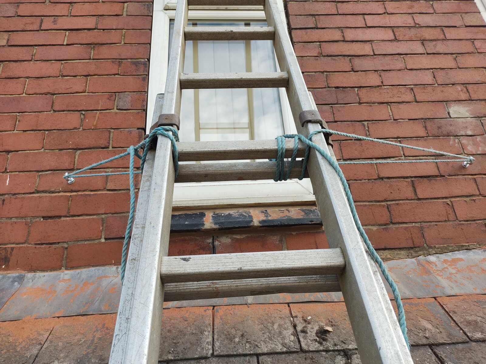

And the initial problem showing why a standoff at the top wouldn't work (I needed to rebuild the brick window cill and my arms aren't that long) and why it wouldn't work anywhere else on the ladder:

Yes, that was exactly the intention. I wanted a blob of resin on the internal exit of the bolt. I consider merely gluing the bolt to the smooth hole surface to be inadequate. In fact, I think that's a bit dumb. The blob would act like a securing nut for the bolt. That bolt cannot come out except when the brick itself is coming out, or destroyed. I didn't care how much resin had gone into the back because I had no further use for the resin. I used a total of 100ml or 1/3 of the tube when it overflowed the hole.
The chosen resin is the correct one because it worked, at an acceptable price point, and has the strength spec I was looking for.

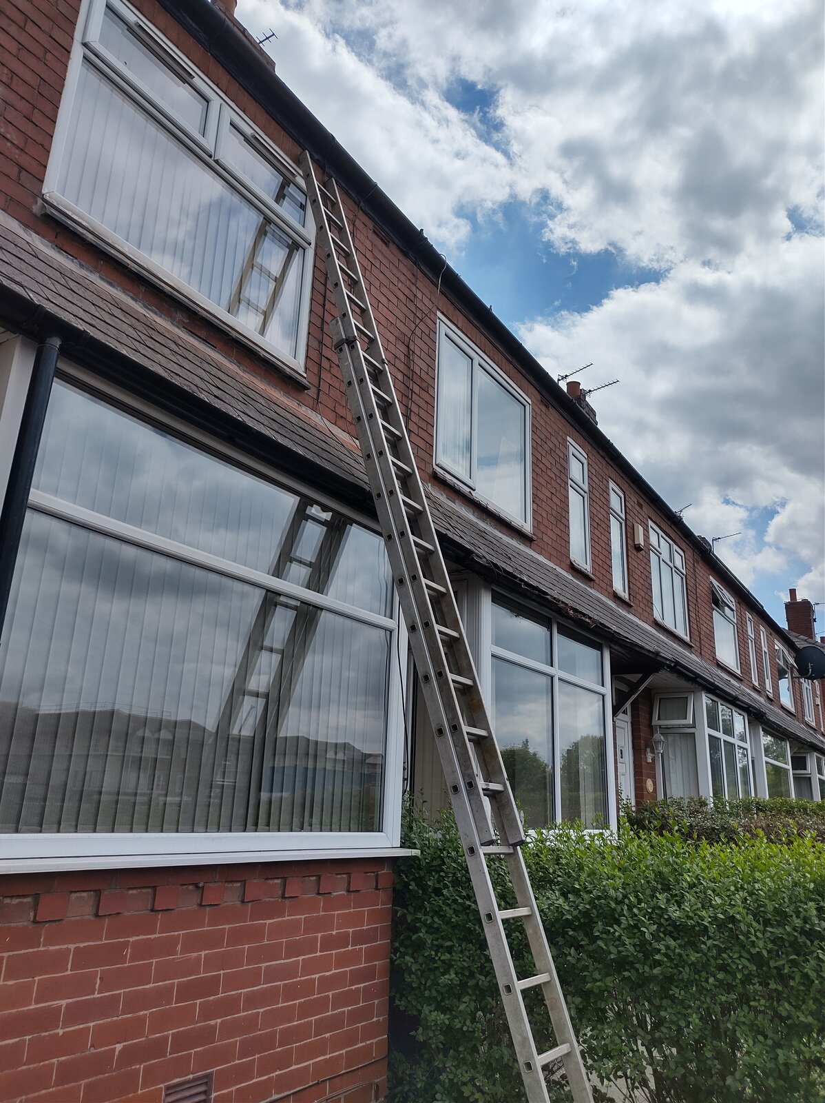

Looks to me a stand off would work below the cill. The top of the lader should be around that level.
