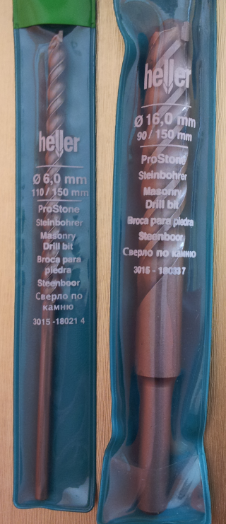

I can't see how blunt they are but Heller make very good drill bits.
Blunt enough to be useless without hammer action. Even adding water won't do a thing. The multi-purpose bosch blue painted flutes are better. Those are sharp enough to drill metal - meaning drilling without hammer action is possible even if not perfectly effective. Those are beyond my price range.

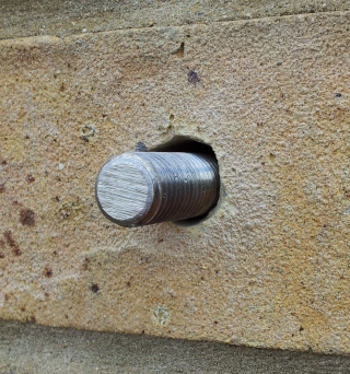

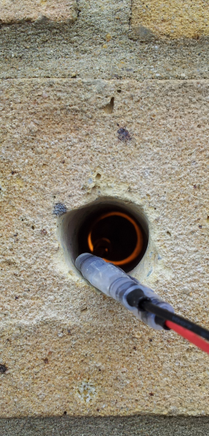

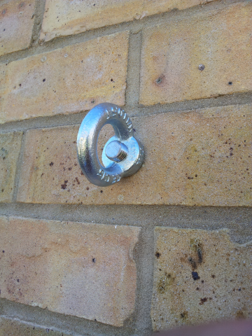

Hole done. It was drilled from 4mm up to 10mm in 2mm increments, then a big jump to 16mm. The jump was a lot more challenging, the rest was easily piecely. The brick was ground into a very fine powder. It would have been a lot easier if I was able to extract the powder. In my impatience, I didn't bring any water, nor did I switch off the hammer action. I did ease off hand pressure as I approached the punch through. Using a proprietary blowout gauge, I estimate the blowout to be 5mm deep. I could probably do better if I used water and had 12mm and 14mm drill bits.
I drilled into the brick's center cavity that was filled with mortar. Behind the brick was rock wool insulation. The wool kept the blowout pieces nearby and I was able to vacuum them out. The wool will likely help me keep the resin nearby when I come to fill the hole.

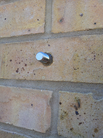

Anchor completed with vinylester resin. The resin had crazy short working time. Even keeping it in the fridge overnight didn't extend the time by much. The wire looking thing is just a proprietary stick-out gauge to help setting the correct depth for the bolt.

The heller I have didn't drill but ground the brick to powder. The tip edge was so unsharp, it was round. But, I don't care, as long as it works and cheap.
True masonry drills aren't designed to cut in the same way that twist drills are - in fact they don't drill at all, they are specifically designed to be hammered against the masonry, creating chips or dust which is then removed by a combination of the rotary action of the drill and the spiral flutes of the drill bit body. That's why the carbide tips aren't sharp, and never will be. Using a masonry drill without hammer action means that you are converting it, in effect, into a scraper - and it will get very hot. Throwing water onto a hot brazed carbide tip can cause the brazing which holds the tip in place to fail, and the tip will simply fall out, so it isn't conducive to long drill bit life.
The blue Bosch Construct drill bits are a composite design which are designed to work passably well in a wide range of materials, but the hole quality with them in metal and wood is only just acceptable for many purposes (put it this way, you wouldn't try to drill engineering grade holes in steel with them) and they drill fairly slowly in compoarison to mor specialised drill bits
Most resins used these days are 2-component types which are mixed in a spiral nozzle. With those you don't need to chill anything because it makes no difference. The resin only starts to go off after you've mixed the two compounds in the nozzle, but at the end of each session you do need remove the mixing nozzle sharpish and cap off the resin tube. These nozzles are 50 to 70p a pop and each time you do a job they are obviously toast, so you try to do as many anchors as you can in one session. I haven't seen the old glass vial type anchors for years.
The points made earlier about blow-outs at the back of brick is very valid - the one thing you don't want with resin anchors is to drill straight through a brick or masonry so that there is a void at the back. Do that and with gun resins and you'll just end-up pouring expensive resin into the void - so you should always stop short of drilling through. If your rod sticks out too much at the front once the resin has set you thread a nut onto it, cut the rod short with a grinder or hacksaw, file a chamfer on the edges of the cut then wind the nut off (to reform the thread).
And a minor point to make about resin anchors - whilst they can be used with threaded bar, the thread ideally needs to be a course pitch. The hole in the masonry should also be 2mm larger than the thread - so for an M12 thread you drill a 14mm hole. Bigger than than and you just waste resin, smaller than that and you run the risk of a "dry hole", where there is insufficient resin to bond the bar in place adequately. Lastly, resin anchors don't always "take", so once they have set fully (24 hours) it's always a good idea to test them before you depend on them

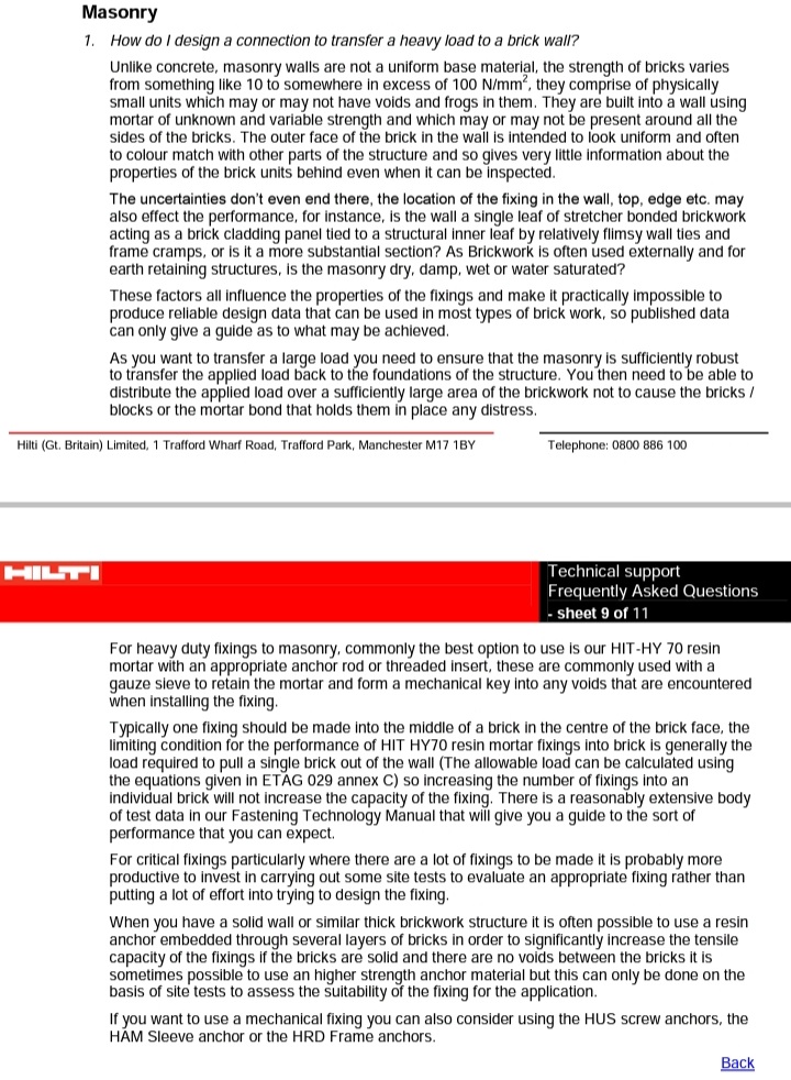

I've found chemical fixing manufacturers are reticent to give pull out forces for masonry walls; given the unknown quality of construction - the chemical anchor may not budge an inch, but it doesn't mean that the brick won't be pulled straight out of the wall! ;)
Example from Hilti:
That's not correct. The Rawlplug hybrid resin I used was temperature dependent. At 15C ambient, the working time was 5m, at 25C was 2m. The temperature at the moment of application was around 17C. Miraculously, the pre-cooled resin probably gave me 5m. I had not a second to spare when I was surprised it had gone off. But fortune favoured me because I had completed what I needed just in time for the surprise.

What a professional installer understands is that for resin installation you try to avoid drilling through the back of the brick, unless you are aiming to inject resin into the skin behind that - a rare occurrence. You invariably try to avoid having a void at the end of the hole, because you can end up pumping a lot of resin down that hole and still not getting a reliable fixing. So there should be no blow-out, because if you are doing the job properly you wouldn't drill through the back of first skin in the first place
As I stated it, with reference to 2-part resin anchors, the most commonly used in general construction, what I stated is correct. You install one resin anchor, seemingly badly, and that makes you the world expert?
To my mind selecting a resin which goes off so rapidly, when you have never installed a resin anchor before, then having to ****** it by fridging the product, smacks of you having not got hold of the product sheets and read them before commencing the job. Because if you had maybe you'd have chosen a different product. But then you drilled through the back of the brick and argued with an(other) experienced builder that he didn't know what he was talking about when he told you that was wrong.
