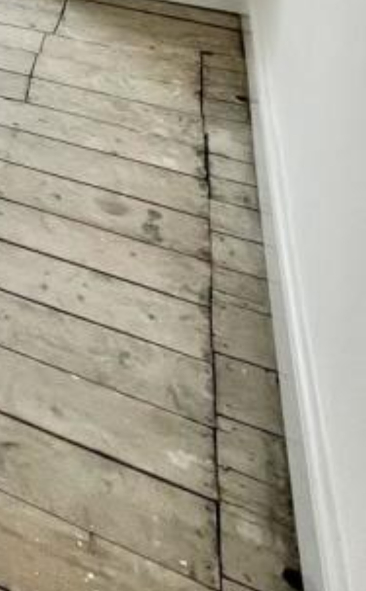

A 3rd of the floor in the bedroom (pic in first post) would need to be levelled off towards the wall pictured with the cut boards too.

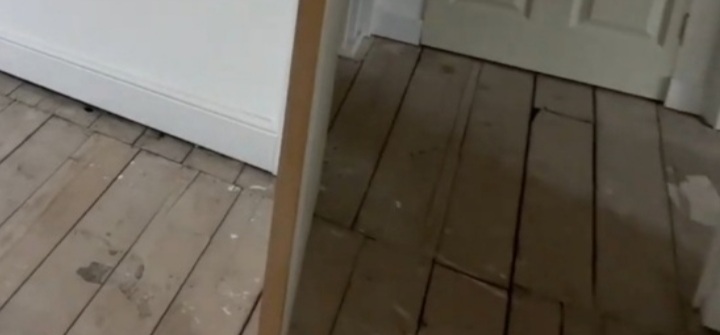

As I've said throughout, (... and this is another Victorian South Wales terrace with the same layout as mine :) ) - I bet my bottom dollar that the landing floorboards run under the wall with a joist on the line of the 'cuts' and another joist just the other side of the wall!
Whether the weight of the wall supported by those cut floorboards has caused the deflection of those two joists is another question. My boards are staggered, so there are some long and short boards going all the way into the next room.
I am happy to be proved wrong, but I would just warn the OP that this is how my house works and this might be what to expect! ;)
Some do, some don't. there is a great deal of variation I've found
I somehow doubt it unless the joists are very undersize, The floor boards would ensure that the weight of the wall is spread across a number of joists unless they were all cut at more or less the same pointy, near to the wall
One thing that is for certain. though - getting extra supports in beneath a wall like this is hard work and a common job to undertake on terraced houses, especially when re-locating walls
That's my point, unlike my house where the boards are staggered across the floor, this house has short boards across the landing, with all the 'cuts' in the same place:
I suspect the weight of the wall is only taken by two full joists and whatever magic supports the half landing outside the bathroom! :)

Why would they have cut the floorboards like that? Or were they laid like that originally?

I went to look at the house with my mate. Floor def leaning. Like being on a ship! Lol.
Looks as if the boards from the landing go under the wall and into the bedroom. No idea why the boards have been cut like that in bedroom unless thats original! (See pic in post 1).
The floor slopes a little in the bedroom towards that same wall.
To me, i think he needs to put something 'onto' the floorboards to level them out (after taking skirting off etc).
Otherwise it means cutting the floorboards up against the wall either side and sistering joists? Too much hassle maybe?
Boards are original, not cut, it's just they used full length boards in the bedroom, and the gap that was left was filled in over to the landing.
