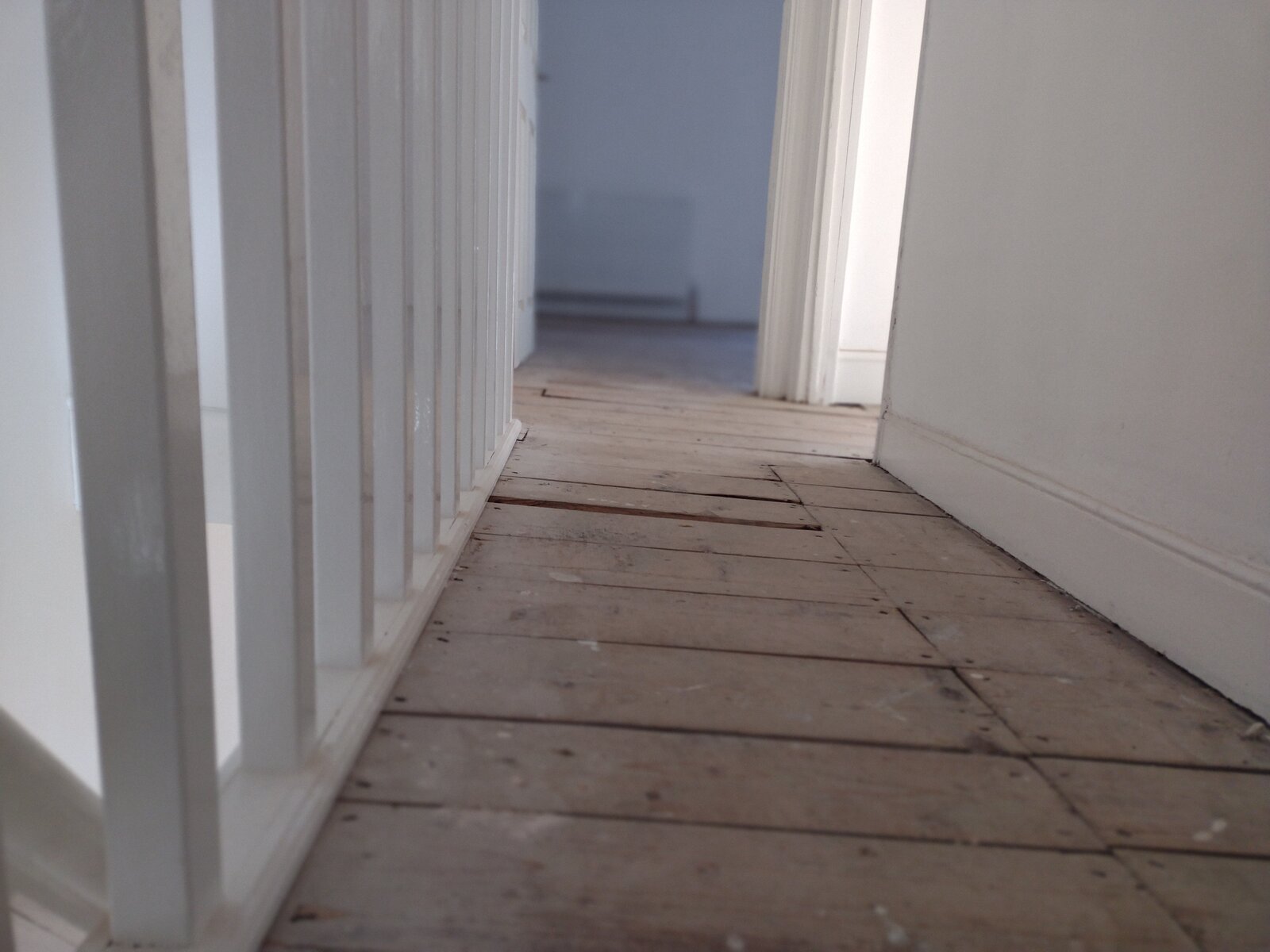

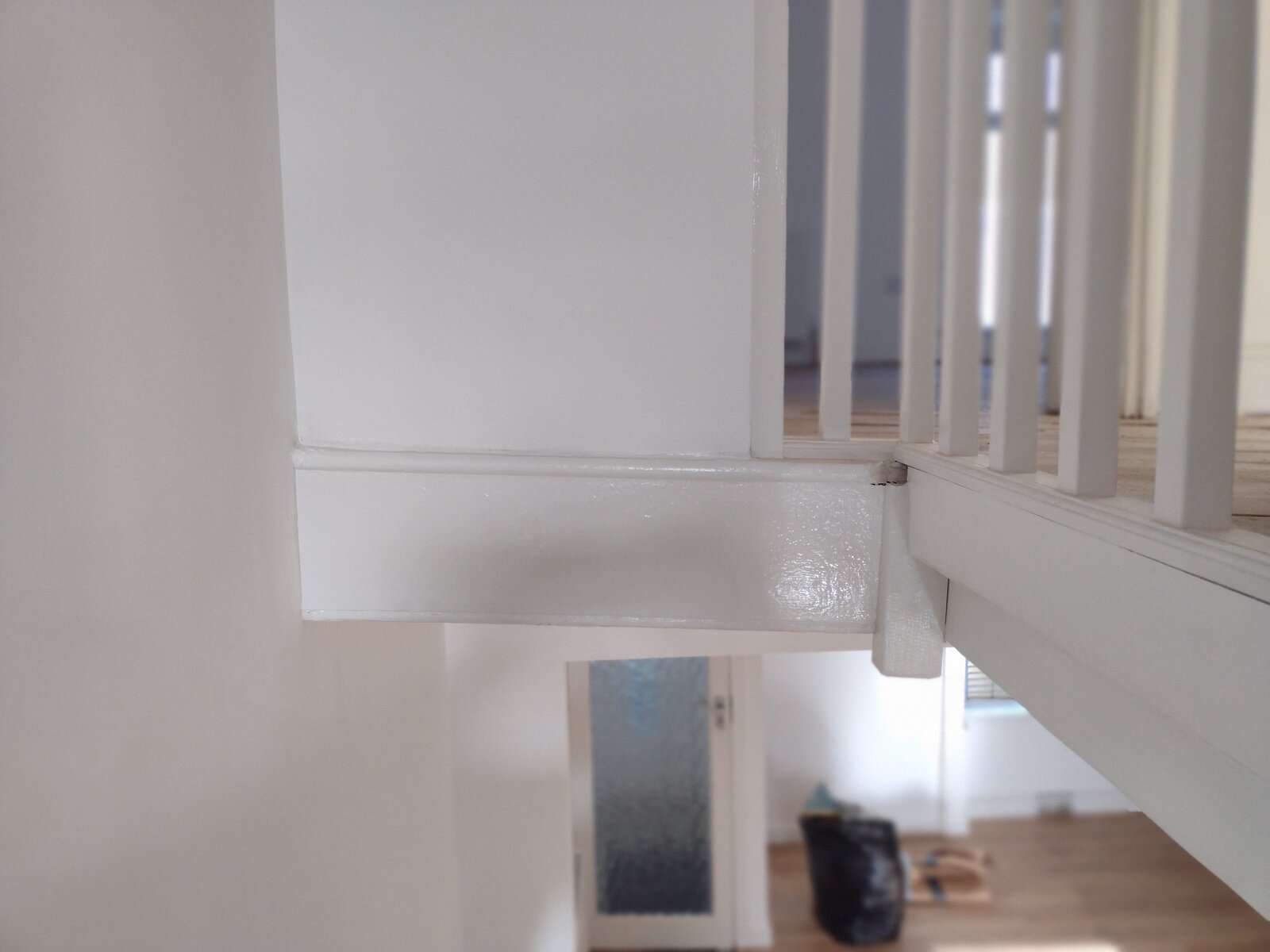

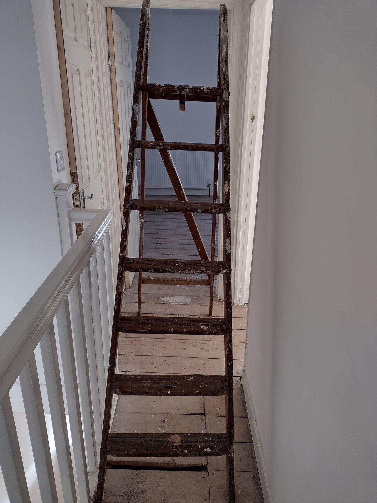

Went there today to give mate a hand...
See the big slope on the floors...
Its out by 3" in the middle of the rooms
Builder going to strip floors and level etc in a few weeks..
Whoever renovated the house a year ago must have wore a massive stetson!!!!
Ceilings look unlevel too in living roon!
