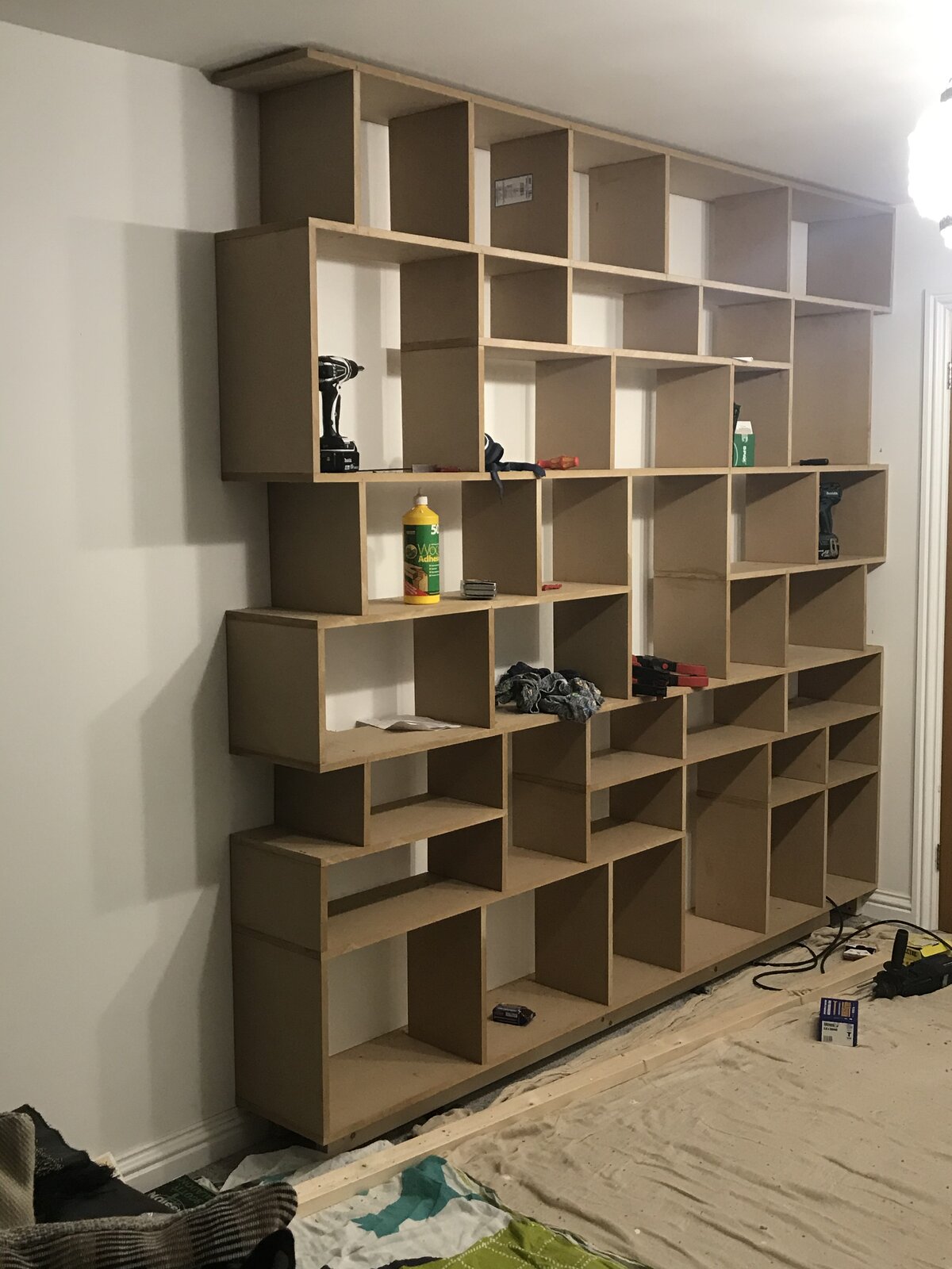

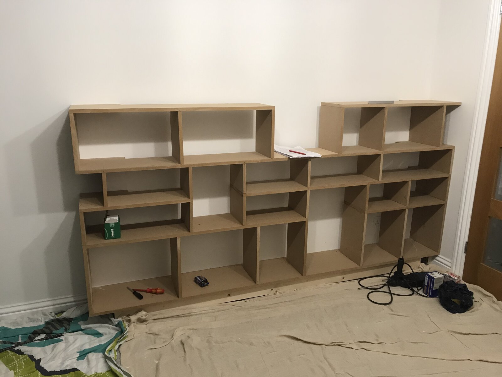

I am building my unit in place. I no longer need to worry about moving the unit into place. Since the last pic, I have made some further progress:
Thought I’d clarify as this may provide some further options.
Also, on the subject of caulk, can I use this on the bookshelf joints before panting? There are some hairline gaps between some of the joints and was wondering if I can finesse these before panting.

Few bits and pieces left before I begin the painting
On the top row, I measured the distance to the ceiling and as it was sloping down one side, I cut the uprights to suit. This meant that I have a uniform gap at the top.
