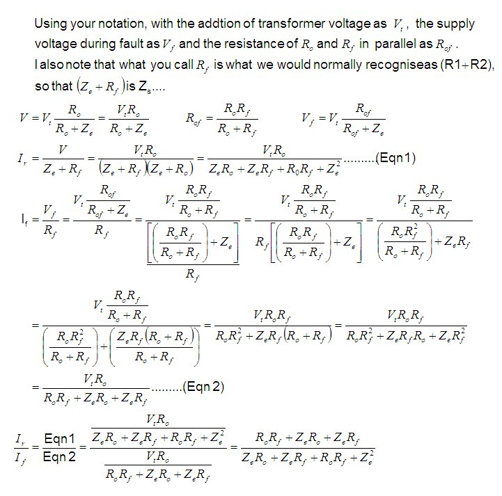

I have attempted, in haste, to reproduce your equation, but I don't think we can both be right, because I can see no way in which yours could be simplified to become mine! In view of my haste, it is very probably me who is wrong, so maybe you can spot the 'deliberate mistakes' in the following (I'm not sure how readable it will be when posted; if it doesn't look good after posting, I'll try a 'Plan B').
Kind Regards, John
Edit: it looks fairly readable to me, particularly if zoomed - but if you have a problem, please let me know.

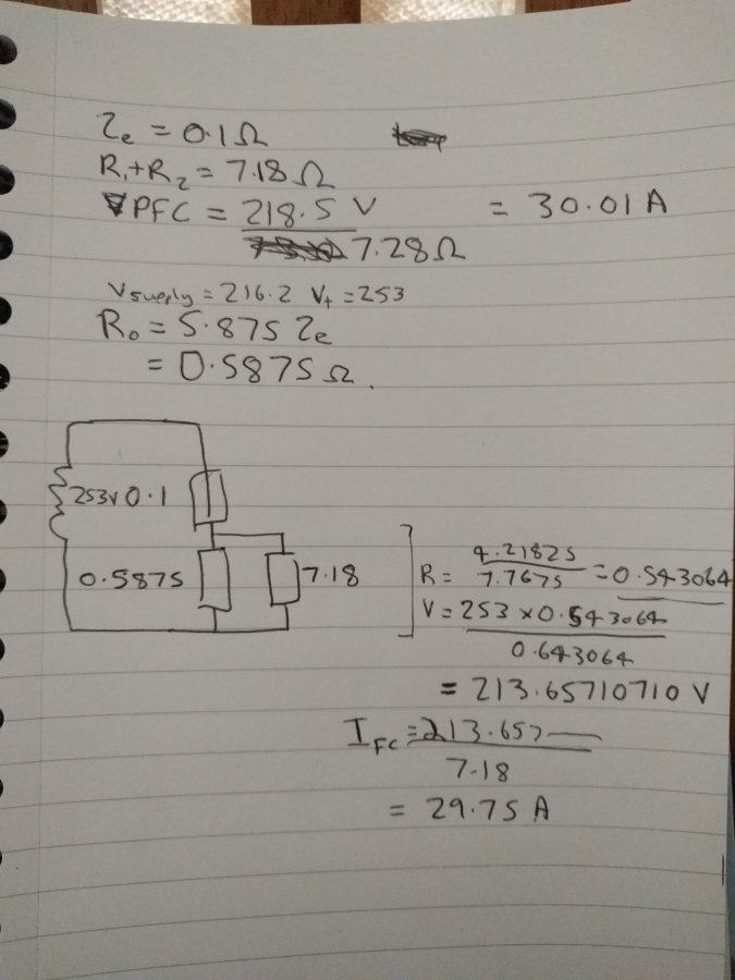

Yes I even checked manually
PFC 0.95 is 30.01ish and actually fault current at 0.94 is 29.75ish

Yep I can read it well, your Ir is identical to mine, but your If is a lot simpler. Also, I don't make any idea about who is wrong, I think we've all had our fair share of confusion, but confusion leads to understanding! Your haste was happening while I was asleep by the looks of your timings! I'll have another look and post back.

Thanks. As I said, I wouldn't be at all surprised if there is a mistake in there somewhere - as you observe, it was not only done in haste, but also 'in the middle of the night'! Let me know if/when you find my error!

Thanks. I can't fault your arithmetic.
I need to think. As you have no doubt realised, if you had calculated a "PFC 0.94", it would have been fractionally below the true fault current.

I have checked both your and my equations and I still can't find the fault. I also can't rearrange mine to get yours. I'm thinking of plotting them both just to prove they are different, although I'm pretty sure they are.

Oh ok I derived your forumla accidentally while checking mine. So I plotted both your If/Vt and my If/Vt and I found they're identical.
I managed to simplify mine to
If/Vt=(Ro^2+RoRf)/(ZeRo^2+2ZeRoRf+ZeRf^2+Ro^2Rf+RoRf^2)
Yours is
If/Vt=Ro/(RfRo+ZeRo+RfZe)
Then if I factor out (Ro+Rf) from the top and bottom of mine, I get the same as yours!

Something is wrong. Although (after my initial boob!) I agree with your manual calculation example, which gave the regs' method slightly over-estimating fault current (figures above), if one plugs those figures into my/your equation, one gets Ir/If=0.998 - i.e. with the regs method very slightly under-estimating actual fault current.

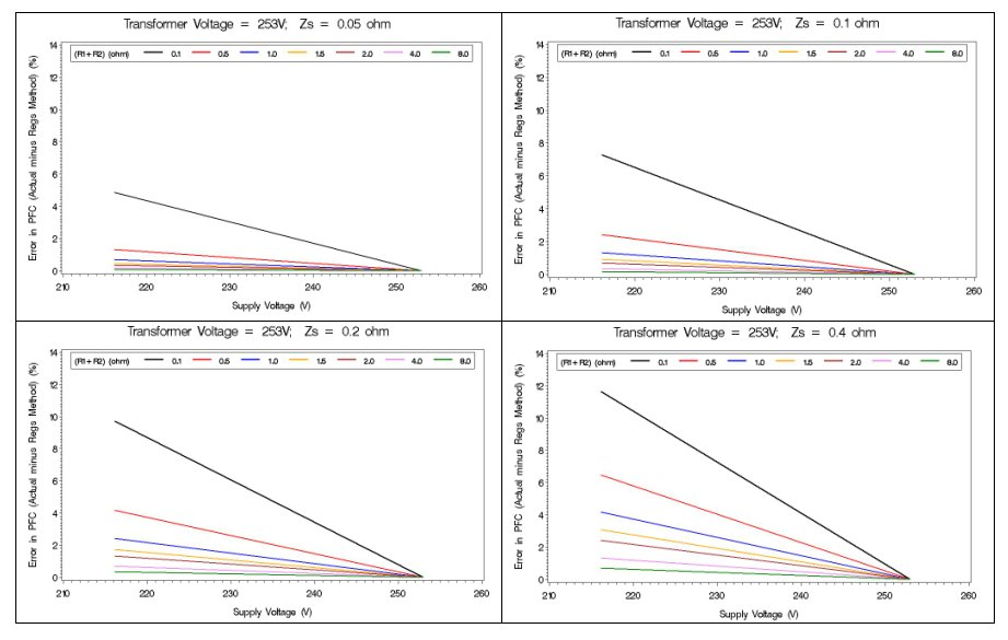

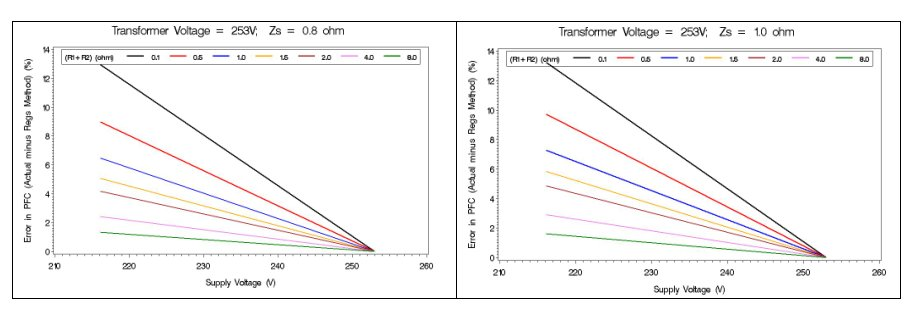

Having examined the behaviour of my/our equation (for Ir/If) over a wide range of situations, it seems consistent with my simulations in that it appears never to show the regs' method over-estimating fault current. I'm not sure how clearly the following will post, but they illustrate what my/our equation does (with 253V transformer voltage and 'supply voltages' from 216.2 - 253V); if there's a problem of clarity of the graphs, I'll try some other approach: Edit: NB please note a typo which I realised only after I'd posted these graphs "Zs=xx" in the title of each graph should read "Ze=":
Kind Regards, John

I think you may have 'led me astray' to some extent. What I sought to do was to 're-derive/produce your equation (for "Ir/If"), but you now make me realise that I based that on what you had done, which, in turn, was based on what is probably an inappropriate premise. Your equation started with the assertion that "Ir (regs) = V/(Ze+Ro)" (where V is the supply voltage of the premises), but that does not correspond (at least, not exactly) with the regs calculation, which would be (for Cmin=0.95) "Ir=218.5/Zs" - or, if you prefer, "Ir=218.5/(Re+Rf) - so the equation would seem to be of limited usefulness. Your 'manual confirmation' of your equation perhaps confused me even more because (although I didn't think of this at the time I re-derived the equation) you didn't actually ('manually') use your equation but, rather, used a 218.5V-based calculation!
