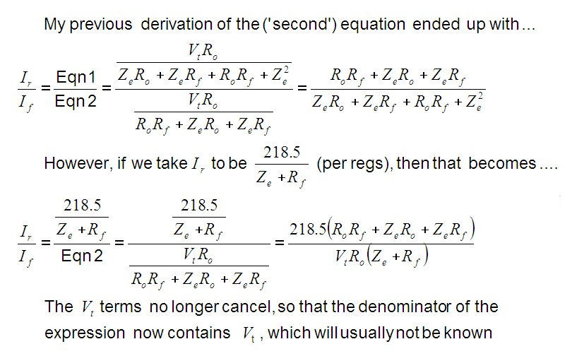

Returning to the 'second' equation, it's easy enough to modify that so that Ir really is the PFC determined per the regs' method, but that creates a practical problem ...
Since the transformer voltage (Vt) terms no longer cancel, we are stuck with a Vt term in the final expression, and we will not normally (if ever!) know the value of that. All one can do (and I will try) is to explore the effect of varying Vt, with Ro constrained to values which result in supply voltages between 216.2 and 253V. I suspect that that constraint will seriously limit the range of transformer voltages that can be sensibly considered (i.e. without invoking ridiculous load currents). There is also now going to be a practical issue in relation to presenting this graphically (without having dozens of graphs), since we now have 5 variables to consider (Vt, Vs, Ze, Rf and 'error') - it was bad enough with the 4 variables I presented graphically yesterday, so I need to think how best to do this! Watch this space.

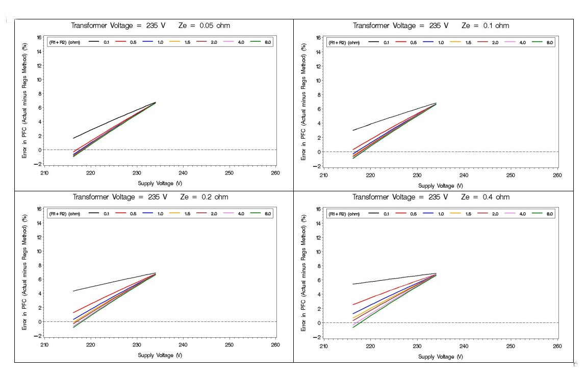

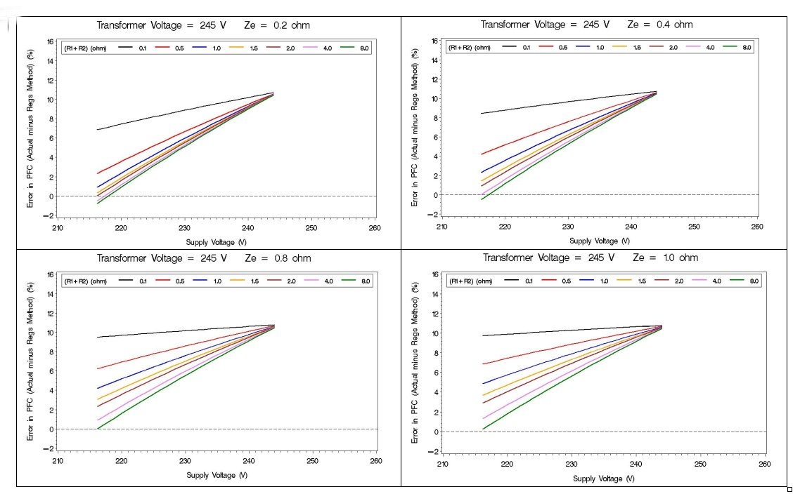

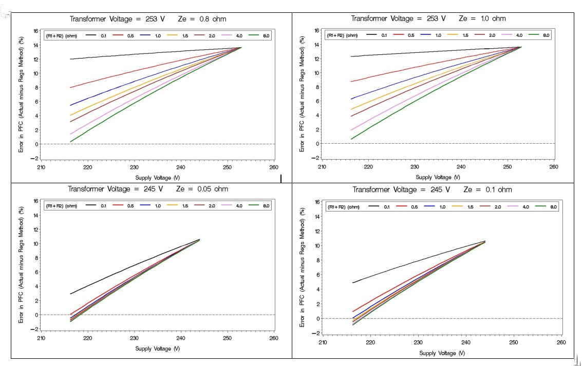

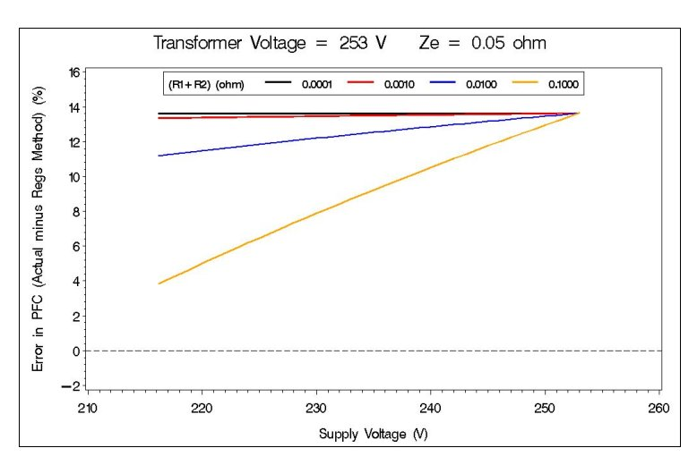

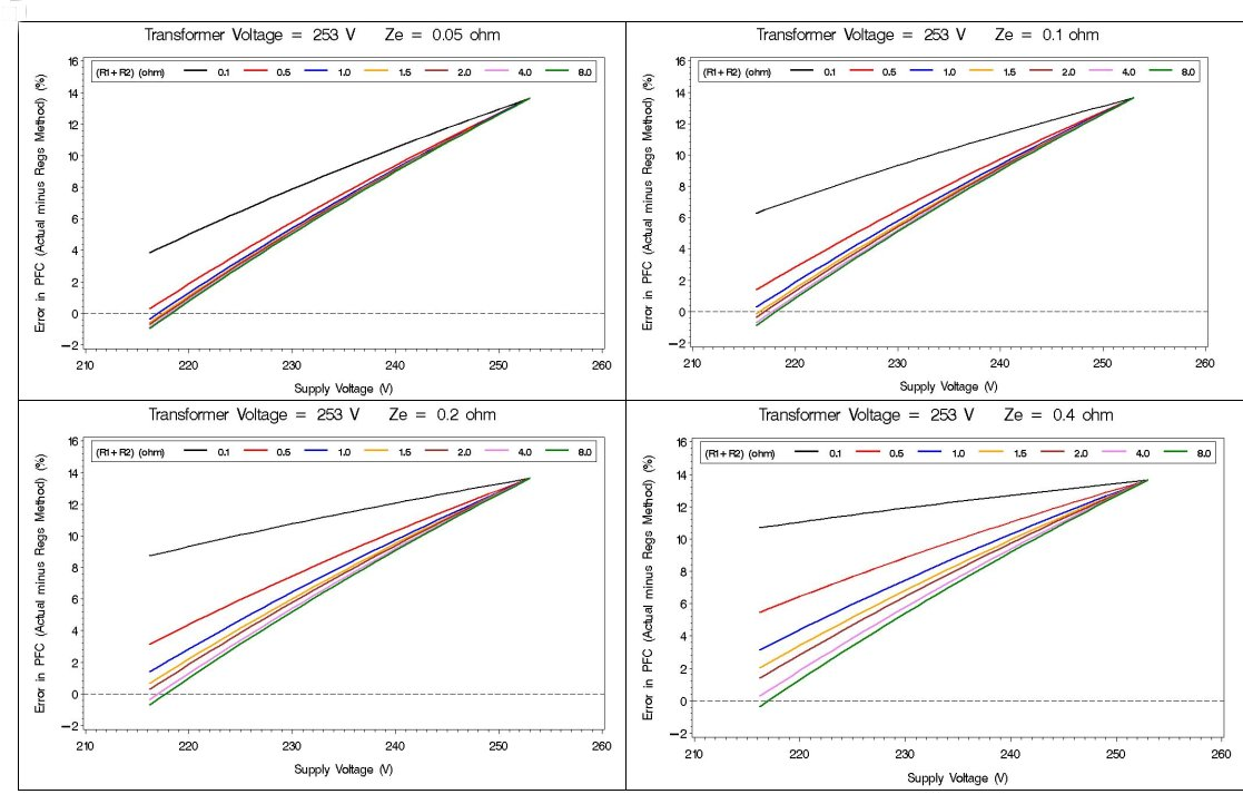

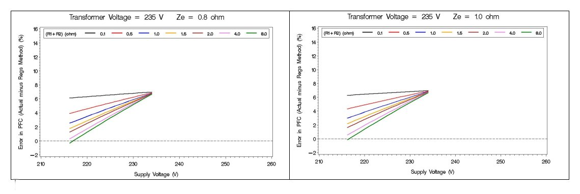

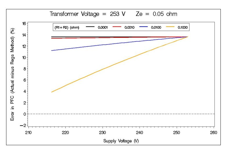

OK. What I've done with these 5 variables is to produce one set of six plots (for a range of Ze values) for each of three transformer voltages - 253V (which, as above, is probably not far short of the highest voltage they would often 'dare' to use), 245V and 235V (probably the lowest likely). I could obviously produce sets of plots for any other transformer voltages that you wanted, but I think what I have done is probably adequate, and basically confirms the 'conclusions' you gave in msg #99.
The 'error' plotted in all of these graphs is that between the actual/true fault current and that using the actual regs' method (i.e. 218.5/Zs) - and, as you said, usually represents an under-estimate (up to about 13%) by the regs' method, but (under fairly 'extreme' circumstances) just occasionally an over-estimate (but never more than 1%, if that):

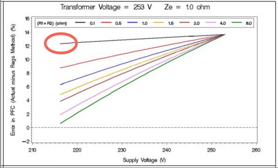

Looks great! (y) Excellent graphs.
And just a note that the reason yours "only" goes to 13% is because you didn't go as extreme as you could have. In the graphs worst oversizing (at the min permissible voltage of 0.94x) at Vt=253V is 12% ish
however I pushed Rf to zero and got an Ir/If of 0.8545454545 which I think is about 17%. Interestingly, it only depends on the ratio of supply voltage to transformer voltage, and not dependent on the Ze at all.

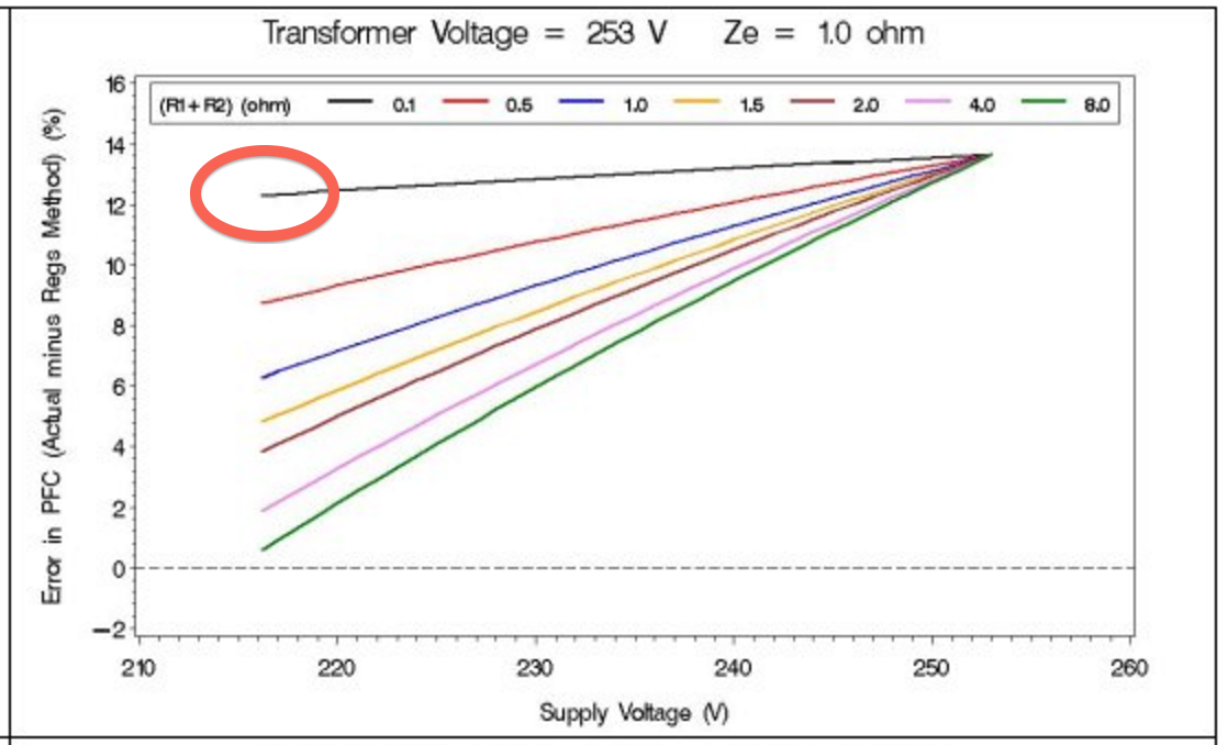

I'm not sure what sort of 'extreme' you're talking about - are you merely commenting on the fact that I didn't look at values of Rf (i.e. R1+R2) less than 0.1Ω ? If so, I though that reasonable as the lowest probable R1+R2 of any real-world circuit, but I could obvioulsy go lower if you really wanted!
As above, I stopped at 0.1Ω, since that seemed a reasonable lower limit of real-world R1+R2.

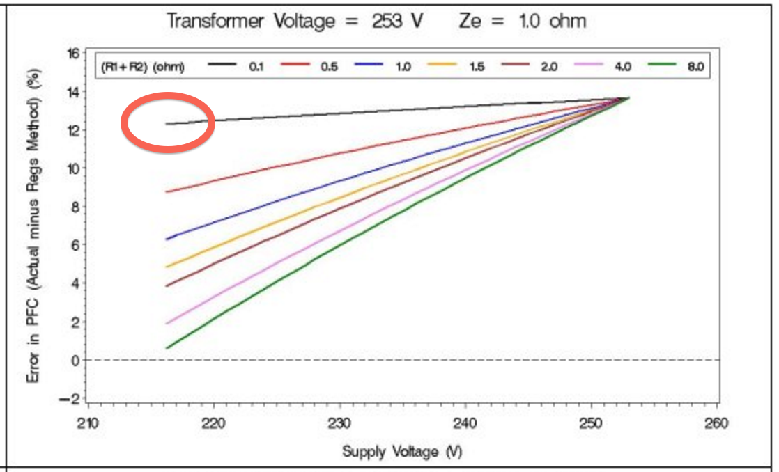

What value of Vt did you use for that? With Vt=253 and Ze=0.05, I don't seem to be getting errors even as high as 14%, even if I use ridiculously small values for Rf (i.e. R1+R2). Does that mean that something is wrong with my plots?:

No I get the same as you for those values put into my spreadsheet, although I make 0.873 about 14.5%*, see the third row below. Try Vt 253 and Ze whatever you like if Rf is zero, as long as the ratio of Ze to Ro gives a supply voltage of 0.94:
*I'm describing in terms of how much percent bigger (or smaller) the cables would be than necessary so really it would be If/Ir

Well, I haven't used 216.2V at all, other than as the value below which I truncated my plots (my actual calculations went down to incredibly low supply voltages, but I only plotted those which were in the 'permitted range').
Well, that's pretty similar (but not identical) to what I'm getting, if you look at 216.2V on the last graph I posted (i.e. the truncated left-hand end of the line plotted for Rf=0.0001Ω), you'll see that the error is just slightly below 14%.
