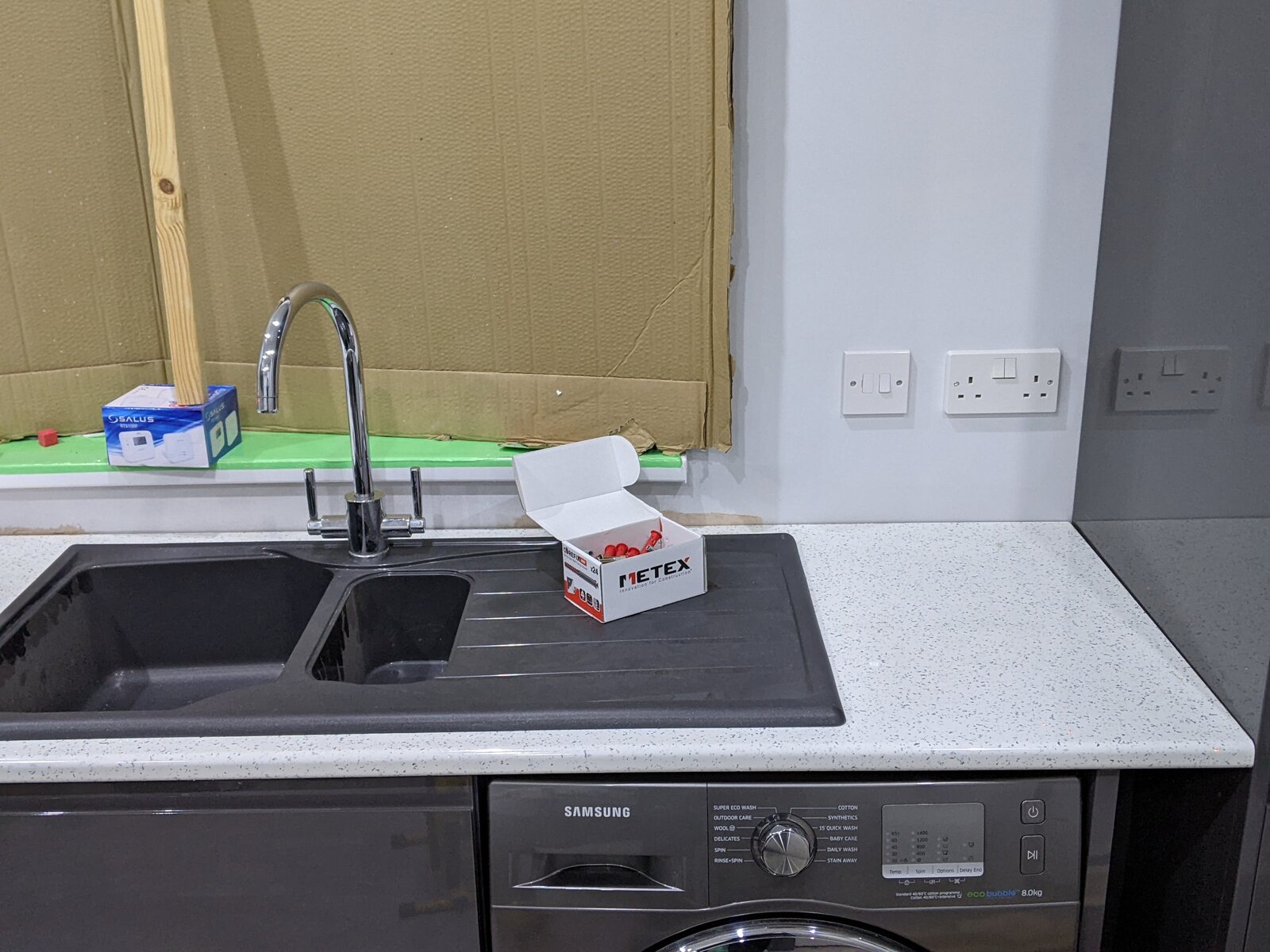

Hi all,
Had a new sink fitted, kept the tap in the same place but now have the draining board on the right hand side.
The socket and fused switch are horizontally less than 30cm from edge of draining board. I assume it's now against regulations? If so, can the fused switch comply with regulations by being mounted 25cm to the right of draining board edge and up the wall near the ceiling? Is there a minimum height in this scenario or does only the 30cm horizontal rule apply?
Alternatively, can the fused switch be mounted under the worktop, on the wall at the back of the open cupboard and still comply with regulations?

I believe there are no regs for the distance, and the 30cm minimum is 'advisory'
Though it would probably be best to stick to the advisory distance, if you were letting the house.
Edit: the advisory comes from building regs, general guidance - and what do they know about electrickery! ;)

Nope. No mention of such a distance from sinks in the regulations and certainly no mention of draining boards.
The FCU is more than 30cm. from the sink anyway.
It's fine as it is.
There is no such regulation and even if there were the regs are not statutory.
What is the FCU for? If it is for that washing machine you don’t need it as the WM plug will have a fuse.

There's no problem having an FCU though, is there?
For all we know, there could be another socket spurred off the washing machine socket.
Or a flex outlet has been used for the washing machine.
It's not a problem at all how it is, so why even mention it?
It's for a single socket behind the built-in fridge (to the right). I guess the same applies since the fridge also has a plug. Would you have fitted a non-fused double-pole switch instead?
