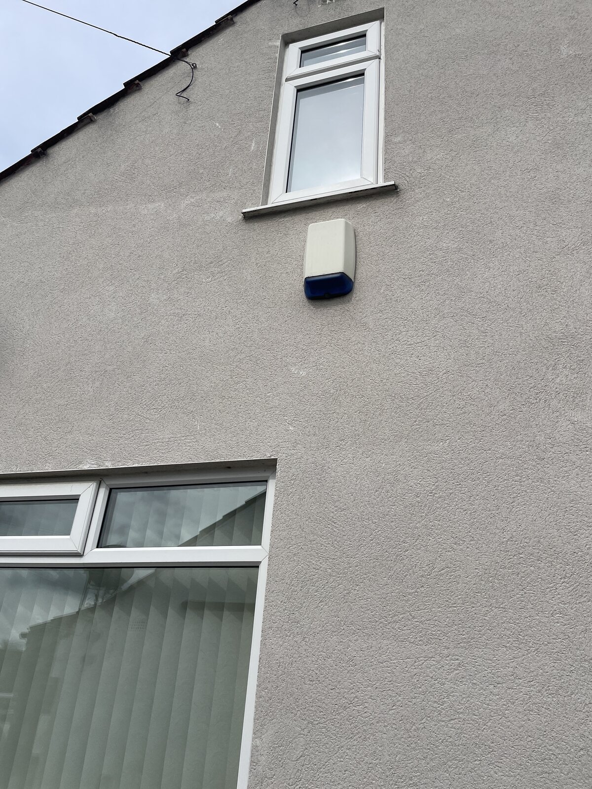

Sorry I tried to send a photo,it is lower than it used to be, I can just about hear it when I stand under it

Replace Bell box ,is your best option. Most bell boxes will connect to your existing control panel.
Take photos of control panel wiring and existing bell box wiring before you replace unit.

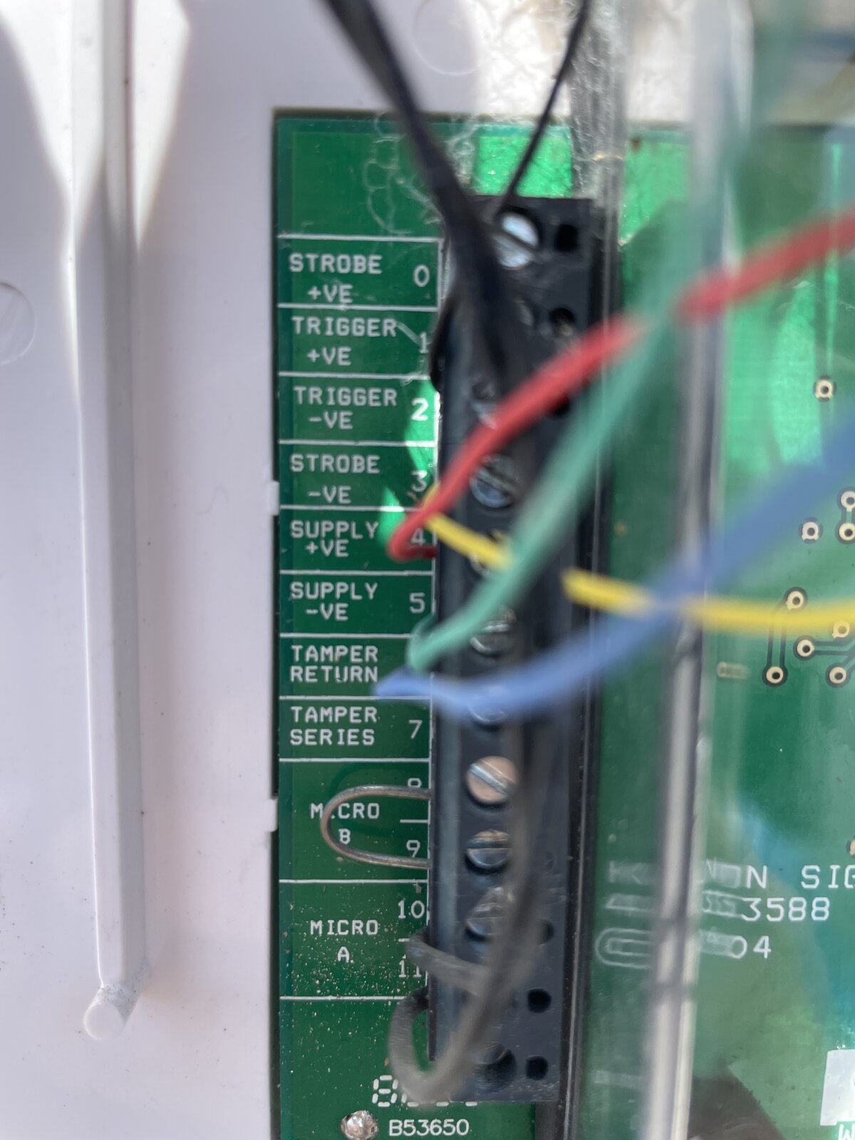

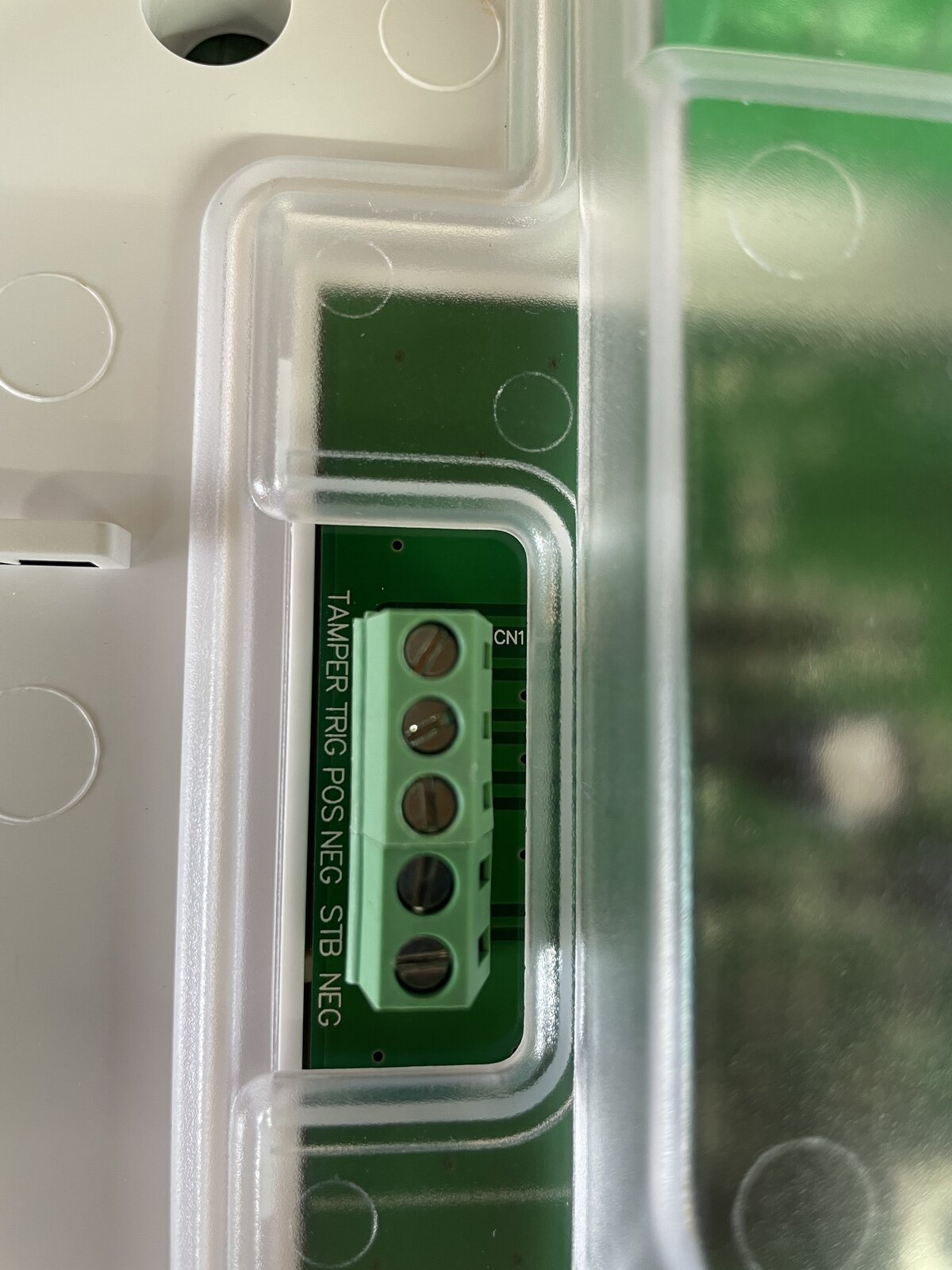

Hi
This bell box states it’s compatible with g4, it does not have the micro terminals like the old one, what do I need to do with these? Also there is a white wire in my old box not connected?
