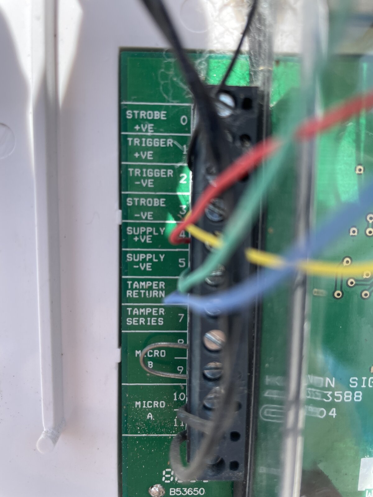

G4 accents optima quite siren
Supply + red = pos
Supply - green =neg
Tamper return blue =tamper
Trigger - black = trig
Strobe- yellow =stb

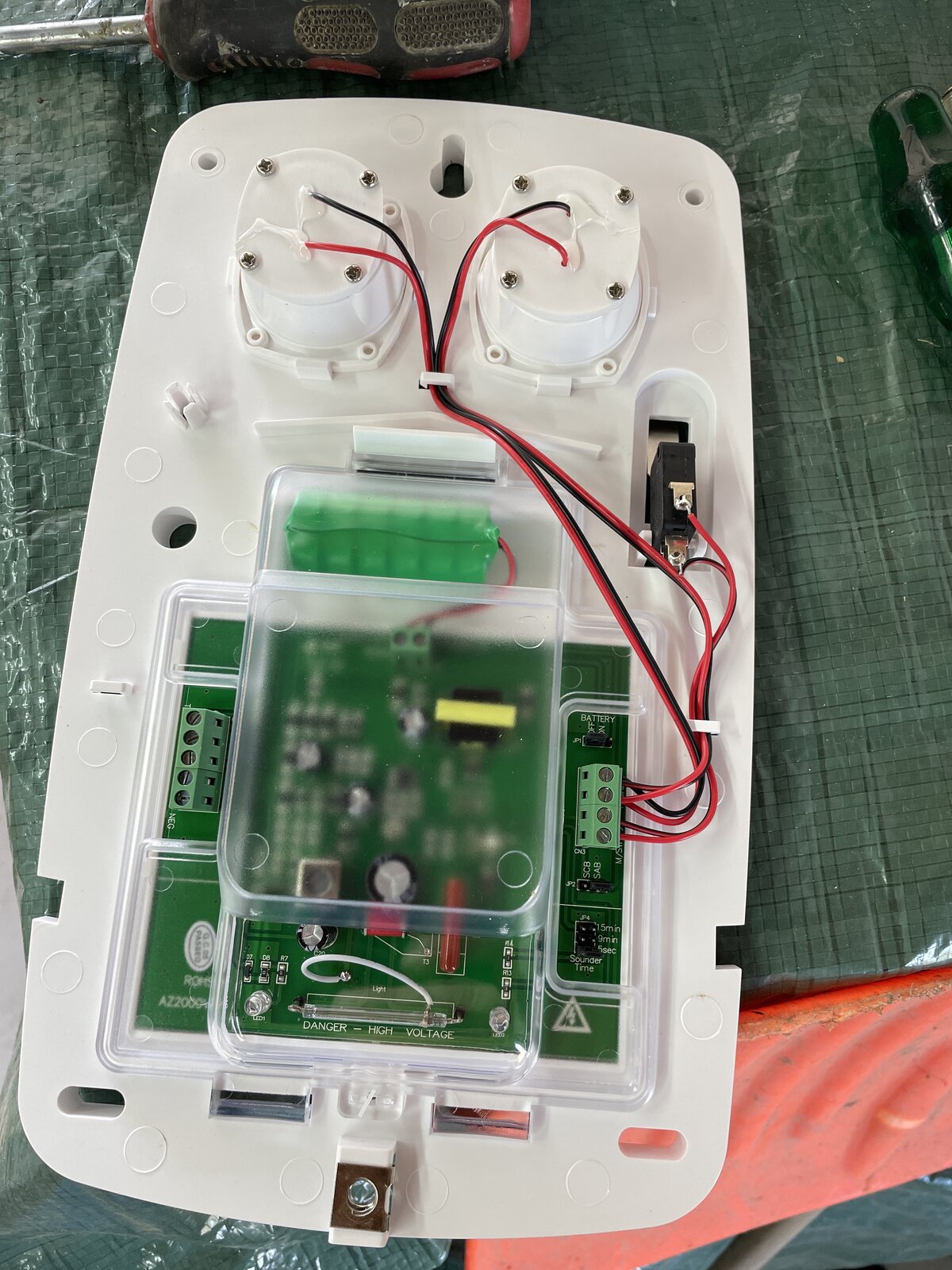

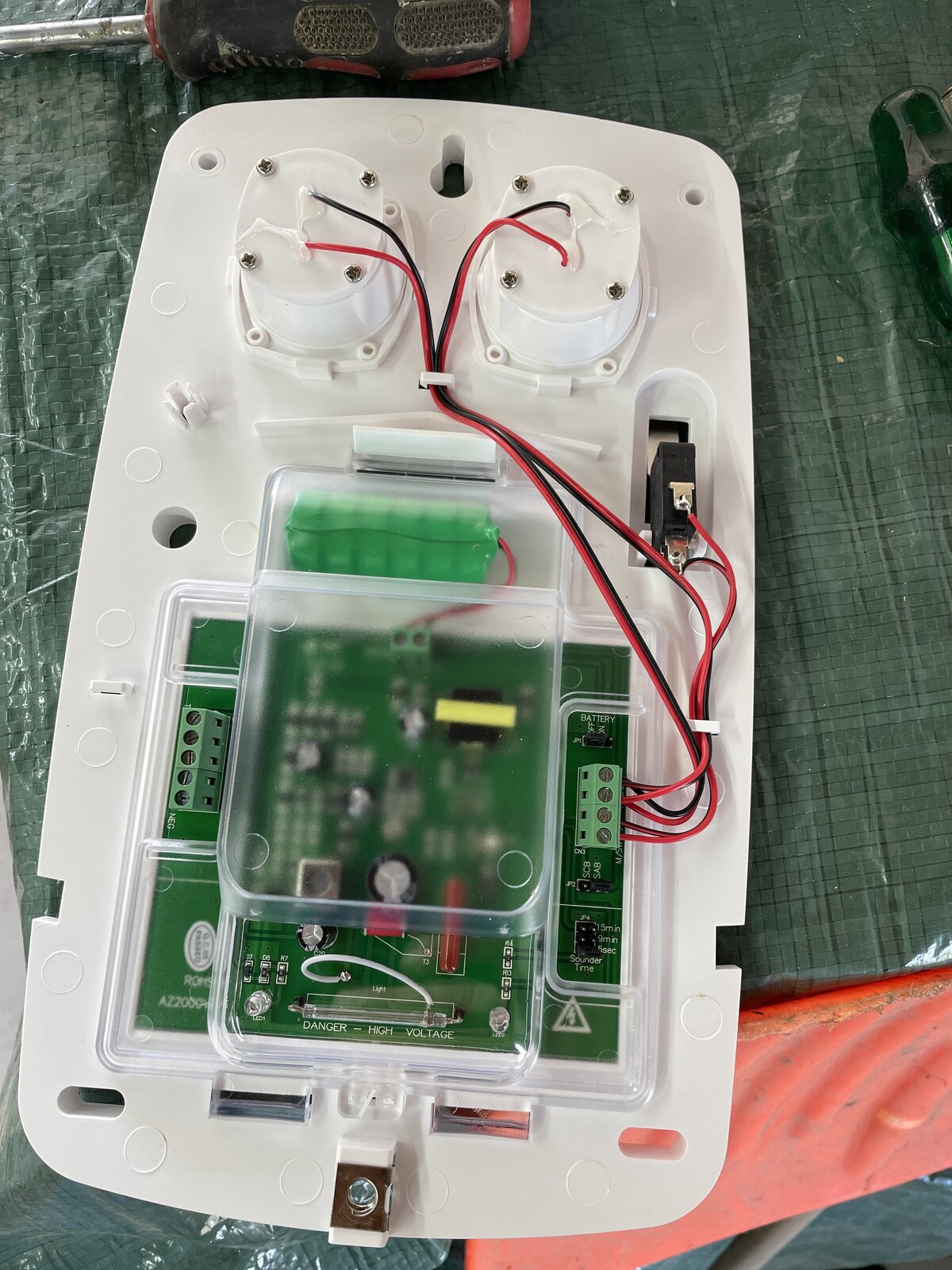

What make of bell box is your new one, any installation sheet regarding any jumper on new bell box.

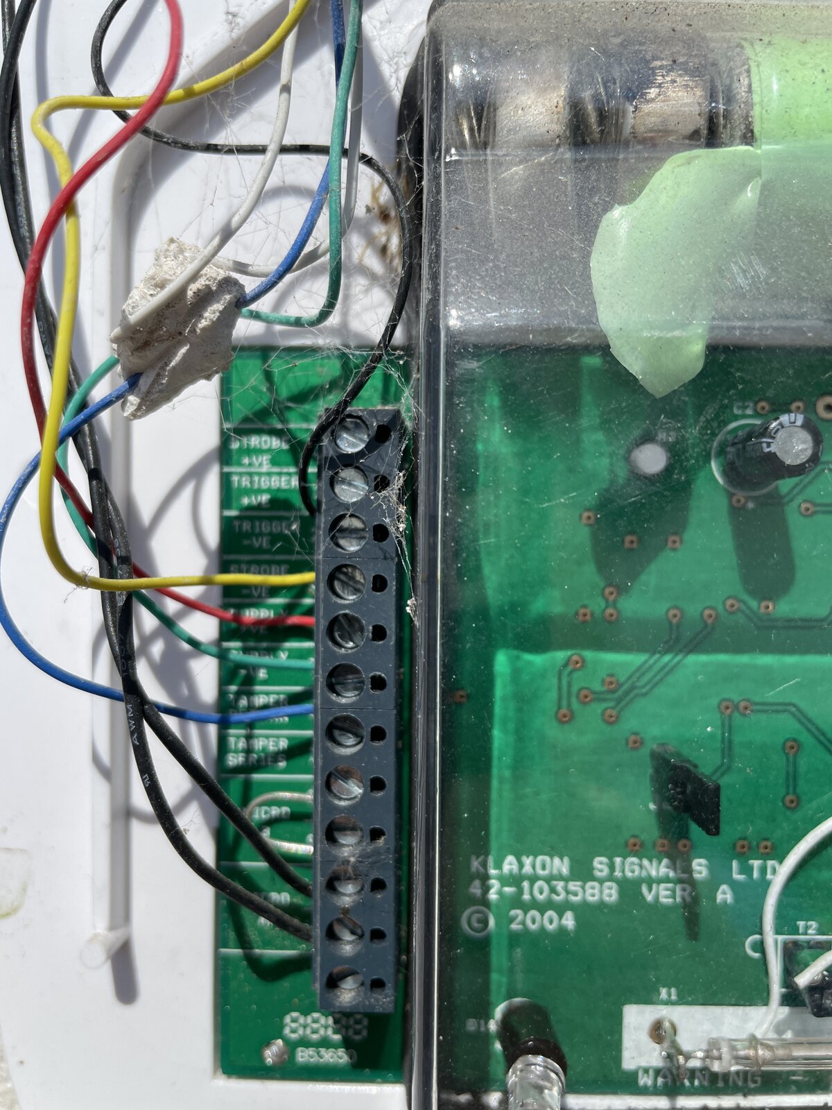

White wire may not be used.
Have you taken photo of wiring inside control panel ?
Hi
It’s a kinetic az-tech

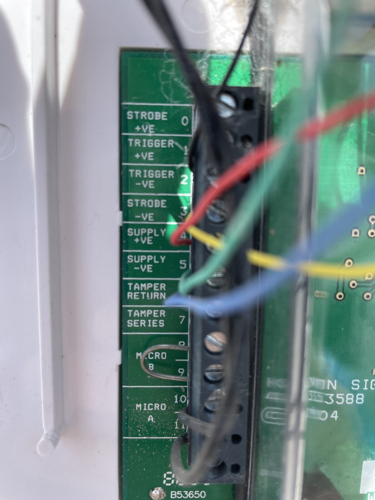

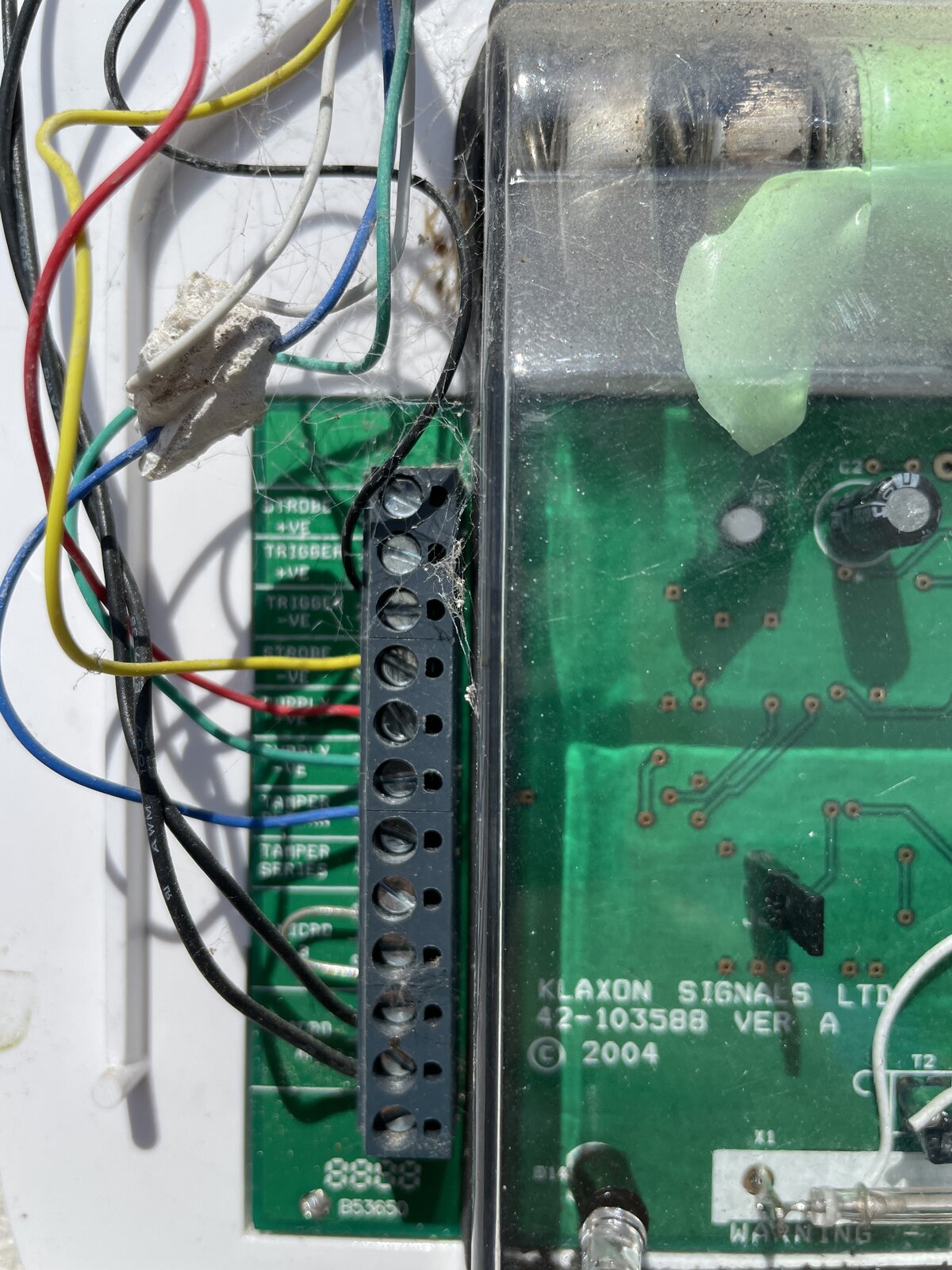

old box wiring attached Thereis a micro jumped and two black wires in the bottom two micro terminals

Once connected you will need to move battery Jumper to on and move the timer Jumper to 15 min
Wire as pervious.
Please hit Thanks once sorted.
Thanks for that , what do I do with the two blacks at the bottom in micro B terminals, it already has a black wire at the top?
regards
Peter
Hi
I have had another look and the black wires go to the tamper switch and on the new panel they are on the other side of the panel
thanks for your help
Are they connected to the microswitch?
Need better photo of whole bell box to see what they are connected to.
