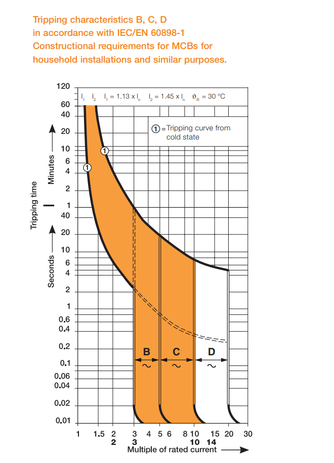

I'm sure your maths is on point but to me it's got nothing to do with a dead short situation, otherwise it wouldn't have only been required for special locations e.g. wet places. There won't be much difference in disconnection time between rcds/mcbs at fault currents.

I'm sure your maths is on point but to me it's got nothing to do with a dead short situation, ...
.... but the "dead short (between L & CPC or L & exposed-c-p) situation" was precisely what my maths was addressing. If the fault had more than 'negligible' impedance, then the touch voltage (prior to clearing of the fault) would be a bit lower than I suggested - but probably still dangerously high ...
